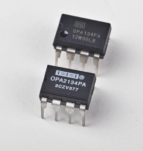

Did anyone take a brief look at the OPA134 from the GB?
The lower one is a OPA2134 which is for sure genuine (TI sample), the upper one is from the GB. To me, this looks rather suspicious as the BB logo isn't even close to what it should be.

Okay, perhaps they're fine. Time will tell.
mine (that I used in Paradise R1) look like the upper part, and are genuinge parts (I think I bought them at Farnell). Work like a charm - not that I listen much to R1 these days ;-)
