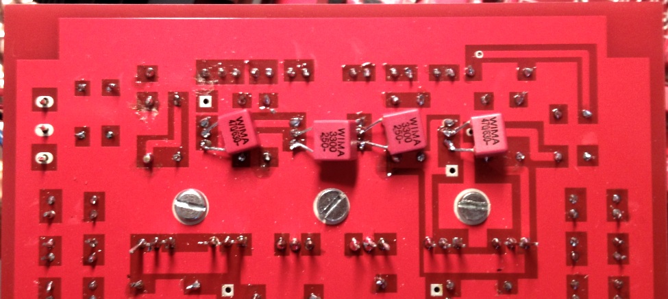

PSU compensation caps
Hi all,
here a picture of how the compensation caps in the PSU can be applied, you need to locate the transistors under the heatsinks (the footpritns with the three connections), and solder the caps between the innermost and the middle pin. The transistors closer to the corners should get 470pF, the inner transistors 2.7nF.
On the picture you will see 3.3nF caps - before you ask , that is simply because I had them on hand 😀
Many thanks to Doppelkopf who kindly lent me his boards so I could play with them..... After the PSU fix (yes they were oscillating) they sounded nice, with the groove JG/MiiB house courve....

sorry, forgot to take that scope shot. But the output voltage was fluctuating +/-100mV with frequencies below 1Hz, and when I blew on the input stage transistors the voltage was moving quite a bit.... On my well-run-in Paradise those fluctuations were much smaller.

In the beginning, I get PSU oscillating, add 4.7nF and 3.3nf compensation caps to solve it; then I have offset issue, the offset was fluctuating +/-200mV.
First, I used the 500R to trimming R15 but nothing change, after I reduce R43a/R43b to 9.1K then the offset was stable in between +/-20mV (change to 3.9K could down to +/-5mV)
