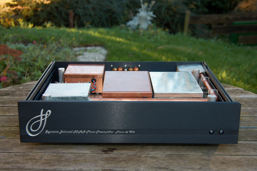

Beautiful build you got there, you are probably the high-scorer in Paradise building .... Is that LCR caps in the RIAA?

Fabulous build Si. Do those Calvin buffer heatsink ever become warm?
My heatsinks doesn´t get warm...

The buffer heatsinks are overdimensioned in the original design, and even bigger in SQ's design, pretty sure they don't get hot.

21 so far Alfred. Lots of happy friends and acquaintances.
That pic is slightly out of date, it's now just LCR styrene caps in the RIAA, no wimas to pad out the pF. Took a while to get a perfect match. Rushonline in the UK has them.
Garf, no they never get warm, the main heatsink gets warm, but not too hot, and that's with the 8.2ohm in the shunt to get the last 30mA for the Calvin boards.
