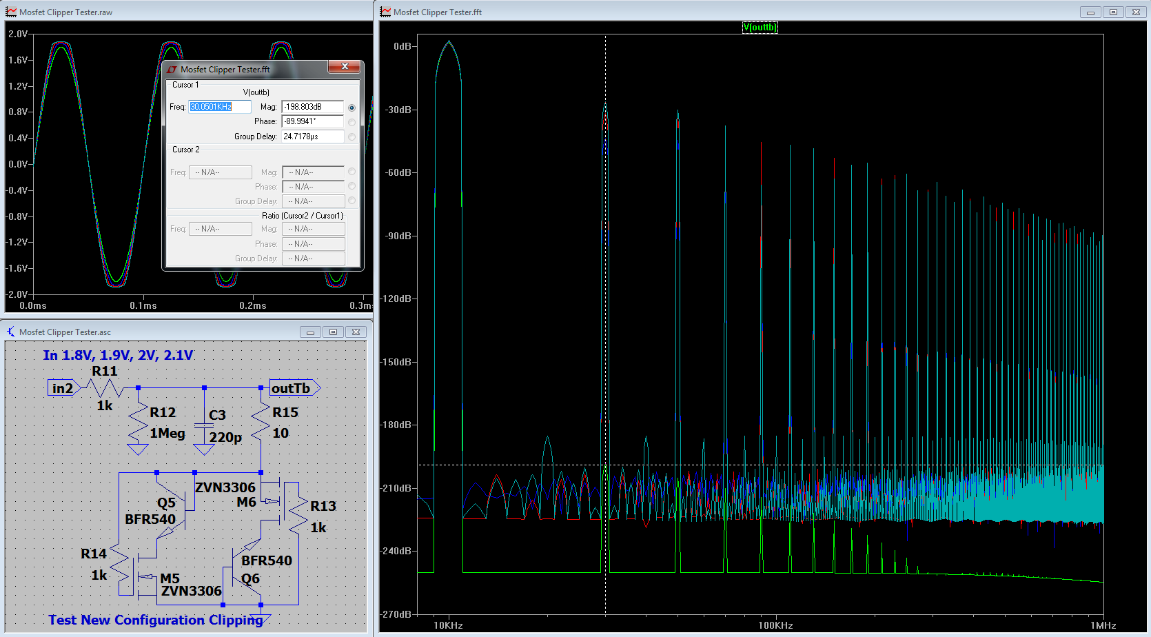

Maybe we dropped the 'Mosfet-Clipper' idea a bit to fast, after giving it a bit more time I have this:
In 1.8V THD -190dB 🙂) yes I know it is simulation)
In 1.9V... and more volts it is limiting to below 1.9V
When limiting, all even harmonics, the odd harmonics are always below -180dB (yes, yes... I know 🙂)
