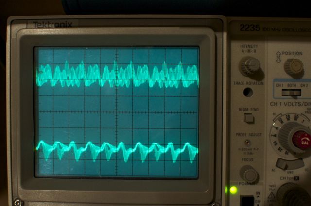

Boy am I slow… Finally got around to do this, on both boards, and they still oscillate. The photo below shows the oscillations, at 0.1 V per division.I populated my R3 boards a while back, with the 330 ohms. Will try to reduce them to 120 ohms and report back if this stops the oscillations... Thank you Alfred!
B.t.w. I am testing without any load. Am I correct in assuming these should be stable without load?
One one of the board, I have changed every transistor except the two MOSFETs.
