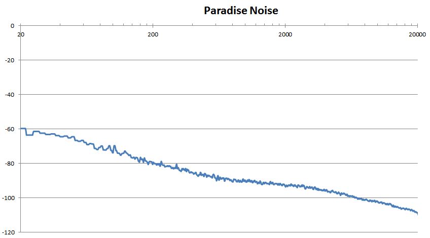

I think I have a better setup now. I found that the Clio noise level measured depends on the input attenuator setting. If I lower the input I got this noise floor from the Paradise. No more 60Hz spike, and nice RIAA curve can be seen. I've been listening to the Paradise with the OPA627 now, and there is no noise at all. It is a very silent preamp. Excellent 😀
