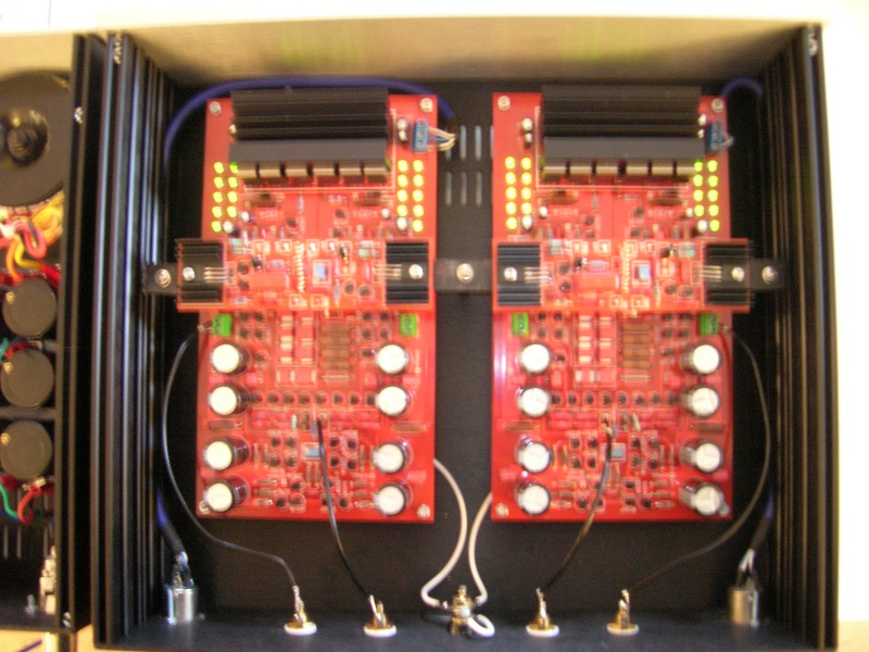

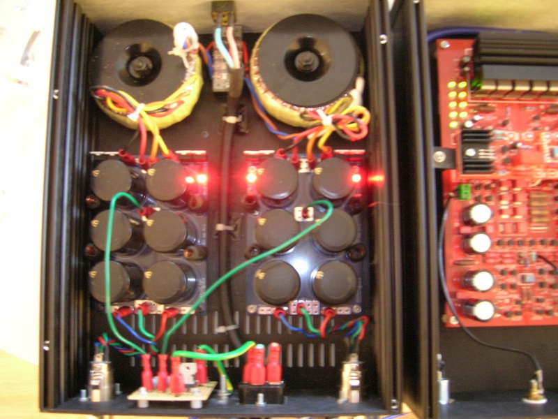

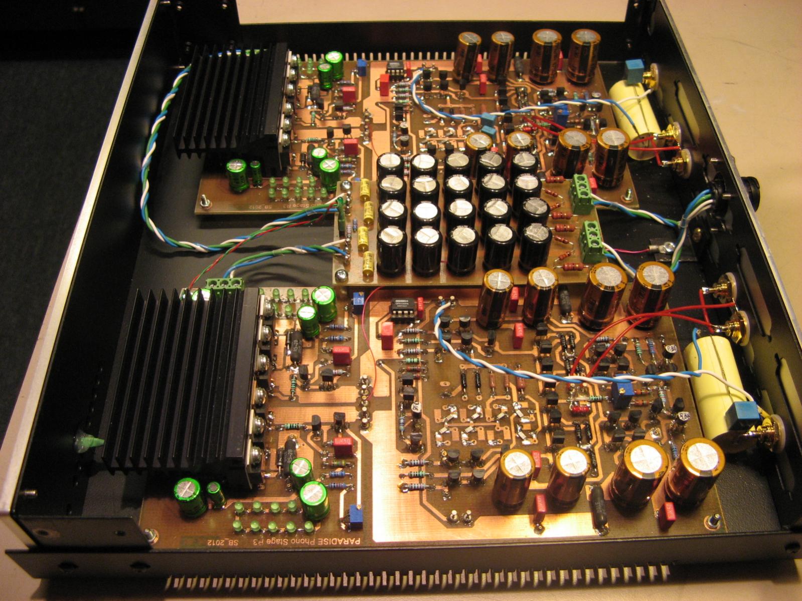

A quick build update.
I fired up the Paradise/Calvin boards today and very roughly set the IP offset with a 10K load and well I never. No magic smoke released but a large +/-125MV offset on both boards.
The Calvin adjusts down to 0V between IP and OP so looking good voltage wise.
Ok I remember Paulski’s remarks re boxing and flipped the lid on and let it warm up for 15mins or so.
The OP offset dropped like a stone with the lid on so worth keeping in mind when you first measure.
I now have a more manageable +/- 7mv on both boards OP but I’d like it a little lower.
So I think I’ll be trying to thermocouple the front end transistors to see if that helps.
The 7mv seems to be OK but every little helps.
some not very good pictures of my build so far
Looks good, and it looks like you did the grounding as I talked about in my huge ramblings...... Would be interested to know if you hear any hum!

@shoom;looking forward to your listening impressions.If its hum free I'd be interested as to how you wired as I still have some residual hum with mine which I am struggling to eliminate.
Great build
alfred
Hi Alfred
Yes read that really useful post and used along with Frans Diagram helped me find a place to start. I’ve seem others use different approaches to grounding but left myself room to change easily if I need to.
TBH I have high hopes for the DDRC.😉
I’m also hoping that Thermo coupling the front end will reduce DC offset still further but I’ll know that tomorrow.
I’ll let you know on the Hummmm once I’ve plugged in. I’ve used a similar scheme before and it worked well so fingers crossed.

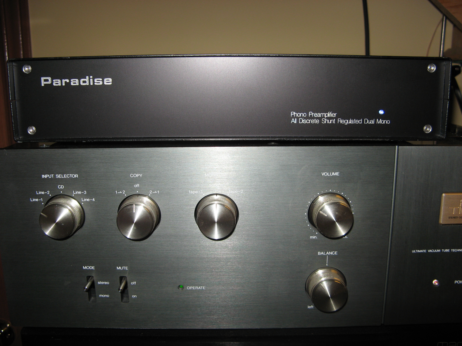

My Paradise Built

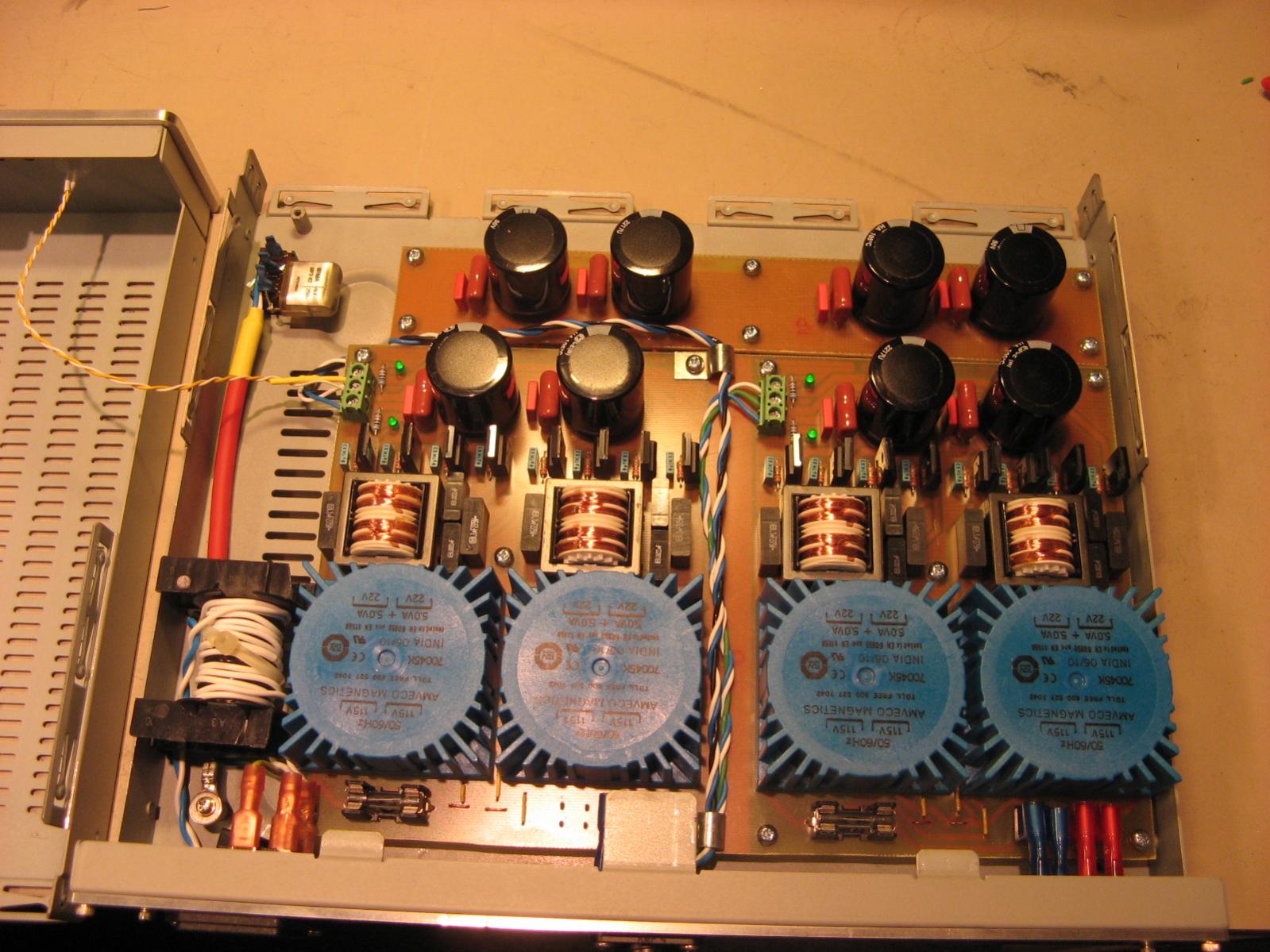

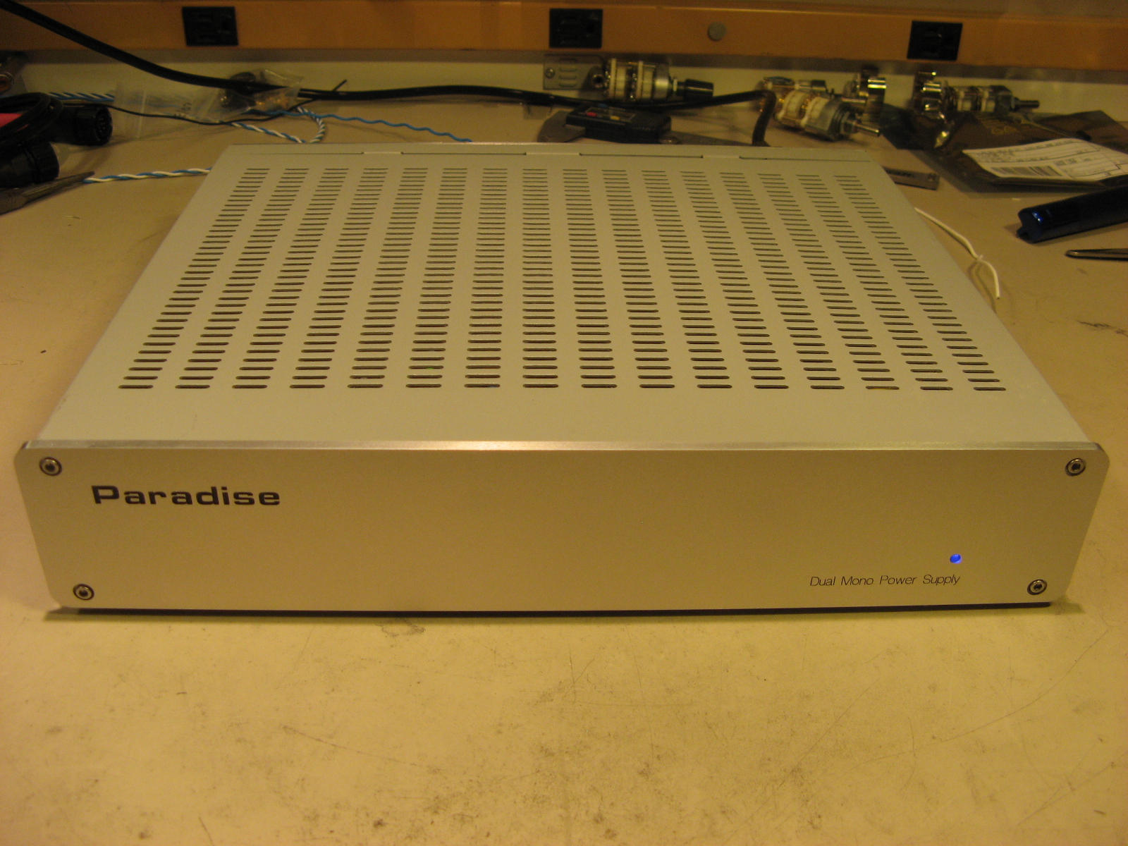

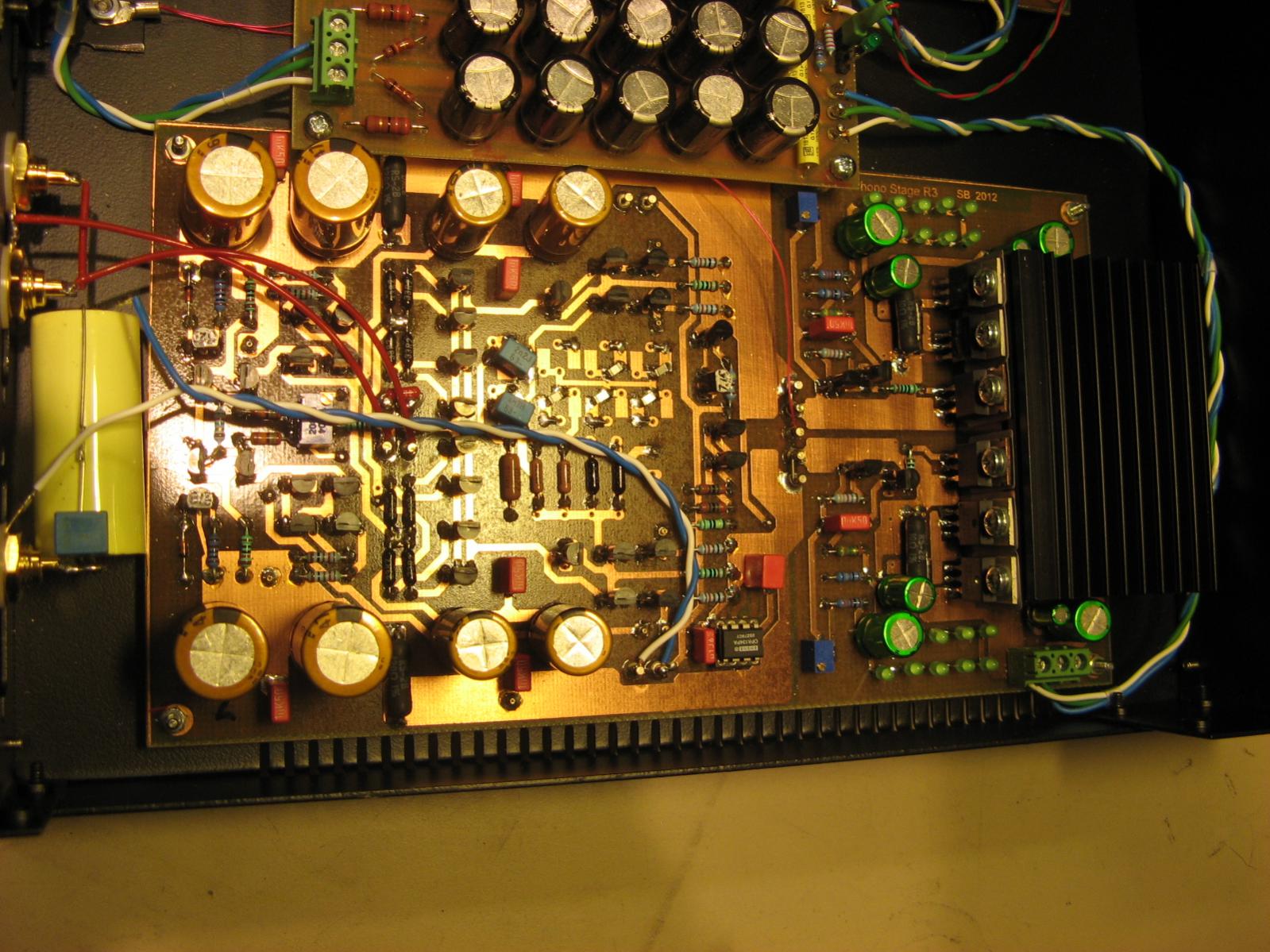

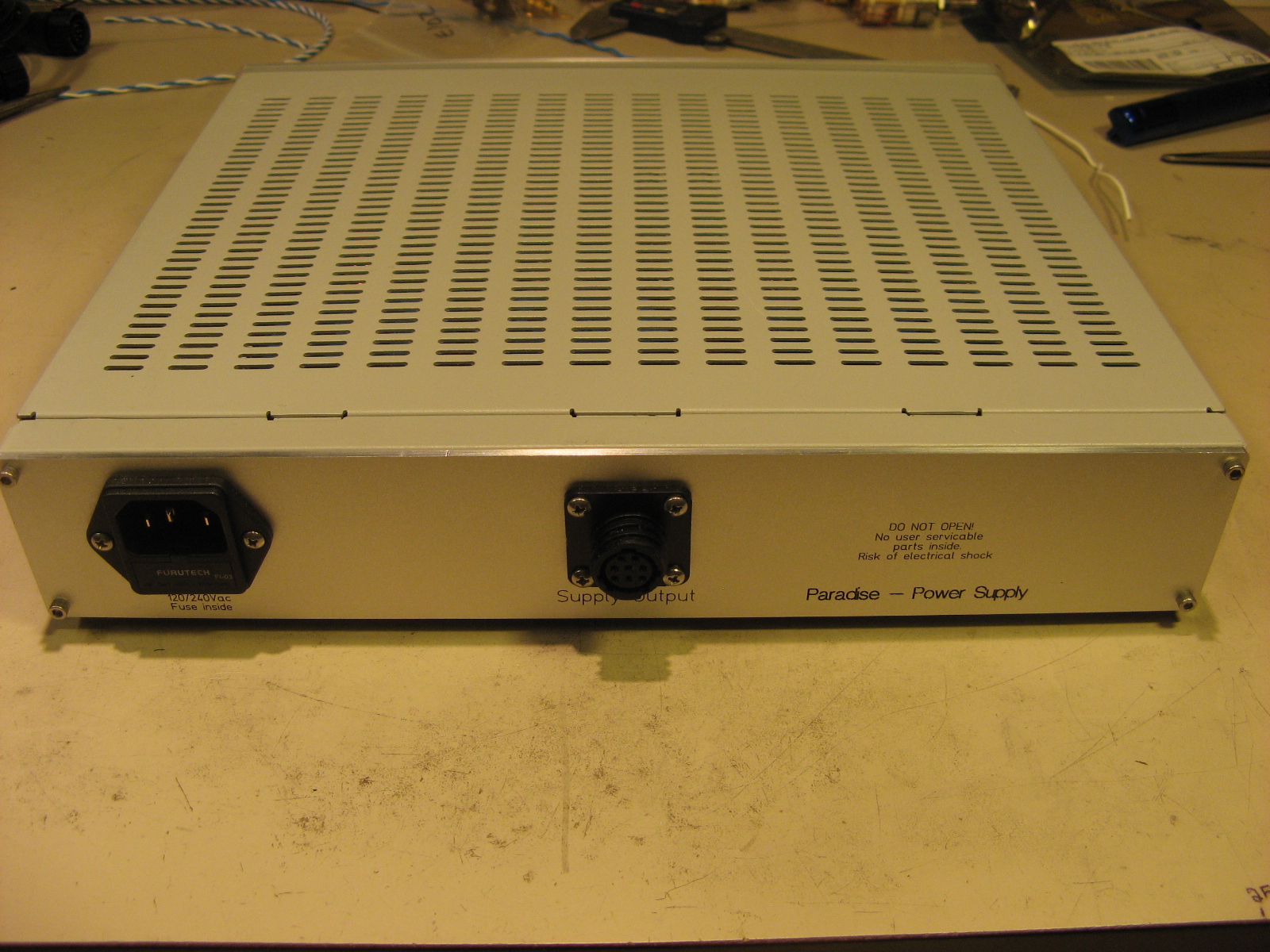

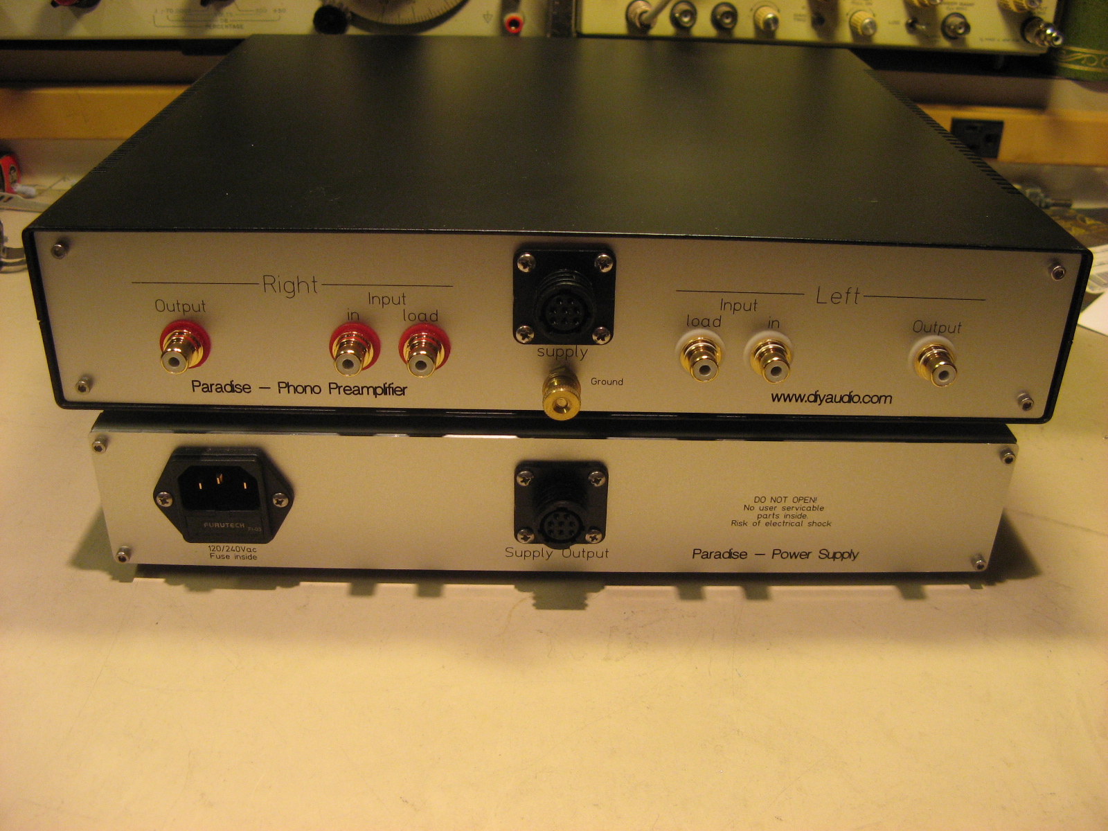

Here a few pictures of my own Paradise I just completed. The PCB were done months ago, but I was waiting for the proper enclosure. I found two nice metal cases that I reused and I designed custom front and back panels from Front Panel Express. The preamp is black, the pre-reg is silver. Here we go with the pre-regs, dual mono naturally 😉

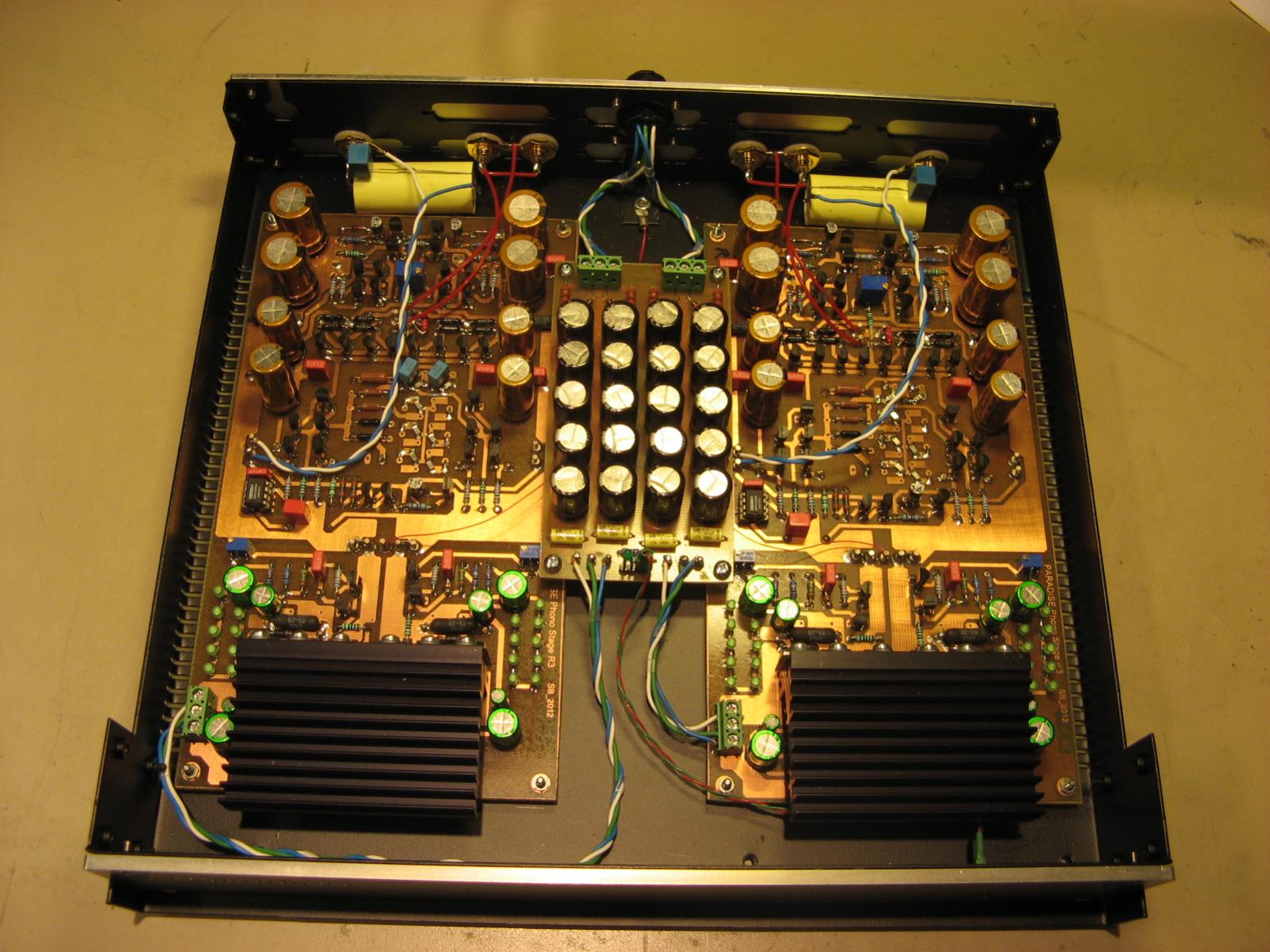

As you can see I did my own PCB. The preamp now. I included a 'Load' socket for each input RCA to use a selectable cartridge load. The preamp has a 47K resistor installed inside by default.

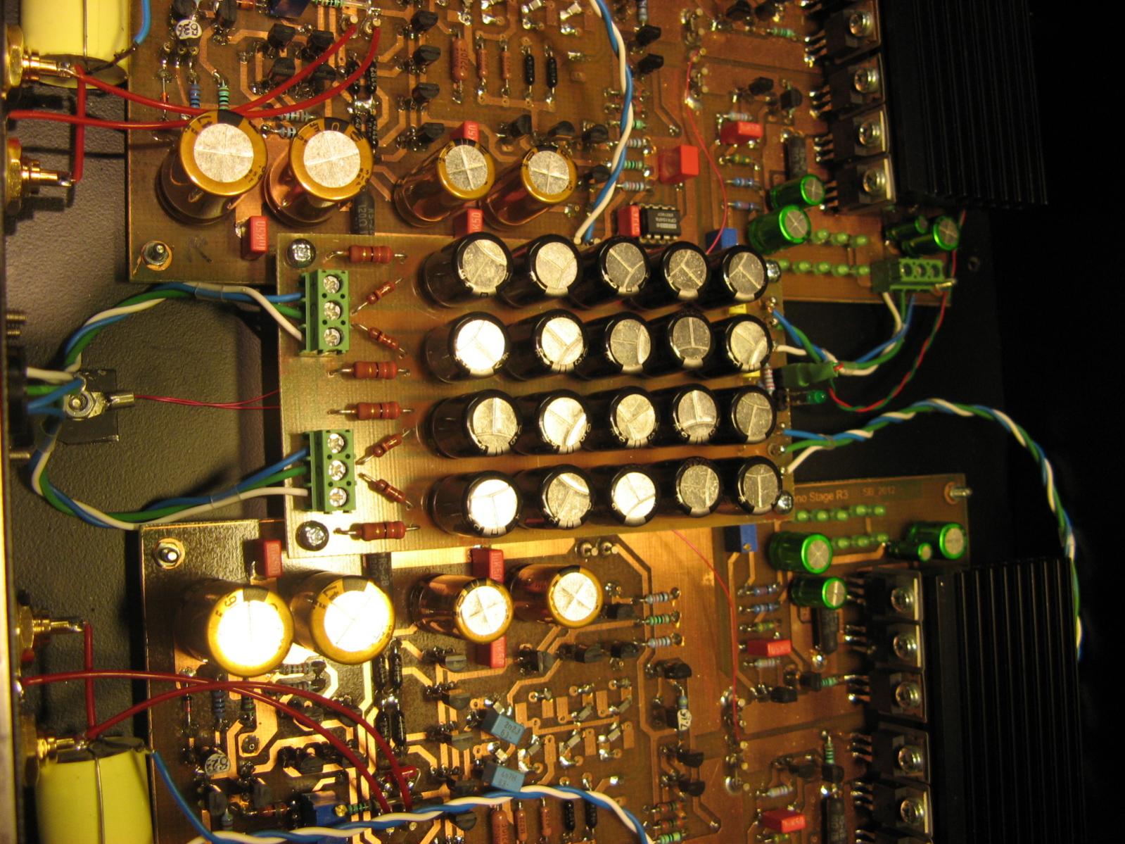

Because my pre-reg supply voltage was a little on the high side, and that the preamp shunt regs were cooking at 50C, I installed a central CRC filter to lower the supply voltage and the noise at the same time. I did it using spare parts I had in stock, nothing fancy. The input voltage drops from 28.2Vdc (ripple 37mv) to 25.4Vdc (ripple 1.8mv) before the shunt reg adjusted at 18V on the preamp PCB. Noise is then lower than 1mv on my DVM. Not bad. I included a clos-up of my preamp PCB.
Great work Algar
Your boards look fantastic as does the build.
Looks like you are cap coupling the output?

I can see that the Paradise progress since the last time I took a look. Do you where the thermal coupling is mentionned in the thread, as well as the new grounding scheme? I want to implement it into mine for sure.
The coupling caps are a temporary measure to let me test the preamp for a while. The little DC offset worry me a little on some of my amps.
I hope to reach such low DC offset as a few mv, but for now it is rather around 20-30mv. This is why I'm so interested in the latest improvement.
