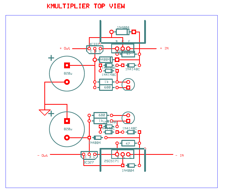

Just finished implementing Keantoken's kmultiplier in my paradise psu.
I have:
Rectifier bridge + 470u cap + kmultiplier + 15000u cap feeding the paradise shunts.
Previously I had a crc setup... now I notice a substantial reduction in noise floor, (no hum present) and also I benefit from a 2 second turn on time.
I was afraid the extra electronics between the rectifiers and the smoothing cap would somehow "kill" the dynamics, but I am now sure it does not.
The lower noise brings benefits in terms of definition, high frq extension and detail.
This is a MAJOR upgrade that can easily be implemented in this case.
I want to thank Keantoken for his unconditional help that helped me to overcome initial design issues.
Here you can see the p2p layout I am now using.

Havent you swiched the in and out in the layout?Here you can see the p2p layout I am now using.
At first glanse i missed a connection so that it looked like the load was on the small trannie, sorry
