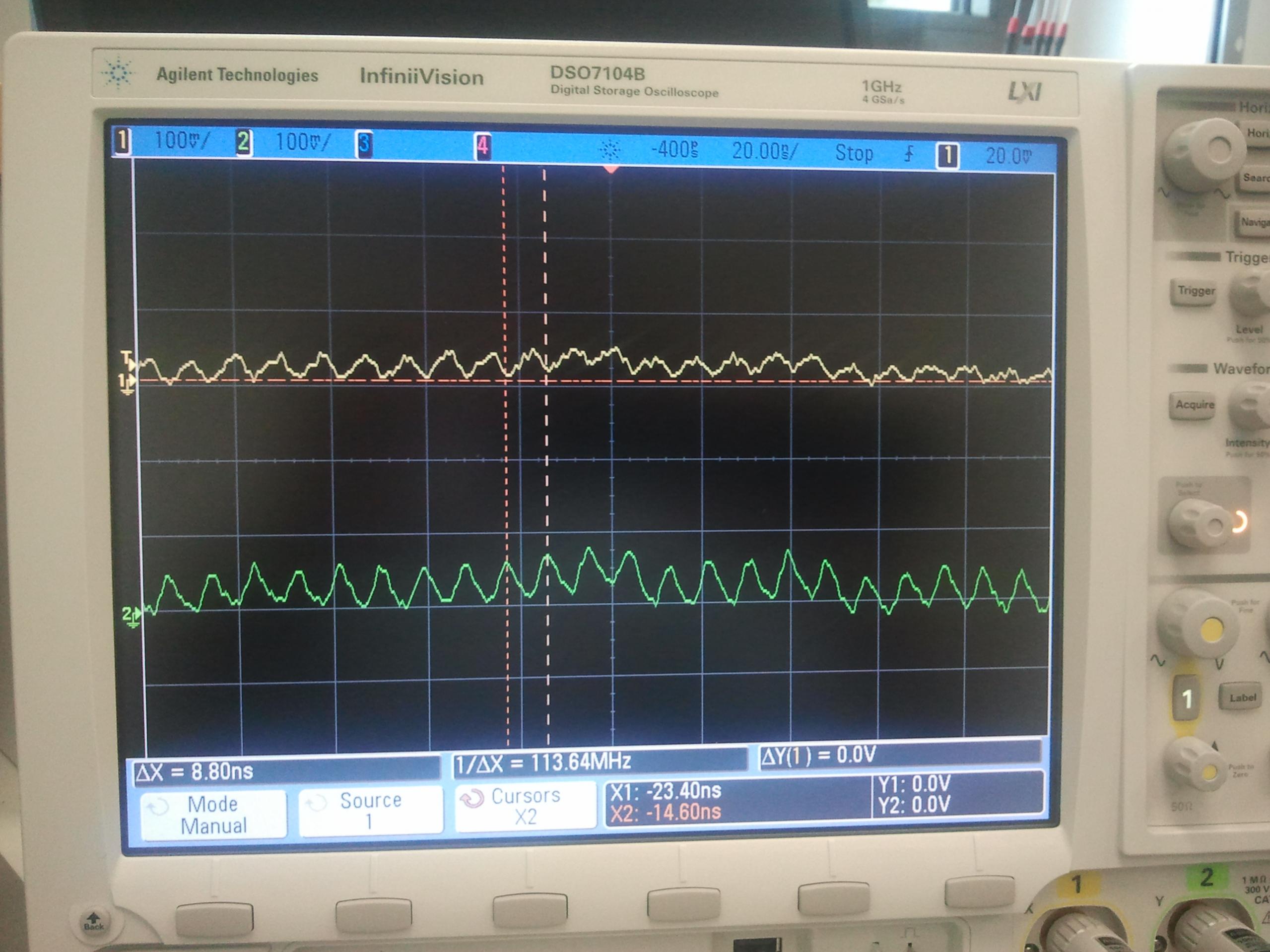

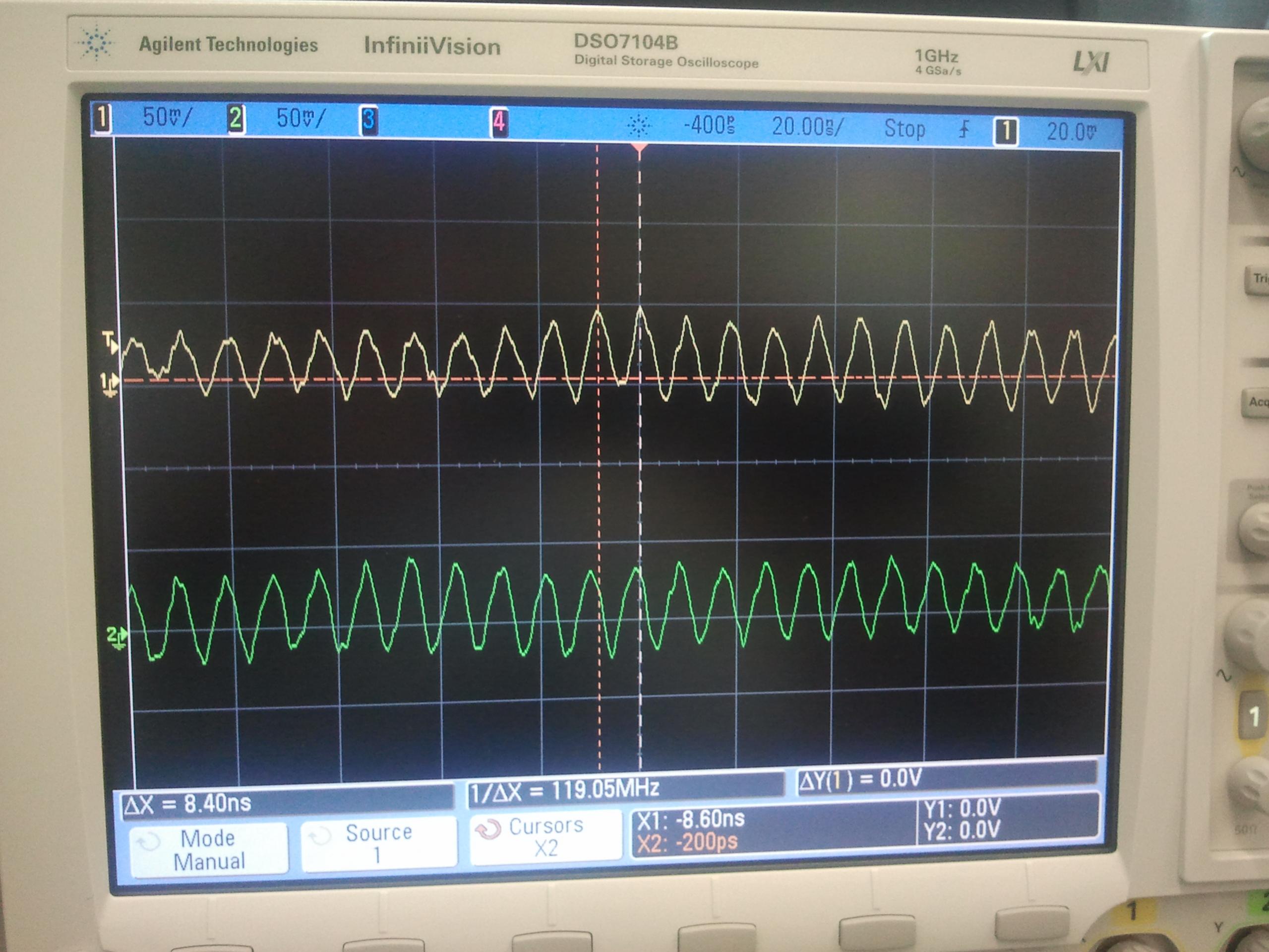

Hi there.
Finally I got the time to power up my paradise and do some measurements at our physics laboratory.
The pictures show the supply voltages (+/- 18V)without and within the caps for the distortion treatment.
the signal can be influenced by turning or tilting the pcb.
Though I think the signals are influenced by the enviroment. -No problem with the paradise.
Does anyone agree?

Do you agree that 113-119 MHz is VHF radio frequency territory ?
(which can be influenced by tilting, as any pocket radio at the beach in summer)
