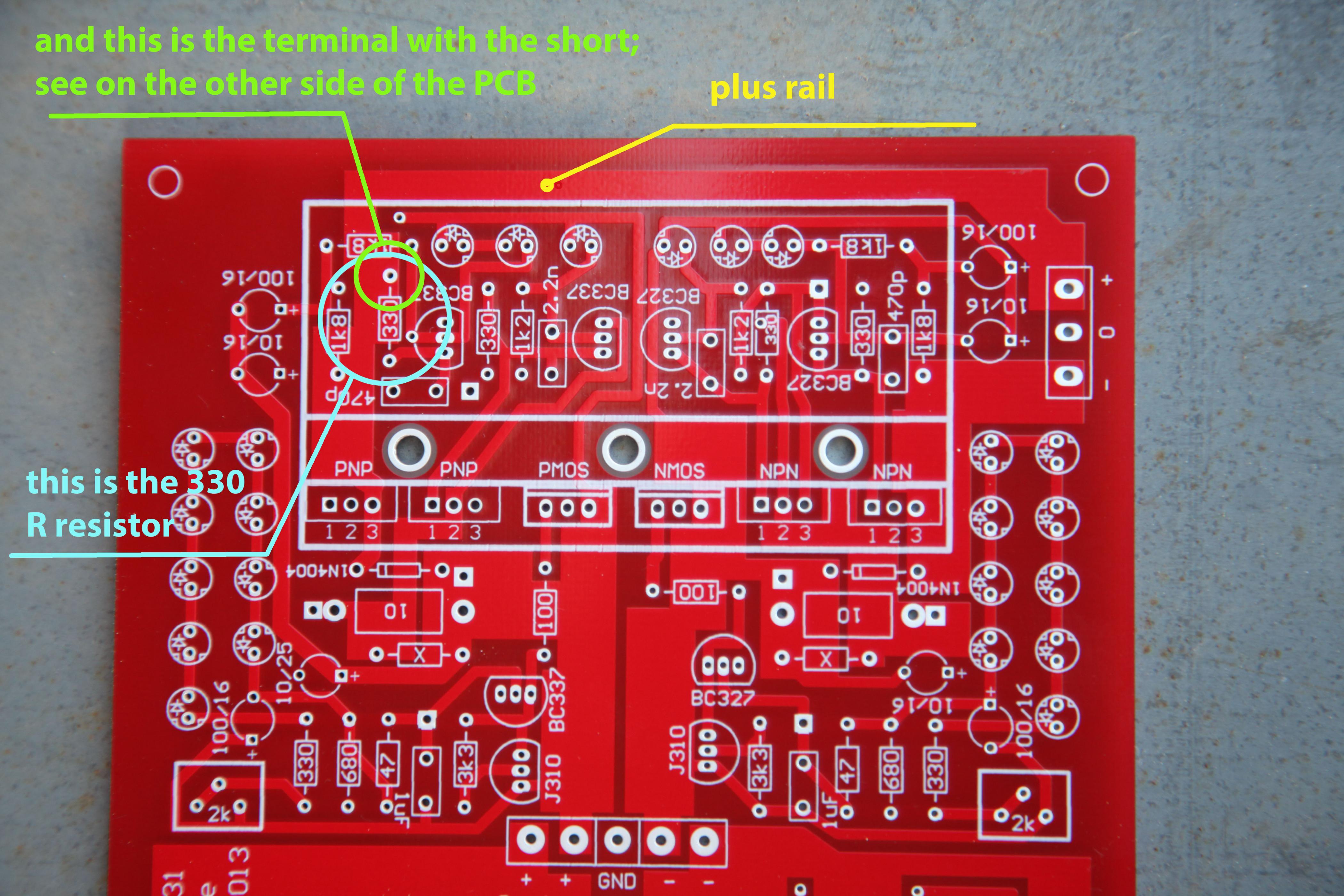

I think the issue of the shortage to ground is only on the latest batch of PCB's. My guess is that in order to make room for the compensation capacitors in the shunt, the resistor was moved to the right. In the same time the clearance rectangle from the bottom layer was not moved to the right, so the rightmost end of the resistor now accidentally connects the ground plane on the bottom layer. Maybe Alfred can confirm that also on the PCB file?
That connection should be removed, otherwise the short circuit can also create issues for the previous box (the pre-regulator).

hi guys, so sorry about this mistake!! my sincere apologies....
the layout is quite crowded and double-sided, should have done a better job in checking the result and run one more DRC and ERC....
thanks a lot emil for the fix, i will also email this to all subscribers

Not a problem, it was a minor issue, Alfred. You did a great and painful job with these smart PCB's. As Metallicus pointed out, probably when you inserted in the layout the 2,2 nF and 470 pF capacitors, something went wrong. But hey, that's the beauty of bastling!
Emil
Emil
It is indeed a minor issue, and easy to be sorted. It is still the best PCB I have worked until now, concerning the quality of the traces and soldering pads. It is important to have this corrected, but it was not intended as a critique, Alfred, as without your hard and free work, we would not have this beauty to work with.
