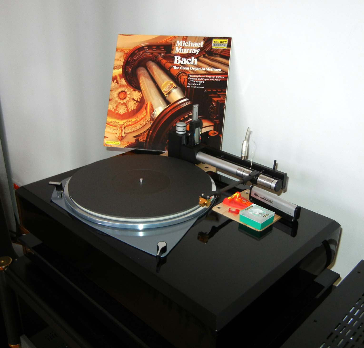

It is an Advanced Analog MG-1 air bearing with their Ultra P Slide Arm option. Lots of bang for the buck with this arm.

thank you , looks great! I was looking at the cartridgeman "conductor" arm, doesnt have VTA adjustment though, and is more expensive....

Isnt that a Dynavector karat 17 pu?Speaking of organs...

Thanks. That is a nice arm. I was fairly deep in my build when a used MG-1 became available with two arms, so I stuck an armboard at left rear of table. My initial plan was for a 12” Moerch DP6 I have.

Great mounting of the MG-1! I want one too, when they give in, and make a "mirrored" version! The Terminator looks promising, but IMHO; the arm is too short, and I do not like the "slead" so much over the record.
