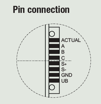

Beside these components which are on external PCB, the motor itself has Hall generator and other electronics integrated. Here are the connections to the motor:
ACTUAL - FG output (not connected)
A/B - direction control inputs (A=+5V, B=GND > clockwise direction)
S+ - speed control voltage (0-10VDC, currently 2.5VDC)
S- GND
GND
UB - motor supply voltage (23VDC)
All regulated voltages are OK.

Thank you for your reply. The motor in question is MB Papst from 2009 and is still in production. Beside the external electronics, the motor itself has internal electronics and I'm still not in, so wanted to check what to usually expect when this motor stops working.
The motor is definitely dead. I fed 24VDC to supply pin and 5VDC to speed control pin (which is 50% of speed control voltage range) and it doesn't react. When connected to power supply, the motor enters brake mode, that is, it resists shaft movement, so there is definitely fault in the motor.
