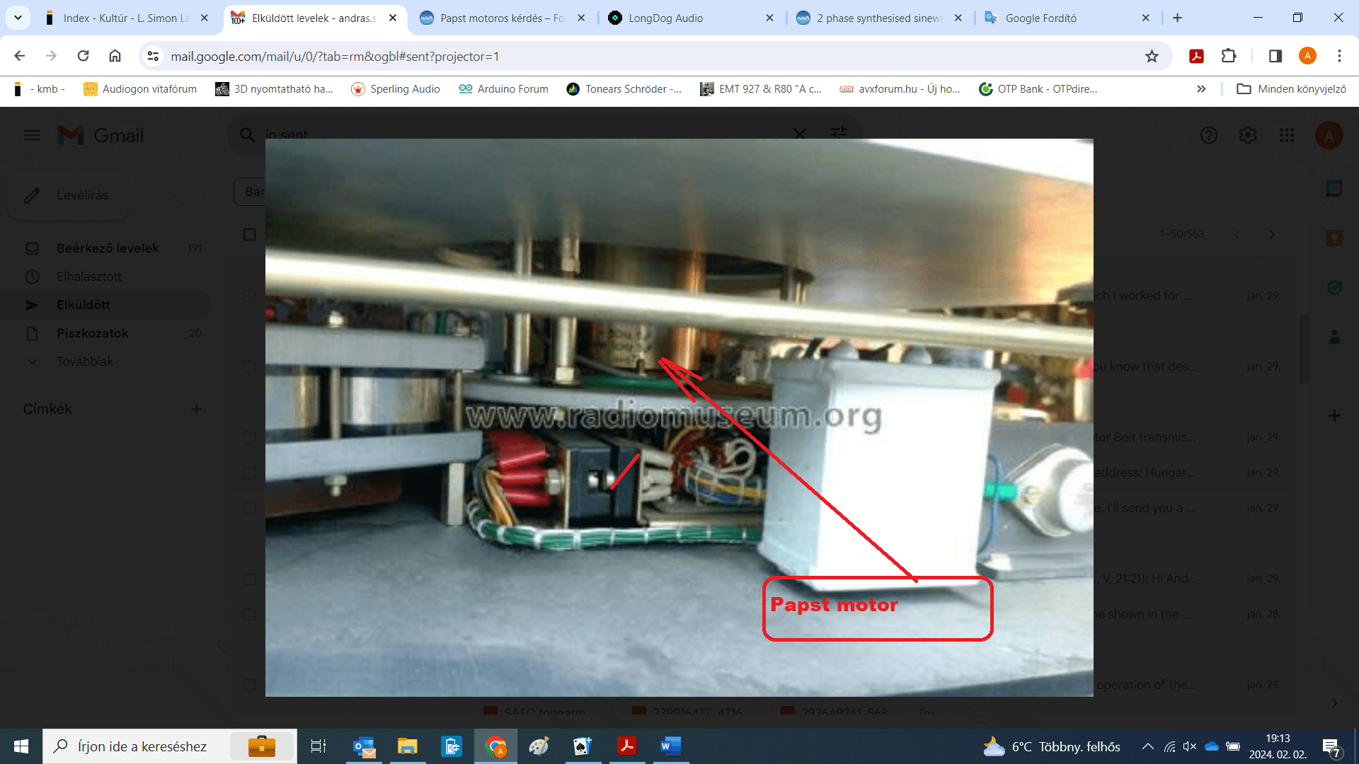

Dear All,
I want to use a Past motor for my DIY turntable.
I saw that this was solved here. I would be interested if you could send me your wiring diagram
Andrew

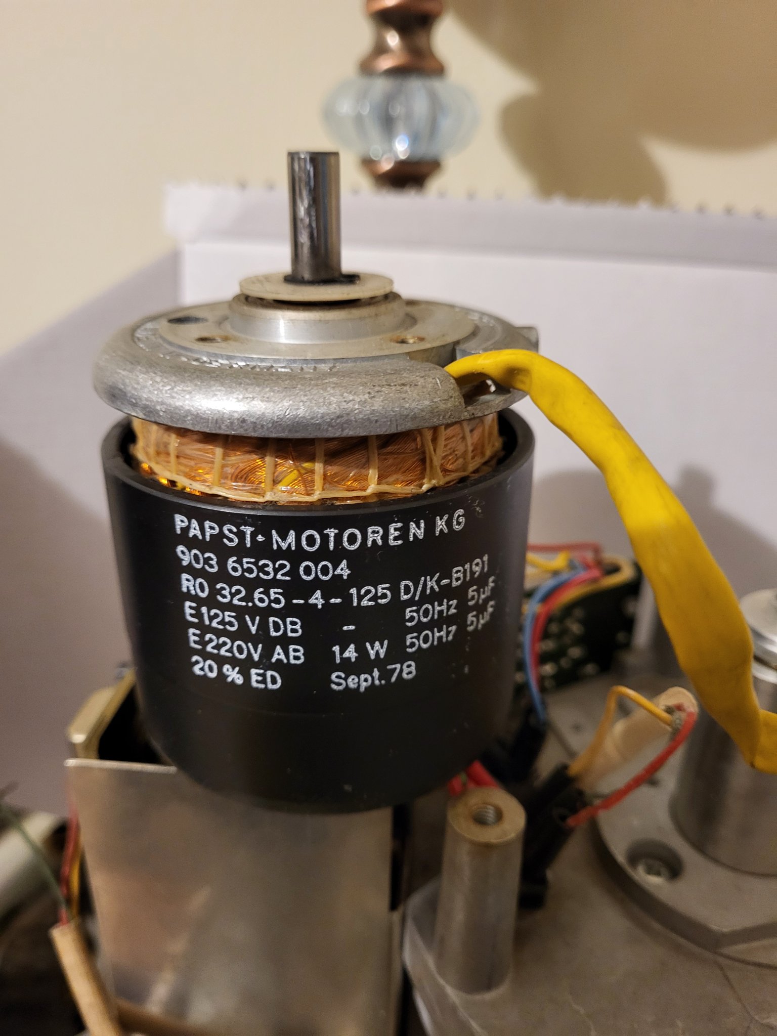

The Papst motor you show is not ideal, being a reel rather than a capstan motor. There are two major differences that I'm aware of; reel motors are designed to run at very different speeds instead of the constant speed of a synchronous motor; and most have ball race bearings which are rather noisier than the sleeve bearings used in capstan motors.
With Papst motors the OEM number gives a good indication of the type; numbers starting with 901 are synchronous, 902 are near to synchronous but do adjust speed a little with load; and 903, which are designed to vary in speed with load and voltage.

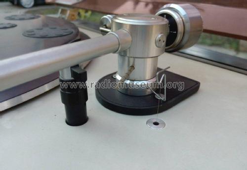

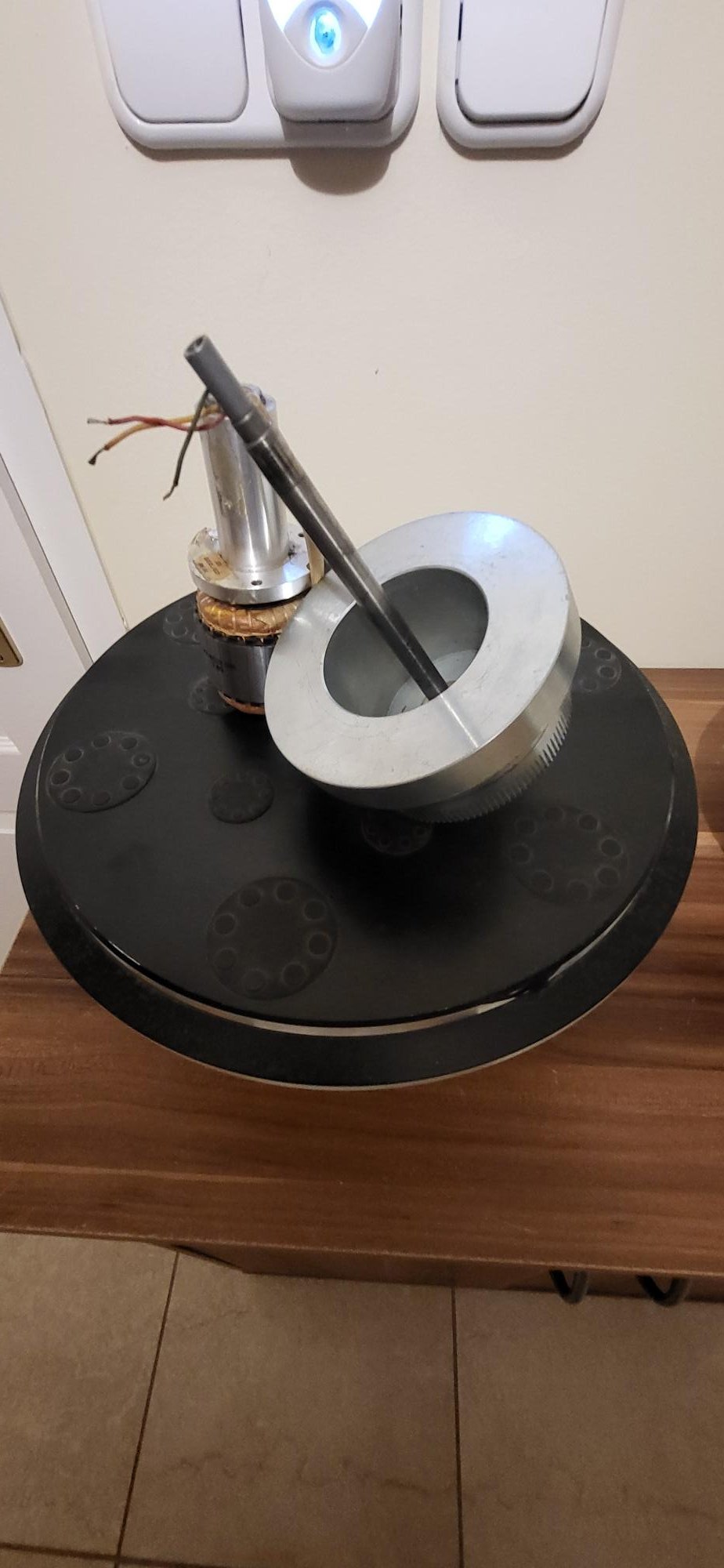

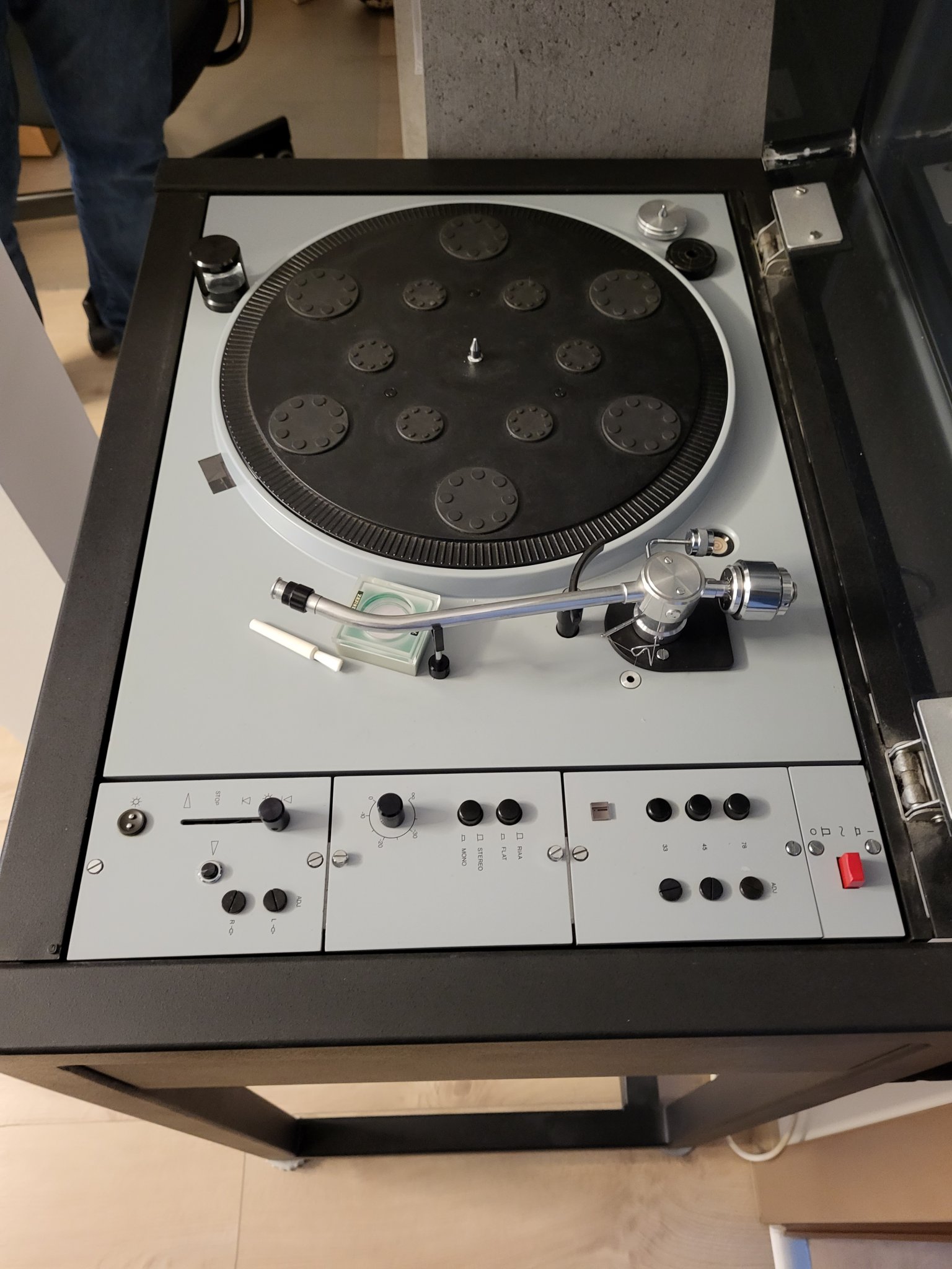

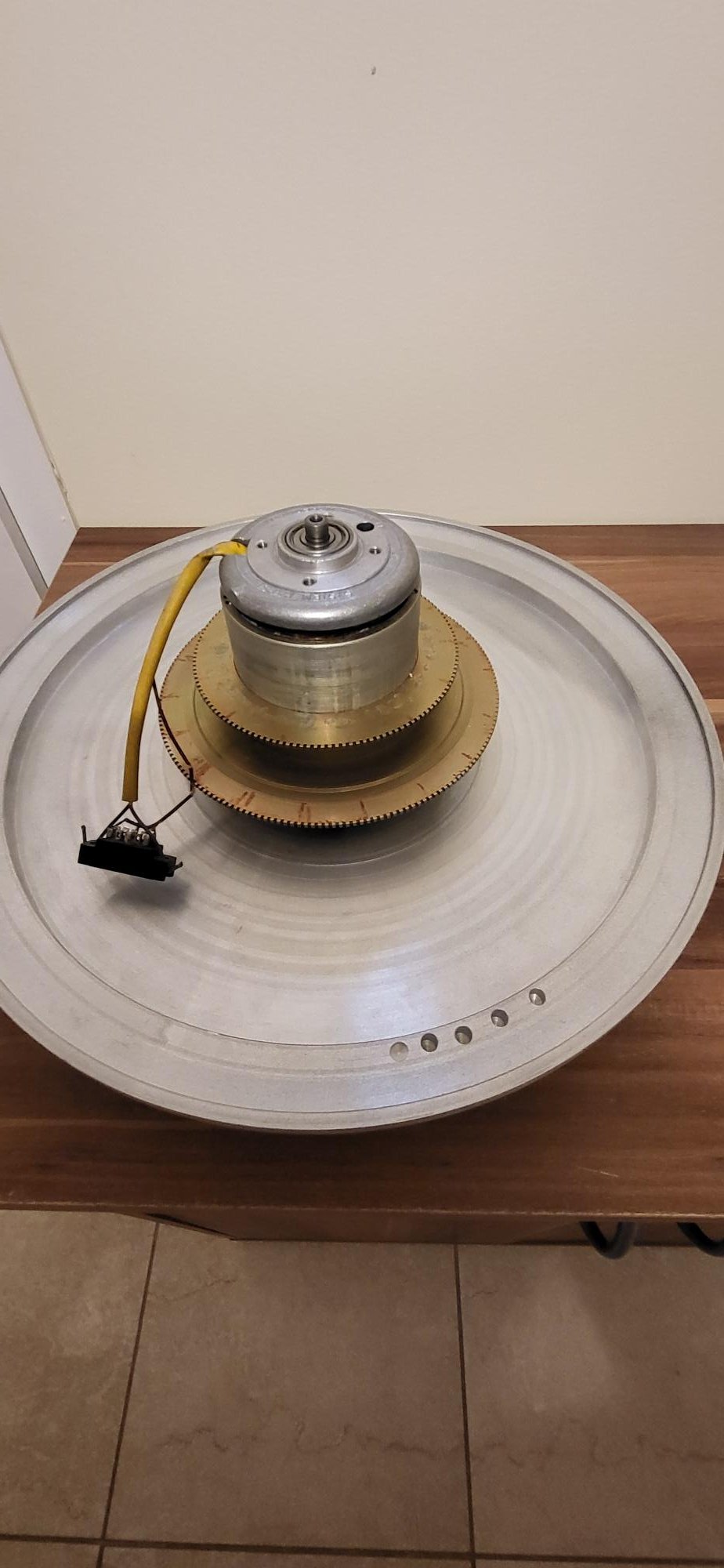

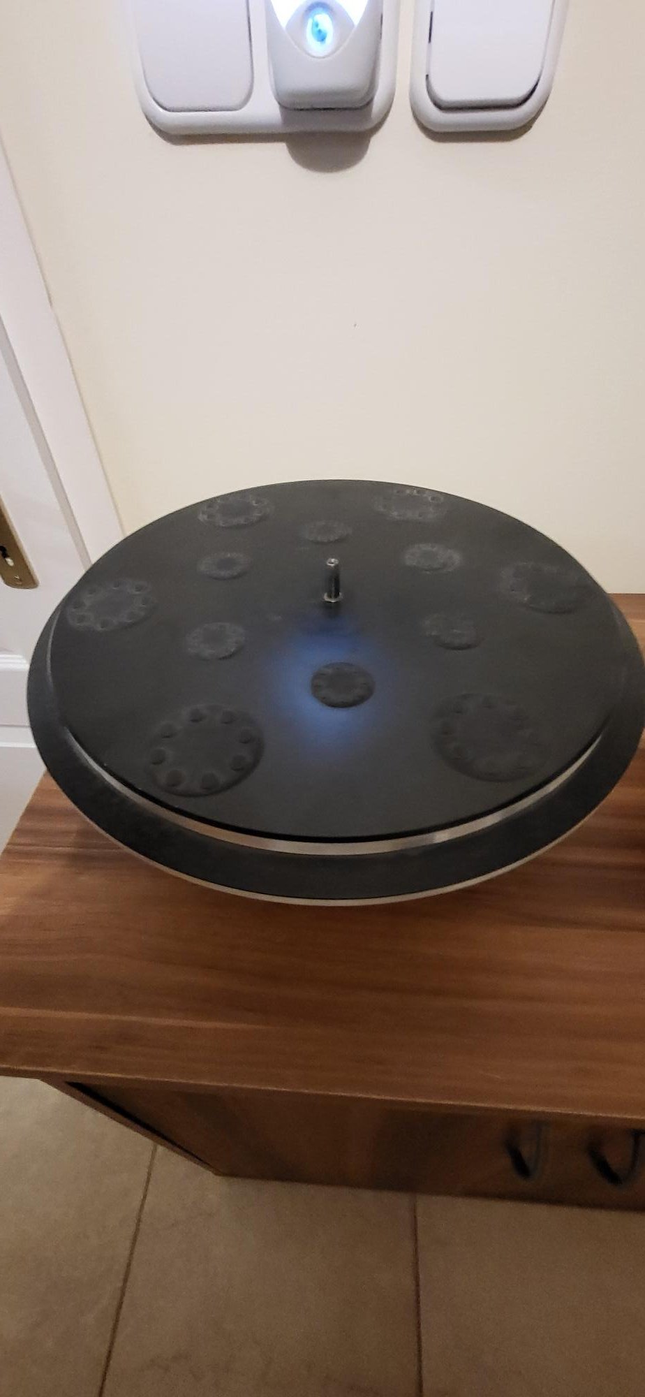

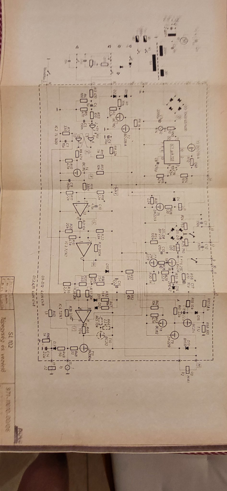

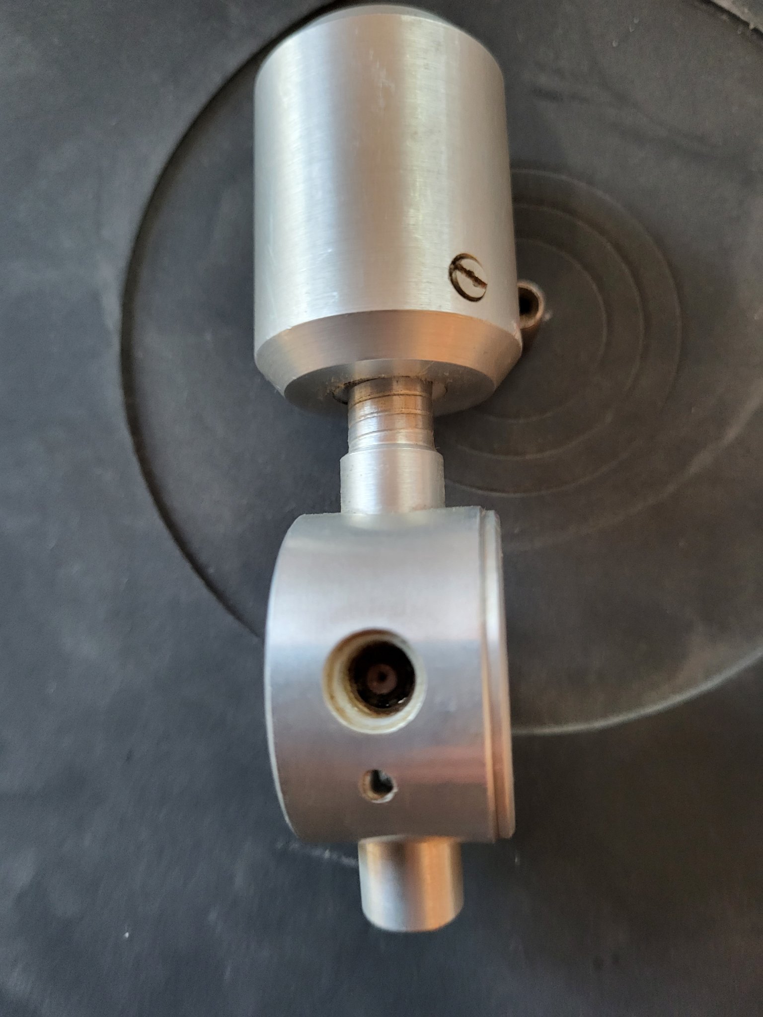

Dar Ralph,
Between 1980 and 1992, the Mechlabor SL 102 record player shown in the picture was driven by the Papst motor shown in the picture and the controller shown in the drawing.
I would like to make a copy of this record player that still works today. I would like to make speed control and display in a more modern design.
The motor is incredibly quiet because the ball bearing has been replaced with a sinter brass bearing. The shaft run out is less than 0.001 mm.
Bearing gap 0.002mm. So the mechanics are perfect.
