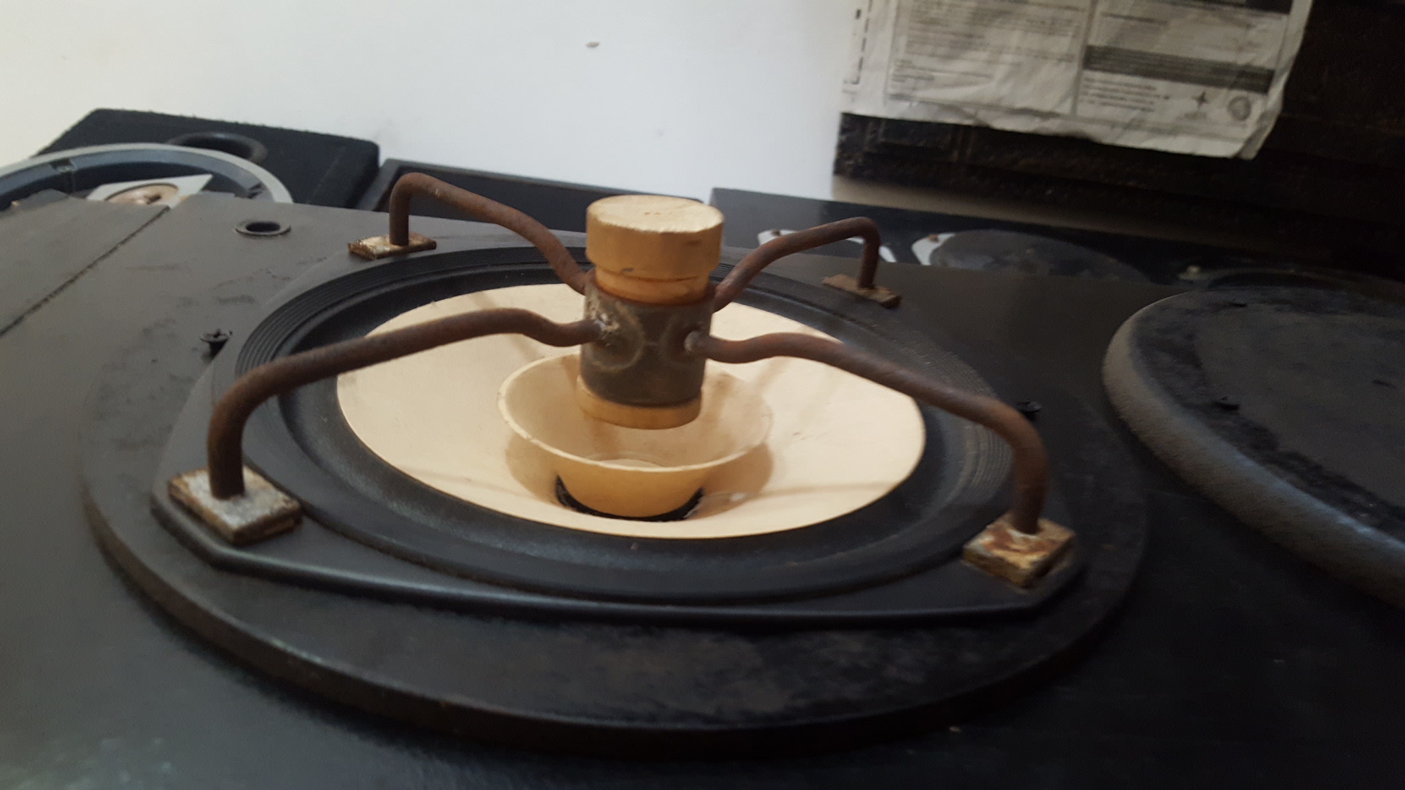

I have put a phase plug in front of the vizzer cone to disperse the mids.
We love the 206 even with this birth defect.

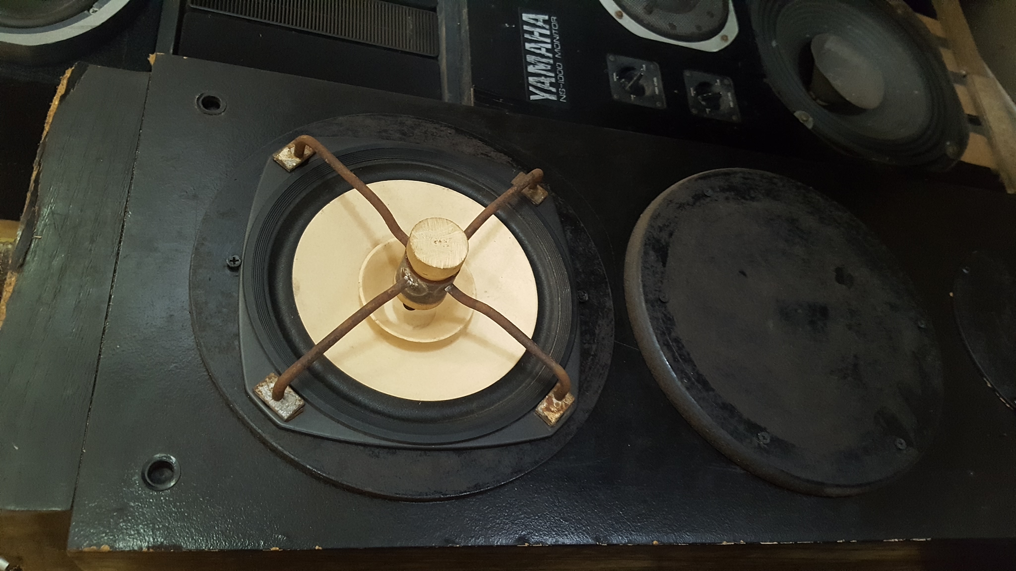

Hi Dave,
See the phase plug used to disperse the 206 mids throuhg out the room. Without these mids are concentrated to a perticular area in front. The phase plugs do not attenuate the mids they disperse it in a wider field area.
rgds,
john.

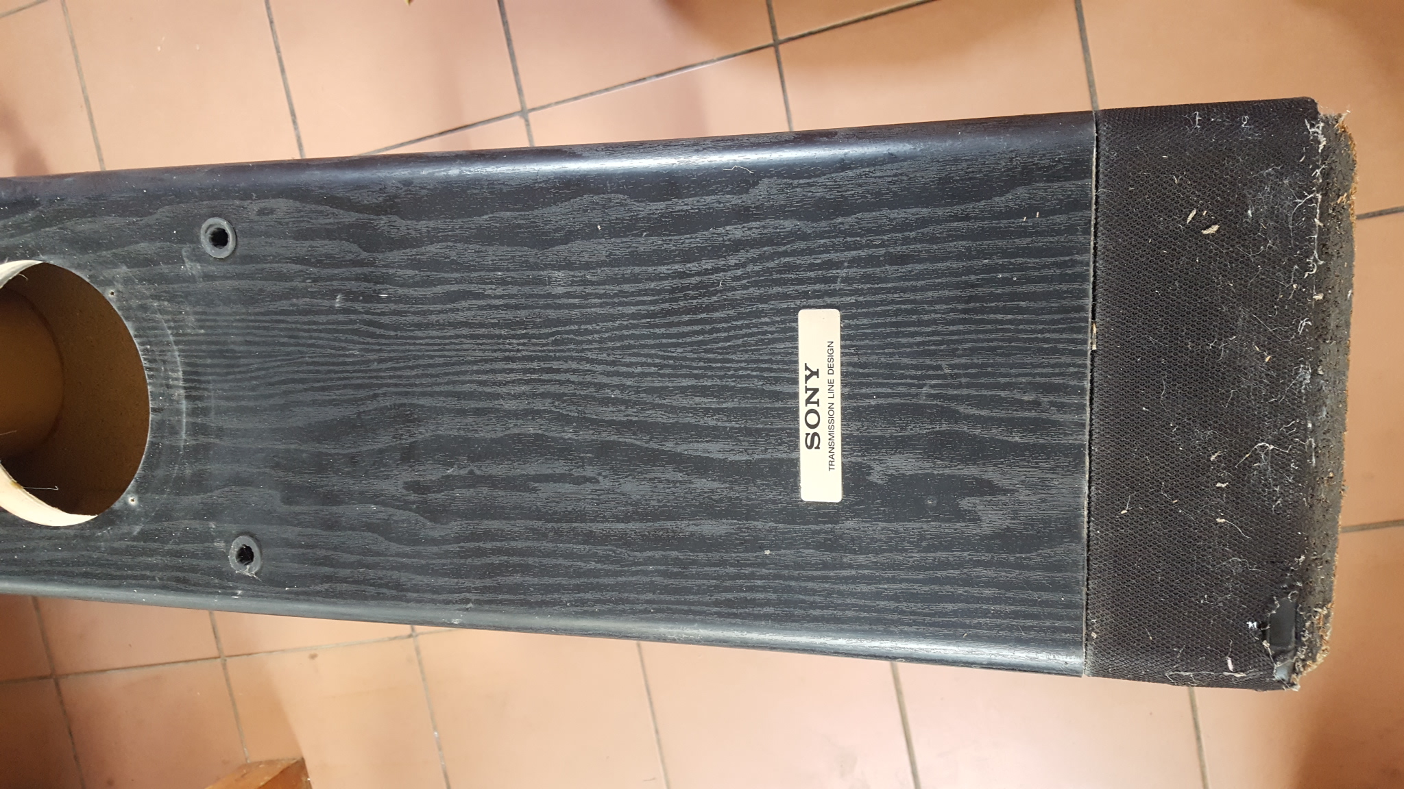

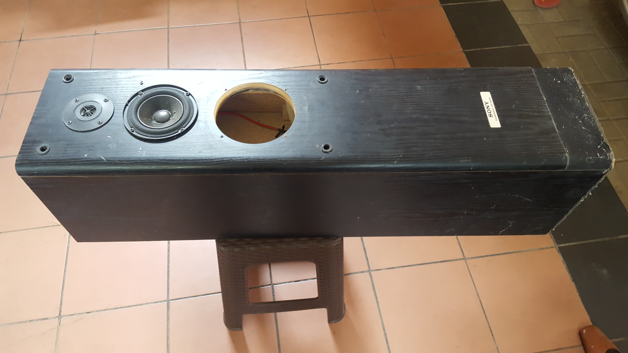

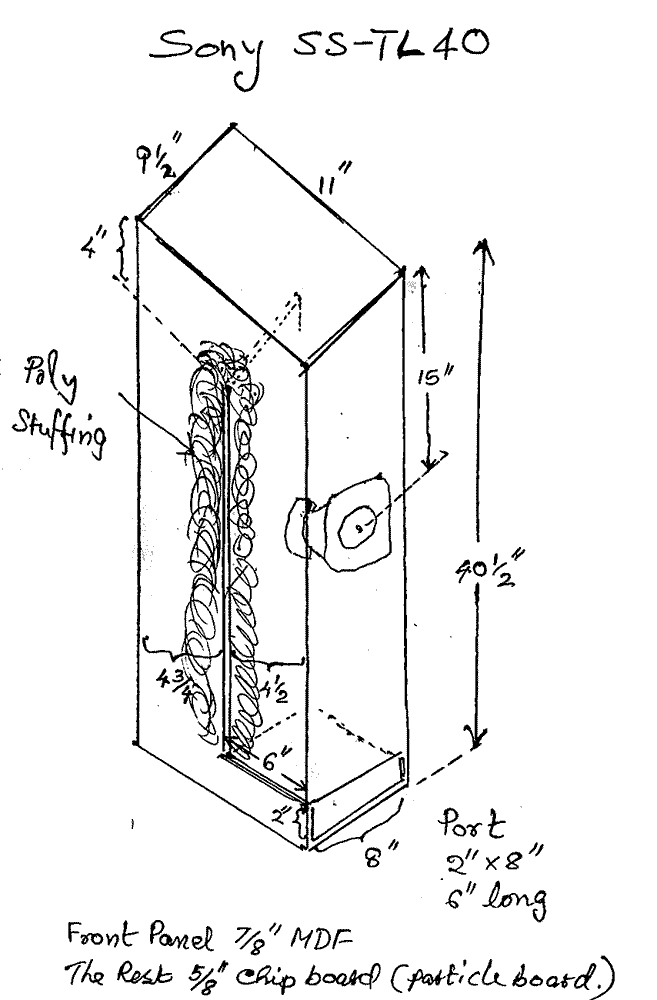

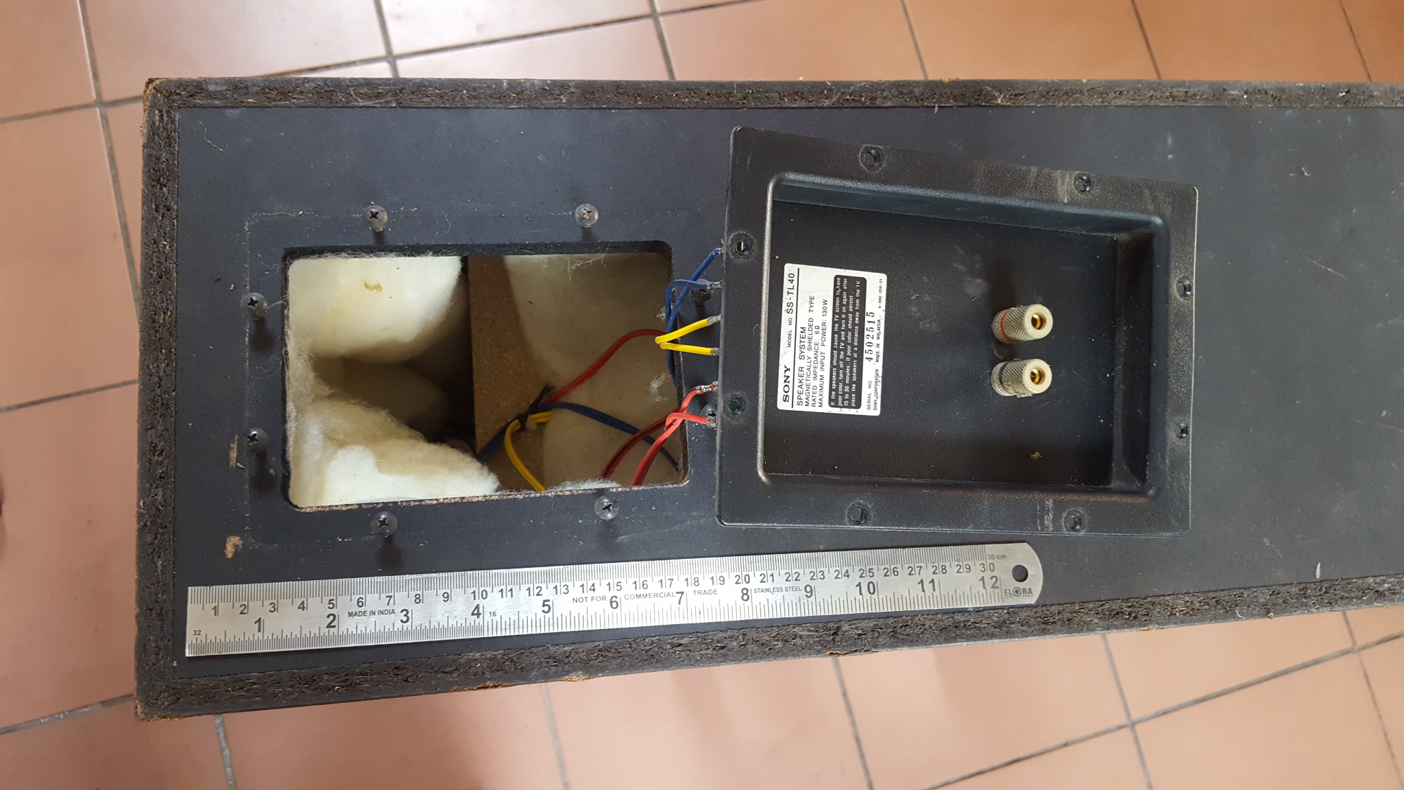

Hi Everyone,
I have given dim's of Sony SS-TL40 transmissiln line speaker box.
Could anyone please suggest how I could alter these dim's and build a box to accomodate the FE206e driver.
Please let me know the results when these dim's are entered to the TL worksheets.
rgds
john.
Hi All,
Remember that the 206 is wider and has a massive magnet structure running deep into the box. That's one of the reasons I was kept back from copying the exact design.
The front chamber should be more than 5 1/2" deep to clear the 206.
john.
John,
The FE206E product sheet shows driver height including magnet is ~3.5", and the cutout is ~7.2".
If you are using 0.75" material and you have 4.5" gap from the internal divider, the driver magnet will be 1.75" from the back. If you use a supra baffle or double layer baffle, then you can put in another 0.75" gap.
With 8" internal baffle width you will be able to do the 7.2" cut-out (not ideal); the driver frame will extend on to the sides a bit.

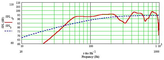

The Sony cabinets you described (assuming the internal cavity extends from top to bottom) should be some form of MLTL, which I would expect to add an octave of extension to the bass response: approximately 40 to 80 Hz coming from the port. The 80 to 100 Hz where the ‘thump’ is generated should come mostly from the driver directly. The FE206e has an Xmax of 1.5mm, which hardly seems like enough to make the thump. Fostex drivers are quite robust, and I have seen their cones move well beyond Xmax without damage. However, this will result in compression since you are beyond the linear range of the driver. So maybe you can make the 206 thump, but I would expect the sound quality to be compromised. And doing this for very extended periods may cause the voice coil to over heat and fail.

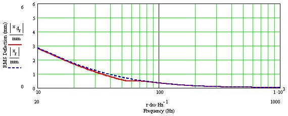

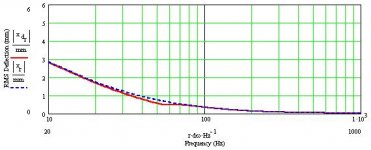

That said, I was curious enough to boot-up my old computer and run a model of the FE206e in a version of the PTL. I guessed the dimensions based on the 206’s Vas and Qts. Either I’m better at this than I think I am, or else I was very lucky. This is pushing the 206 for more extensions than I would normally want to; while Fs is 39 Hz, you can’t tune that low with a driver Qts=0.18. The cabinet is tuned to 56 Hz. I have attached two graphs: the first shows the ‘raw’ SPL curve, while the second shows driver excursion, both are for 1 watt input. In the first graph you can see the response beginning to trail off, then there is a slight bump before F3; if you try to tune lower, this will become progressively worse making one note, boomy bass. When the speaker is placed in a room, there will be boundary re-enforcement which will lift the bass some, with usable response to the mid 40’s. It probably would be a listenable speaker, but it could be better—as in more like one of Scott’s Woden Designs. Yes, most of us here are trying to create what you referred to as ‘orchestral bass’; in other words: no thump.
Cabinet Dimensions: Referring back to my PTL dimensions shown in the drawing: the cabinet is still 10” wide internally. Still 39” tall; internal depth is reduced from 13.75” to 12.75”. The slant board was 6.5” from front, back, and top; now it is 6”. The driver center is 6” from the top (internal). Shorten the bottom board from 25” to something in the range of 21” to 23”—whatever seems good to you. The mouth height remains at 8”, although it could be increased to 9” if you wanted a response curve more like what I have from my PTLs—this would loose a few Hz on the low end, but raise and flatten the curve. The baffle has a 5 degree slope for both appearance and sonic reasons.
That said, I did try playing the Dixie Chicks ‘I Can Love You Better’ (about the only thing I have with a kick drum in the track) on my PTLs with SPL peaks hitting 95 dB (as loud as I can stand) and I don’t get any chest tump. So I really doubt that a PTL cabinet for the 206 will do what you want.
Cheers, Jim
