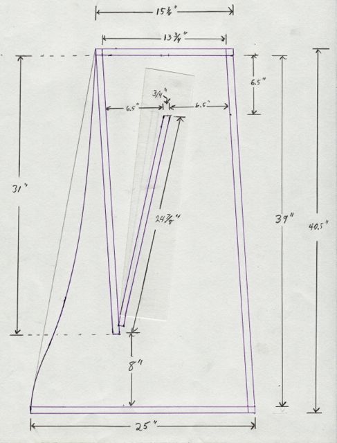

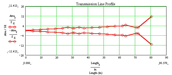

The design is an expanding TL with a very slight constriction just before the terminus. Looking at the design and how it behaves in simulations (and discussing it with Martin), I am quite sure that this is a TL, not a horn. The ‘mouth’ (which I am taking as the 8” tall x 10” wide constriction) simply isn’t large enough to act as a horn in the bass frequency range. Hence the name: Pappa’s TL.
With that introduction let me say that despite superficial appearances:
This design is NOT a Frugal Horn! It is not endorsed by either Scottmoose or Dave @ P-10. They have resisted calls to release designs for a Frugal-Horn using larger drivers. Having worked through a similar design, I can see why: the cabinet gets big & clunky AND the low freq extension isn’t what most folks would expect-- at least not with the cabinet size & bass alignment I want to use. While you can push the tuning lower in a moderately large cabinet, you end up needing significant EQ to get the bass SPL to match up with the level of the mids & highs--then you have problems running up against Xmax. Of course, if you want a really huge box, then deeper bass becomes a possibility. Just plug the numbers for the FF225wk into the BIB calculator...
Shown below are the TL profile from MathCAD and a diagram of design:

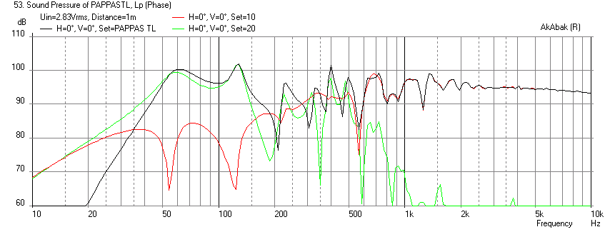

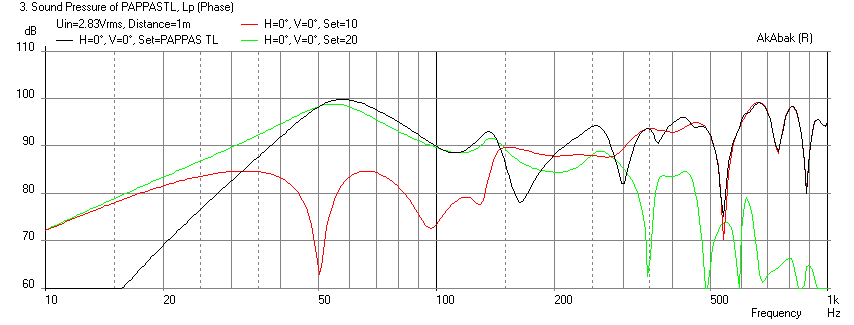

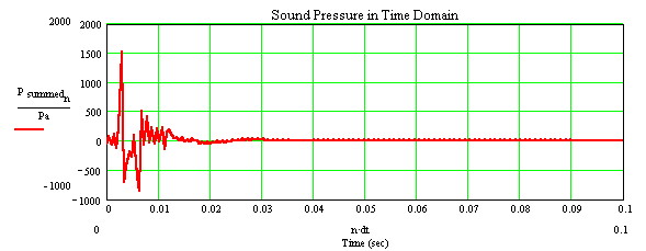

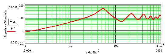

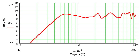

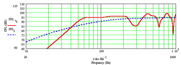

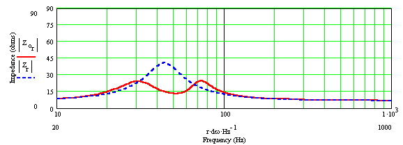

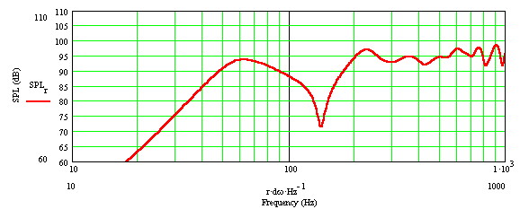

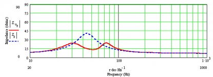

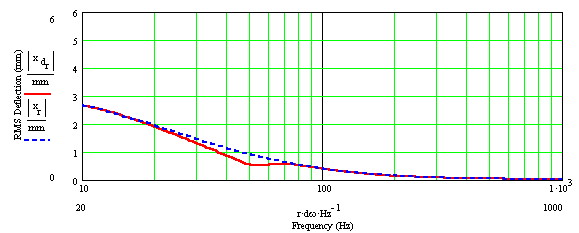

And now: Here are some of the graphs from MJK’s MathCAD simulation of Pappa’s TL.
You may note that the TL is tuned to 54 Hz, despite the FF225wk having an F(s) of 44 Hz. As mentioned previously, if you tune lower without making the enclosure larger, then the SPL drops at low frequencies. My preference is to keep the box more modest in size and give up some bass extension. Hoffman’s Iron Law in action.
And before anyone asks: don’t bother putting other drivers into this cabinet, the results will most likely be disappointing. The only one I checked which wouldn’t fall on its face is the F200A--it would sound OK, but should really be put in a cabinet tuned to get the most from it rather than settling for merely OK. The FE206en and FE208eS don’t work.
Measurements will be coming, but at the moment things are a bit busy. After Labor Day, Martin will bring his PE Omni-Mic over & have a listen.
Graphs:
-- acoustic impedance
-- SPL (from top of worksheet)
-- electrical impedance
-- woofer displacement
-- in-room SPL
-- impulse response

Graphs:

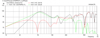

Nice work there Jim. So it sounds like you have actually built it? AkAbak came up with the same tuning freq and I like how you are keeping the SPL high rather than push for low extension - 54 Hz is good for most music. Placement from wall seems to be a critical factor. How far back is the wall in your in room simulation?
Hi X,
IIRC, the placement is center of the baffle 3' out from the corner on a 45 deg line. (It's whatever the default in MJK's MathCAD worksheets is.)

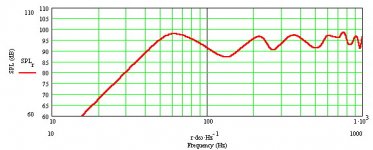

Simulating boundary loading:
We all know that rooms have a profound affect on how speakers sound. And thus we spend lots of time fiddling with speaker (and furniture) placement, optimizing things as best we can. I have felt that rooms with cathedral ceilings sound better than rooms with standard 8’ ceilings. Using Martin’s MathCAD worksheets, I can see at least part of what is going on.
The graphs below are from the second part of the worksheets. Speaker positioned as follows:
Distance from Room Corner of Baffle Center= 36”
Angular Position from Room Corner of Baffle Center= 45 deg.
Rotation of Baffle Towards Room Center= 35 deg.

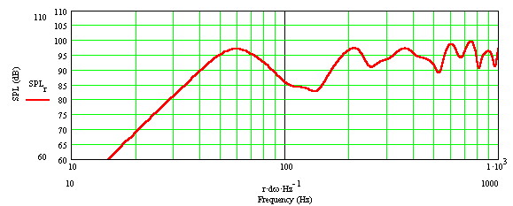

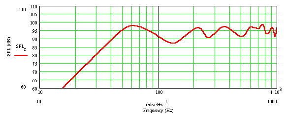

SPL curves are shown for:
walls but no floor & no ceiling
walls & floor but no ceiling
walls, floor & 8’ ceiling
walls, floor & 10’ ceiling
There is no option for a slanted ceiling, but I think the sloping of a cathedral ceiling is beneficial. But I could be wrong... Whatever, I think the graphs show that having the ceiling a bit higher is better.

Here is what I get for a corner placement at 36 in from walls and 35 deg toe-in. Looks very similar - I just can't get the damping to smooth out like the MJK.

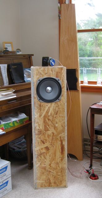

With a Met, I know what I’ll get. With this design, I was less certain, so I built a prototype in oriented strand board. OSB is cheap, both in terms of cost and quality. When this project is finished, I will have no qualms about tossing this ugly thing into the trash.
I usually spend about 2 months building a pair of speakers. I obsess about every detail of fit & finish. Not that I can produce anything close to the furniture quality cabinets of someone like Terry Cain, but I want it to be the very best I can make. Using crummy OSB, I saw no point in worrying about appearance: just cut the wood & glue it together. Why waste time cutting another piece of OSB just so that the bottom board extends all the way to the back of the side extensions? The piece that’s an inch short will work just fine for test purposes. Curvy bit on the sides like the FH3 is esthetically pleasing, but not worth it here. My one concession in this regard was sanding the edges & corners so that I wouldn’t get splinters every time I got near it. Even so, I don’t want to try moving it around without gloves. I’ll say it again: ugly, ugly, ugly! So, less than a week from start to completed speaker. From the front, it doesn’t look too imposing. But from the side, it’s a different story: this one hefty chunk of speaker!
I stuffed the first third of the line with Parts Express Acousta-Stuf. To prevent reflections from sides, back & top, I lined the areas near the driver with 1.5” egg-crate foam from PE. Mounted the driver & gave it a listen. Not bad, but needs BSC. Calculator says 1 mH inductor and 2.5 ohms for 3 dB correction. I settled on 1 mH and 2.2 ohms. Listen again: nice! Except that cymbals sound dull/muffled. Of course I knew this would be the case; both from comments about the FF225wk and because I had been breaking them in in cardboard boxes for 220 hrs.
Time to add the Eminence APT-80 tweeters. The tweeter will be mounted in a separate box on top. This arrangement provides maximum flexibility: it can be facing the front wall or corner--as recommended by Bob Brines (and similar to other designs like Terry Cain’s Super Abby). Or it could point toward the ceiling. Maybe even face the listener. During testing, I found that not all recordings are created equal: most sounded better with the tweeter facing away from the listener, while a few were better with the tweeter aimed toward the listener. And if you move the speaker around, then the tweeter might do better if positioned at a different angle. With the tweeter in a separate box, it’s a tweeker’s dream!
I couldn’t find an impedance plot for the APT-80, so I am basing my calculations on its nominal impedance of 8 ohms. With a specified sensitivity of 106 dB, I guessed at a 0.47 uf capacitor, which should yield an XO point of 41 KHz. Connect it up & listen again: not bad, but not quite enough on some recordings. I haven’t settled on a final value; it’s a toss-up between 0.47 and 0.69 uf. If I change my mind, it’s no problem to tweek it, since it’s in the tweeter’s enclosure up top and easily accessible.
For evaluation during extended listening, I put the FF225wk on the left channel and one of my FE167e Mets on the right channel. Result? Completely satisfied. Goals have been met, yea, exceeded! Large scale orchestral music sounds very good; sounds... well, large; doesn’t get congested and can produce 90+ dB peaks with no problem. What’s more, the bass has more extension than I expected. Using Stereophile’s test CD and my trusty RS SPL meter, I get an F10 of about 40 Hz at the listening position, thanks in part to room reinforcement. I thought I would need to get down to 30 Hz for a satisfying experience, but so far, I haven’t felt the need of a sub.
And what does SWMBO think? She describes the sound as sweet. Yes, it’s bit clunky, but it’s tolerable. Verdict: time to go buy plywood and order veneer!

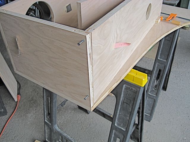

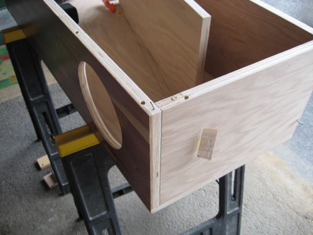

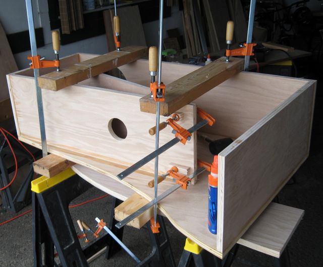

So I purchased two sheets of 3/4” plywood from Curtis Lumber. (The local Home Depot & Lowes don’t have any 3/4” ply that I want to buy--too many voids, not flat, and/or just plain beaten up.)
The curved edge on the rear of the side pieces was done by having my wife sketch the curve on one piece; then I used a jig saw to cut it as well as I could. Sand paper and elbow grease smoothed the curve. That first piece was used to replicate the other three side pieces; after rough cutting with the jig saw, they were cut to final shape with a router & a pattern follower bit.
I mostly build using dowel pins (for alignment) and clamps. In this build, there are a couple points where I reverted back to screws (for alignment and hold) or 17 gauage wire brads slipped into 1/16” pilot holes (for alignment).
The back/divider board joint was done by cutting the divider slightly short, then making a suitably angled flat spot on the bottom edge with a sanding block. When clamped together with an abundance of wood glue, the result is a nice tight ‘V’ joint.
