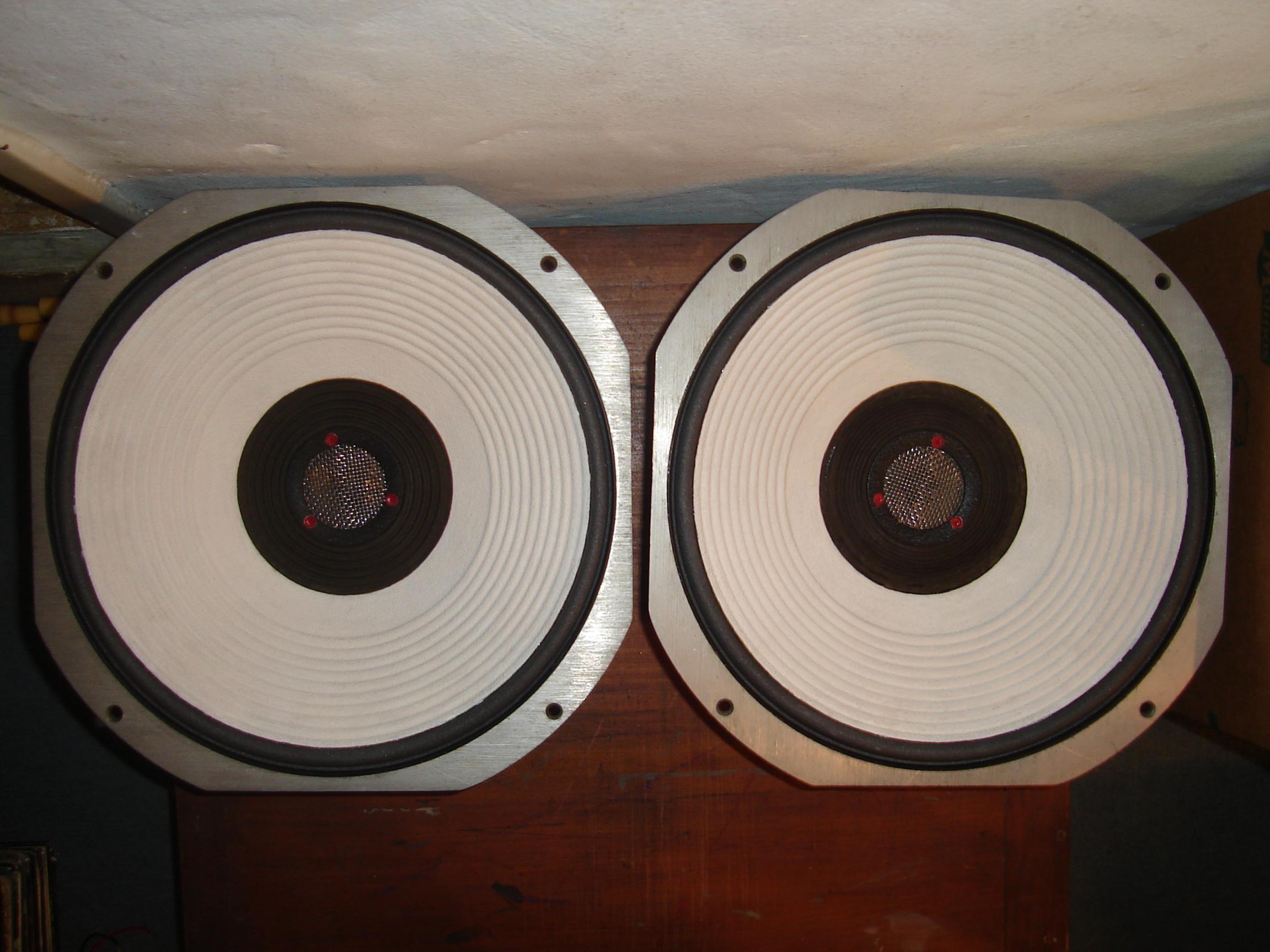

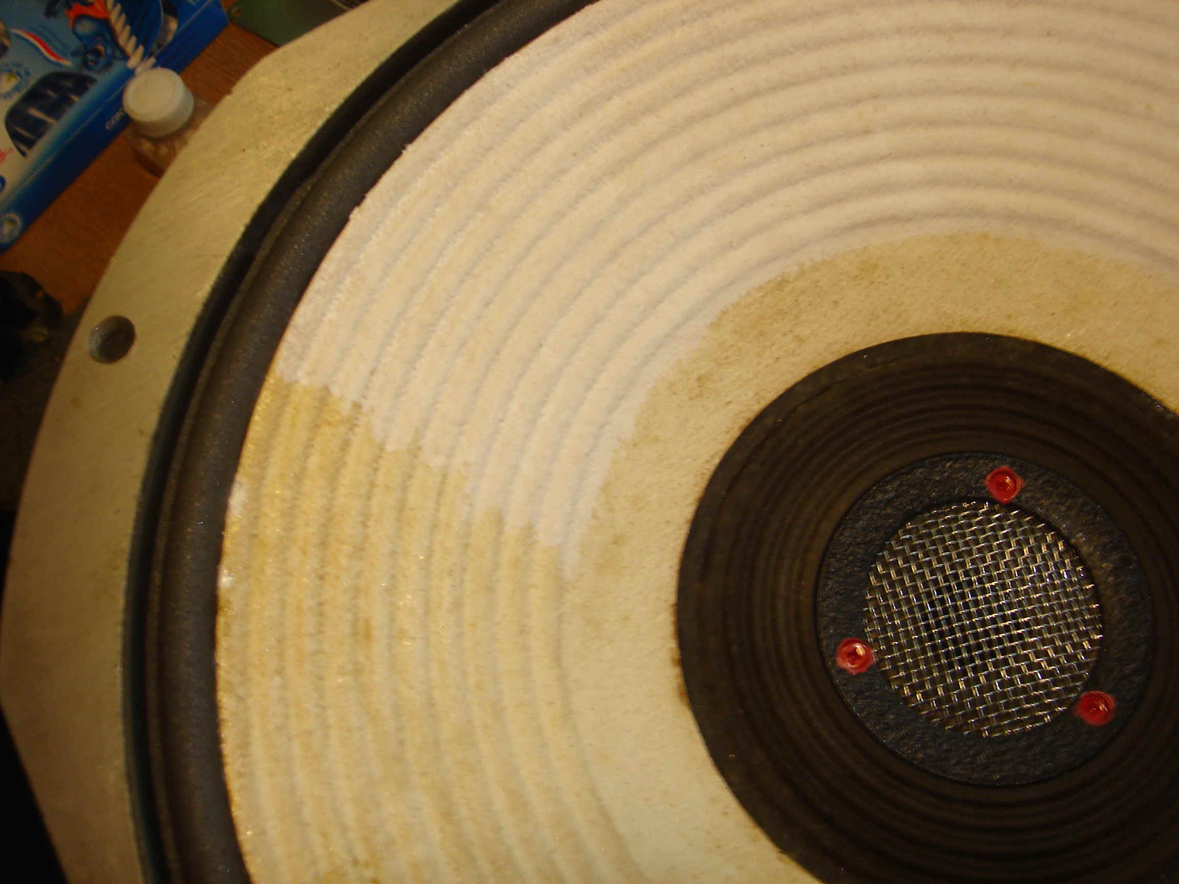

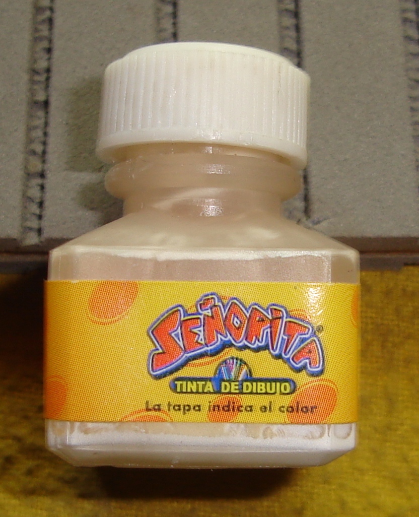

Seriously? Why food colouring, why not arcylic paint for the rest, not just black?
That is where i started when i wanted to do colours. I used ink originally for black, but black ink is really dark dark blue. And the black food colouring is an ugly green.
These work for me so i haven’t gone further, but i am sure there are lots of things you could use.

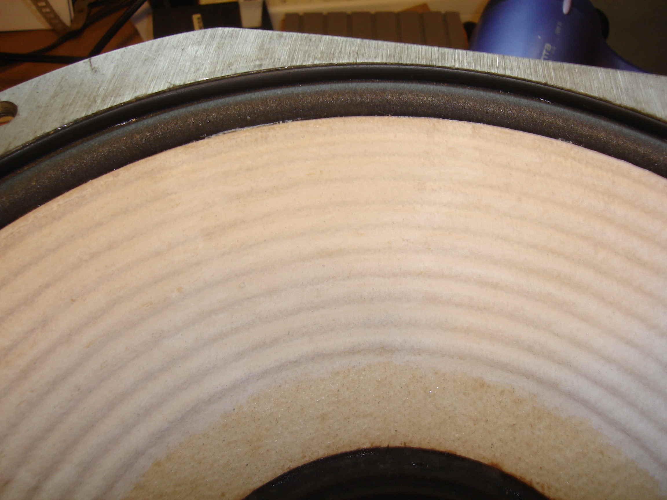

Good black colour is hard to get indeed and doubly so on speaker cones, because any "paint" alters cone mass and damping, big time.That is where i started when i wanted to do colours. I used ink originally for black, but black ink is really dark dark blue. And the black food colouring is an ugly green.
dave
Black "dyes" of any kind are poor quality, not-really-black as you found out and to boot, not stable; you need a particle based colouring instead.
Absolute best is carbon black, the real one, purified version of soot collected inside chimneys and Diesel engine exhaust pipes to name a few sources.
Very light and fluffy.
Also stable under any chemical or UV attack ... hard to degrade what is already as simple a molecule as can be.
Now lately it´s common for chemical supply houses to offer as Carbon Black a completely different product: very finely ground Black Ferrite, which is fine as colourig in, say, ceramics or plastic ... but weighs 10X as much.
Properly said: has literally 10X higher density, which adds unexpected weight to speaker cone.
Even worse if you cover cone with a "paint" which besides the pigment weight also adds that of the paint base carrying it.
Plus an "acrylic" type paint, for better or for worse, will add damping to cone; so in a nutshell, if you want a black cone, best and least intrusive is to add a small amount of pure "real" carbon black to cone paste formulation.
