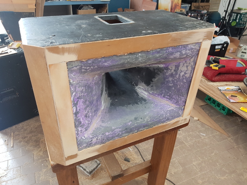

@hollowboy can you post some pics of how you constructed these horns? Which flare shape did you use?
The smaller horns in post 20 are JBL 2370 flat-front Bi-Radials. These aren't in use.
The larger horns in post 20 are based on no-name plastic horns from ebay (seller = zxpc).
I chose the longest 2" horns I could get at a reasonable price, after rejecting some local options (mostly JBL or JBL clones, with slots and/or sharp angles in the throat).
I modified the throat + extended the mouth with wood and filler.*
They look expo, but may not be. I picked them for the relatively low flare rate (to be a reasonable match to old JBL drivers) and smooth walls (low diffraction).
The exact type of curve used doesn't concern me as much as those points.
*In hindsight, I think extending the mouth with foam + a thin rigid layer would have been a lot less work. I keep posting this link cos I think it is a lot more clever than what I did:

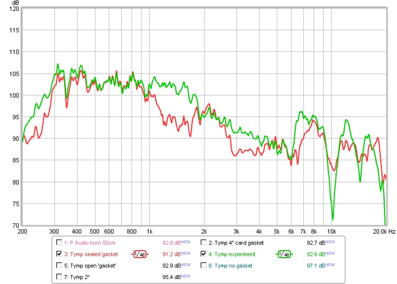

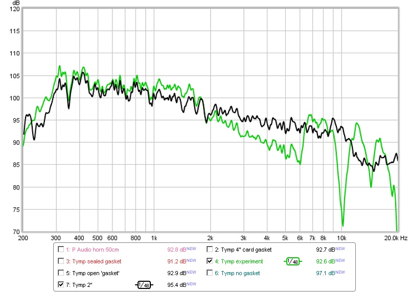

I did some quick tests of the new toys: 4" NE123w-08 and 2" NE65w-04
The 4" isn't made for rear mounting, so it needs a gasket. It seems to be smoother with a leaky gasket, and the response is pretty sensitive to small changes: lots of trial and error needed.
I'm currently working on another horn that may suit it better. If not, I may give up and use it as a typical HiFi midrange.
It does have an obvious difference to my prior 4" drivers: the frame blocks / reflects the HF a lot less, so it is much more extended and intelligible when listening from the back.
The red + green FR plots show it mounted on a 2" throat horn, with different mounting types.
The 2" driver is startlingly tiny. It works nicely on the same horn, with no need for a gasket. The black + green FR plot shows this versus the 4". It sounds good with a bit of eq & some open cell foam (Geddes inspired).
These are full space measurements without eq (just a 200Hz high pass), measured 50cm from horn mouth. Nothing clever done (no windowing, not calibrated with SPL meter, mic is positioned on reflective object).

Thanks @hollowboy for posting the results. I get a similar LP rolloff (-6db/octave) that I was trying to "flatten" or at least extend abit more before it rolls off.
Is there a reason you're using woofers instead of full range drivers? In my simulations, drivers with higher Qms seemed to work better.

The 2" driver doesn't have this much rolloff - a 6dB/octave rolloff would mean a drop of 24dB from 500Hz-8kHz. The FR plot for the 2" (black line) shows only 10dB difference over this range.I get a similar LP rolloff (-6db/octave) that I was trying to "flatten" or at least extend abit more before it rolls off.
10dB gain at the low end of the driver's range is (largely) the point of the horn loading 🙂
With a larger (~4") driver, two additional things you might try to get more extension:
1) in my chart (green vs red) for the 4" peerless, the green goes almost 1kHz further before the rolloff. The only difference is that the green uses a leaky gasket.
I noticed that when I made a cardboard gasket (cut from a cardboard box), I got different FR plots depending on whether I taped up the edges of the cardboard, to seal the corrugations. If I recall correctly, there was something similar in the old Edgar midrange horn articles.

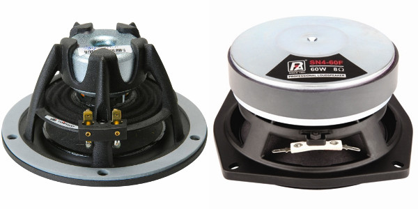

2) My P.Audio SN4-60F drivers have been smoother up to 4kHz than the other similarly-sized drivers I've tried. My guess is that their thicker, stiffer cones that are more suited to horn loading. Switching to these, or something similarly stiff (e.g. PRV Audio 5MR450-NDY-4) might help.
? These Tympany drivers, and other cone drivers I've tried (P.Audio SN4-60F, Fostex FF105WK) are marketed as full range drivers, and their (raw) FR plots support this.Is there a reason you're using woofers instead of full range drivers?
It seems to me that HF response cannot be predicted from TSP.In my simulations, drivers with higher Qms seemed to work better.
1) My 4" P.Audio drivers have a Qms of 1.69 (spec sheet), but they have more flat bandwidth on a horn than the 4" Tymphany (Qms 4.98). This is the opposite of your simulations.
2) One of my P.Audio drivers has a faulty (weak) magnet, but the HF extension of the faulty driver is exactly the same as the others, which goes against ye olde horn lore.

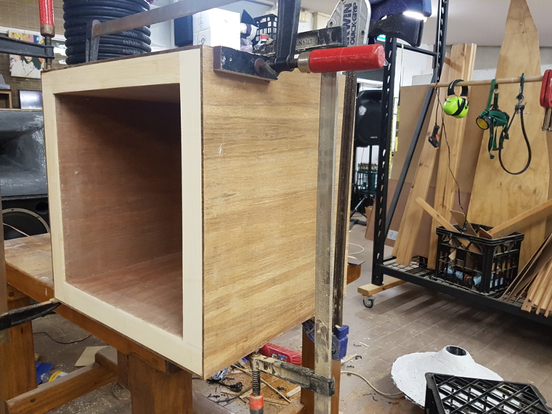

A couple more photos. Hopefully the order I see is the order you see.
Pic 1: modded horn, mounted in cabinet (50x70cm face).
Pic 2: ditto, still in progress but looking better - smoothed curves and less hideous paint.
Pic 3: this other project is what I'm considering for the 'skin'.*
Pic 4: the stock horn, with a JBL 2445 driver and boots for scale.
*the pale front = wide grain natural bamboo, the darker exterior is strand woven carbonised bamboo, both 5mm thick ...and the white thing on the floor is a cast for yet another horn 🙂
Ima have to find my 'real' camera for this. The bamboo is more pretty than I can show with a phone camera.
