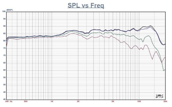

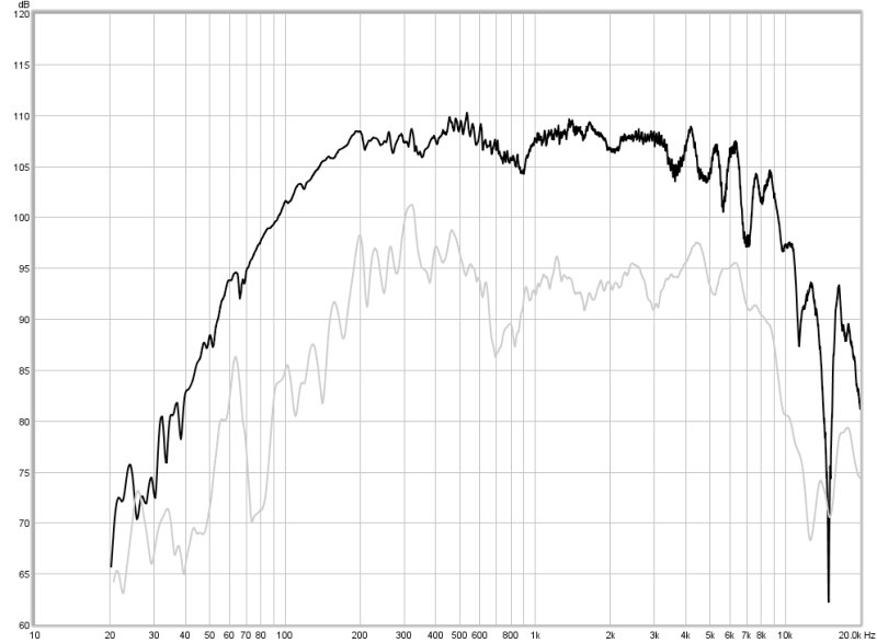

Next time I'm in the workspace, I'll [...] do a comparison of the tiny driver vs the JBL 2445 (which is fairly close to being the loudest thing you could attach to a 2" throat) on the same horn, same amp settings, etc, to get an indication of their relative efficiencies.
I did this, attached.
As a narrow band device (1 to 5kHz) the JBL is about 10dB louder, so 15dB more sensitive (16ohm vs 4ohm).
If you applied subtractive eq to make the JBL flat 500Hz-10kHz, it would be only 5dB louder, or 10dB more sensitive.
