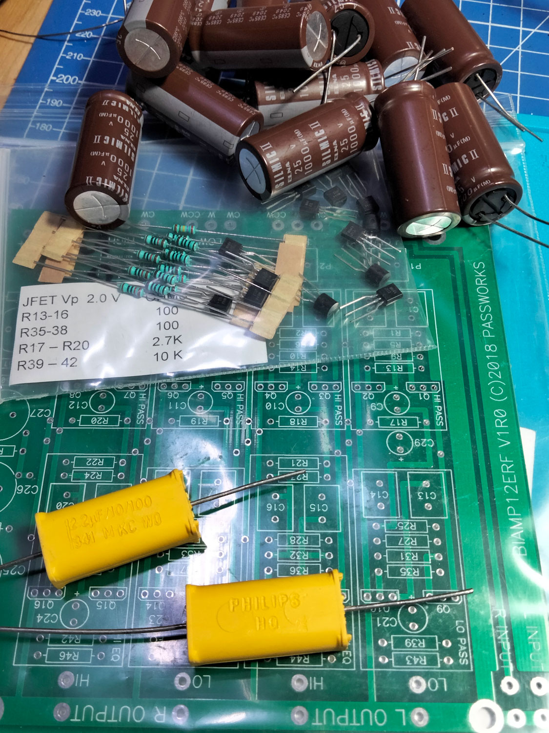

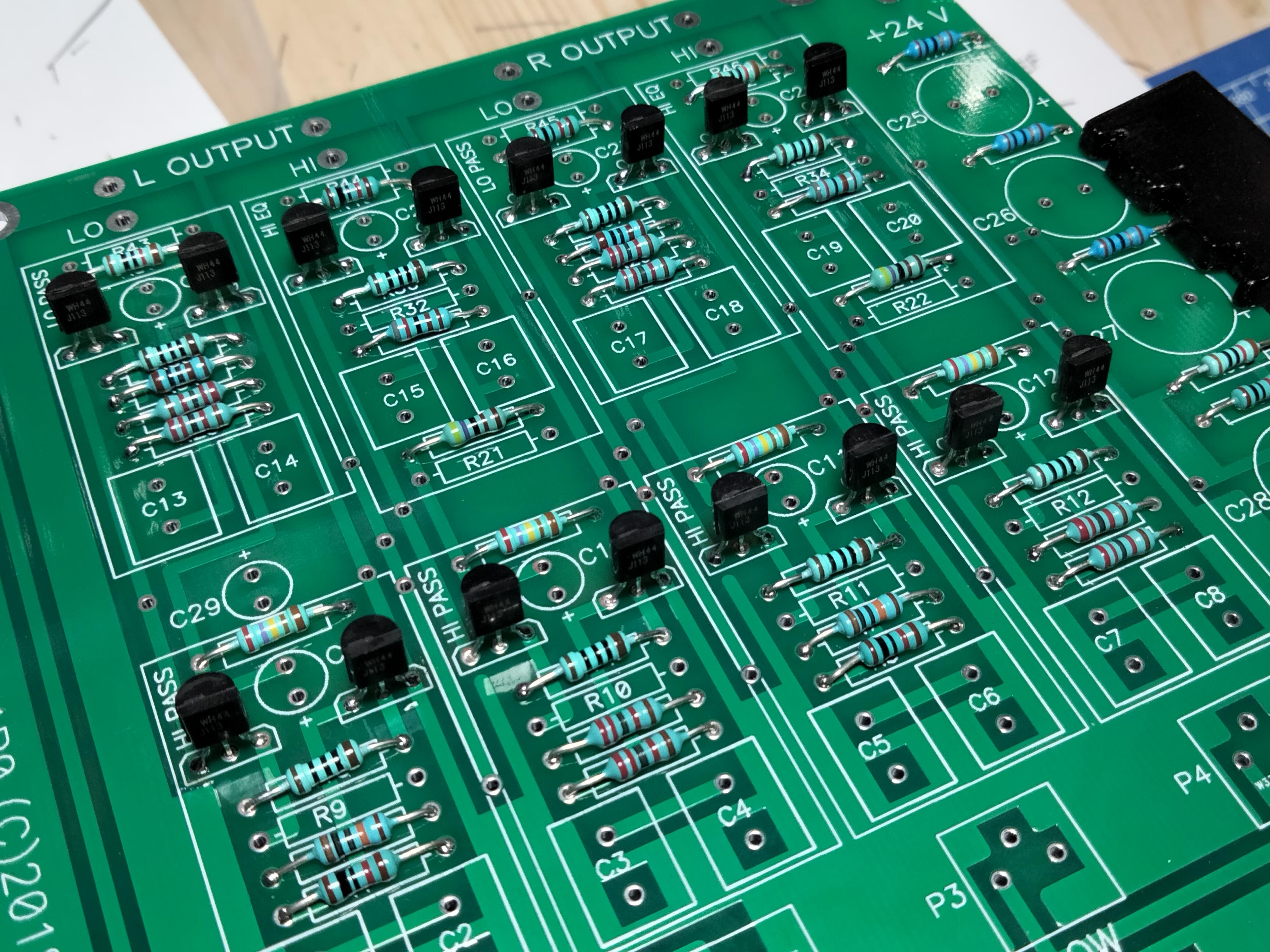

I'd like to put two potentiometers in front panels instead of trimmers for bass, as seen on B5, in order to allow regulations "on the fly". It would be better to use log pots? I thought to CTS... Can I replace P2 and P4 with a fixed 25k res in parallel with input?
