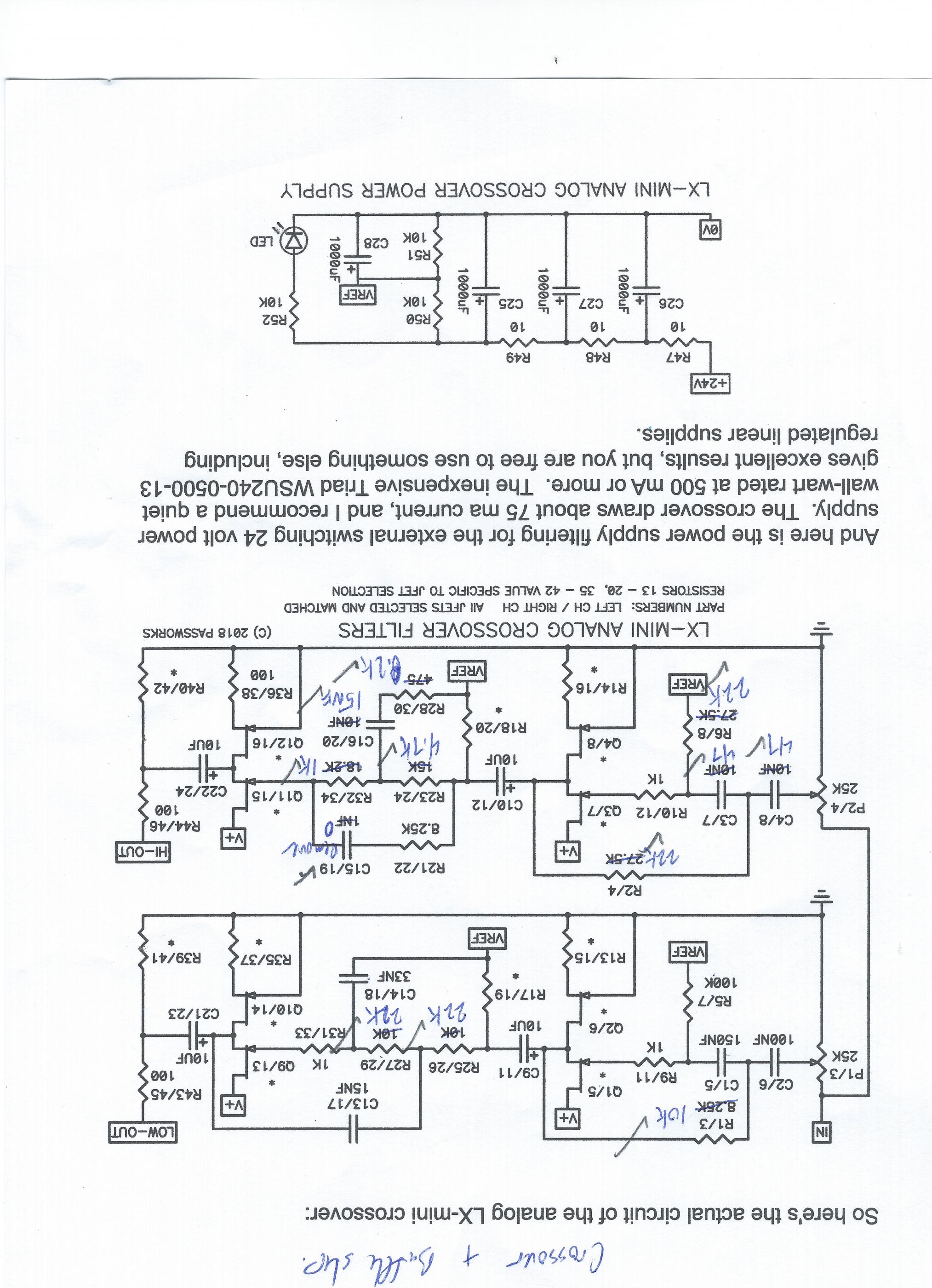

Here's the info on my ACN/LX Mini set up for Papa's SLOB.
I've attached two documents- (no idea why they are upside down- saved correctly.)
1. The ACN crossover schematic with updated values hand written.
2. The file of the crossover slope with updated values on the right, but it is not a complete schematic. Use the complete schematic with the hand written values.
Schematic changes from original values-
For the low pass-
R1/3 to 10K ohm
R25/26 to 22K ohm
R27/29 to 22K ohm
For the High Pass-
C4/8 to 47NF
C3/7 to 47NF
R2/4 to 22K ohm
R6/8 to 22K ohm
C15/19 removed/left open
C16/20 to 15NF
R23/24 to 4.7K ohm
R28/30 to 8.2K ohm
R32/34 to 1K ohm

Thanks wg45, that's really useful.
I see you are using a Lii 8in full ranger but can you remind of the bass units your using?
I'm working on a Pass SLOB project myself and plan to eventually use the ACN/LX mini crossover for the bass element but I plan to use no crossover for the full rangers, instead achieving the roll-off by bandwidth limiting the amplifier that will drive them.

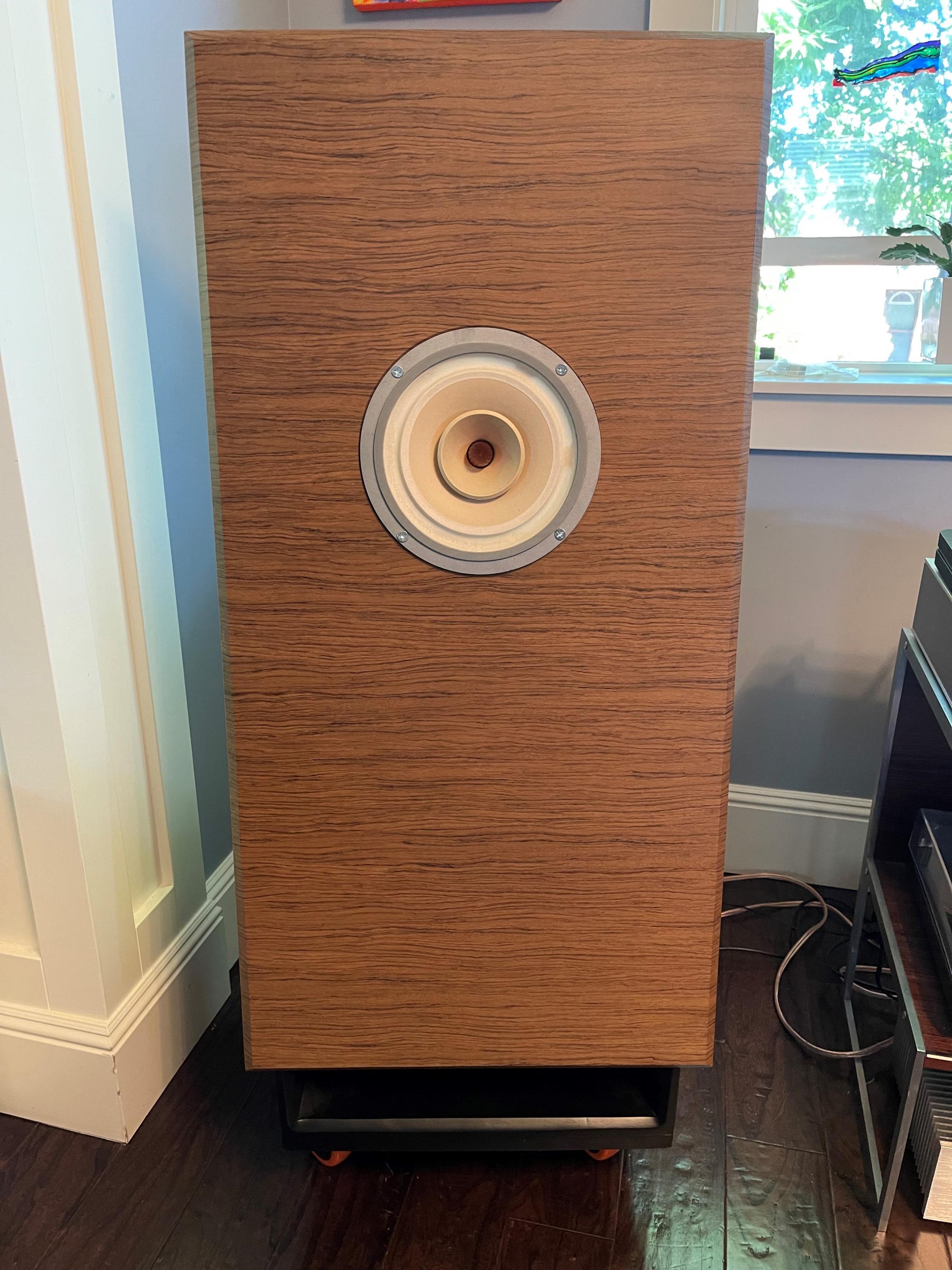

Superb! Could you take a photo of your actual SLOBS?
:cheers:

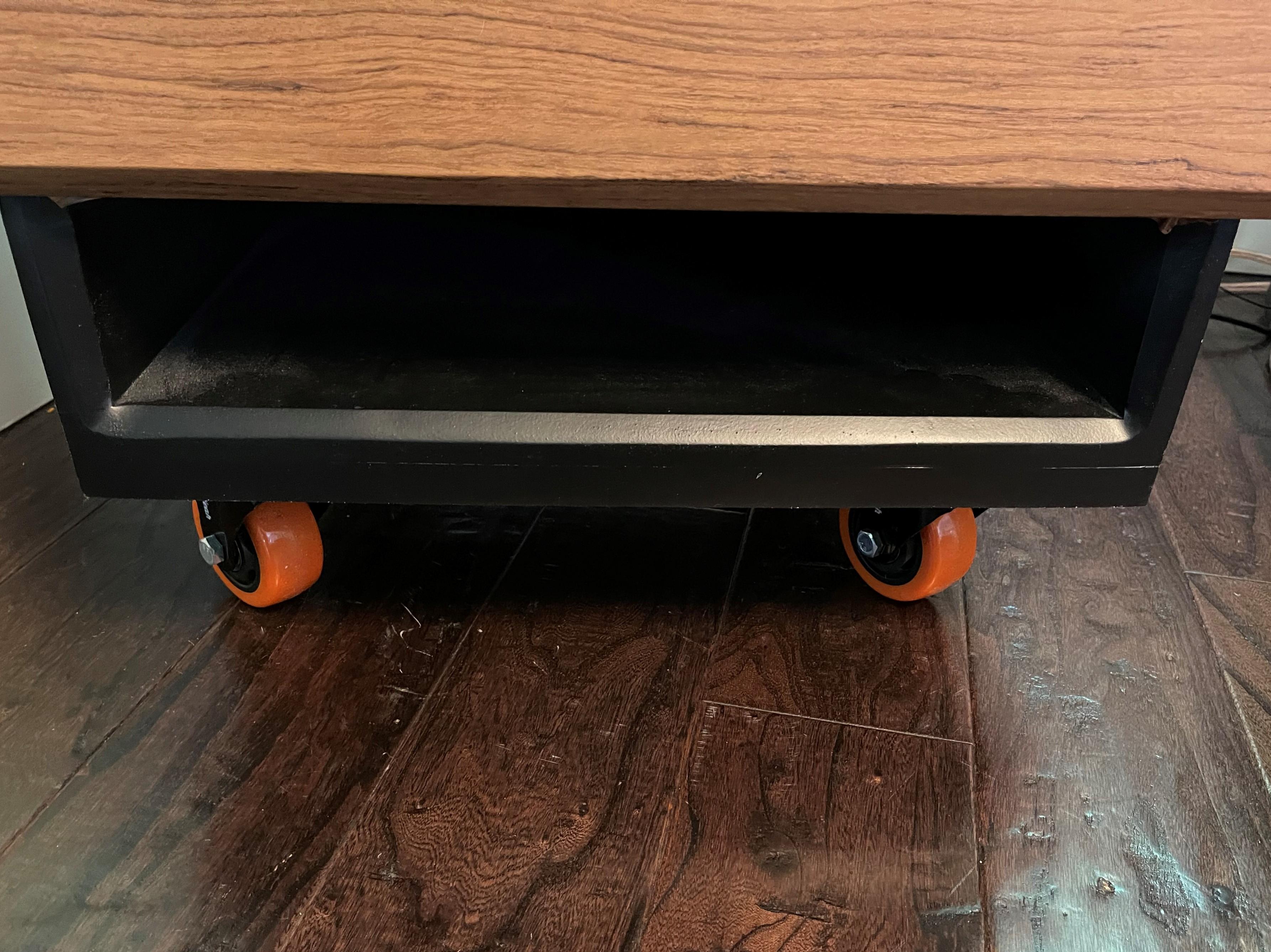

Sure, here's a few photos. I added casters on the bottom of the speakers. I liked how my Zu Audio Druids had the FR driver at seated ear level. My thinking is that adding the casters raises the height slightly and makes them easier to move around.
If I was to make another baffle, I might make it slightly taller.

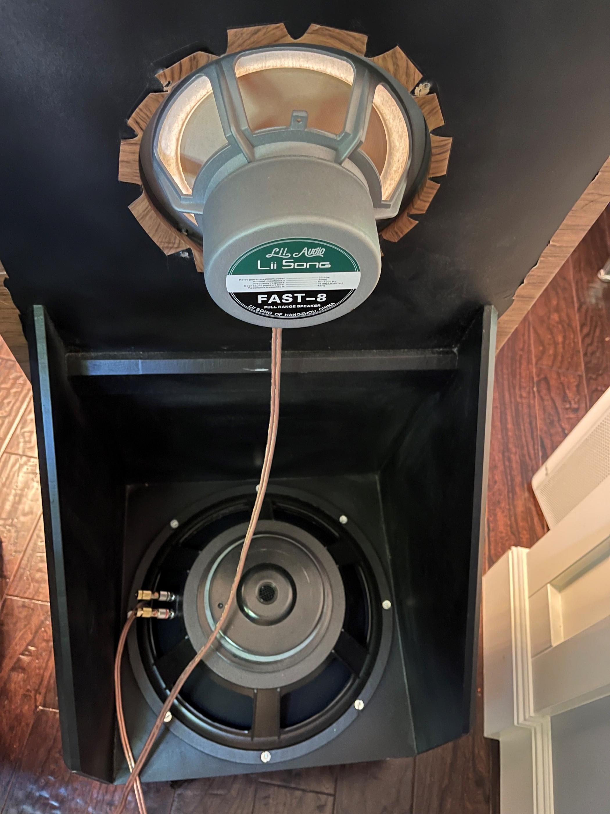

The 15" woofers are Augie 15's. I think Papa recommended the Eminence Defimax. Any good 15" woofer will work.
The more critical driver is the FR.

Papa did say I was going to need multiple baffles and he's right. One change I would make would be to have the front baffle be removable or replaceable, without too much effort.
I've used two different 8" FR drivers and they are slightly different footprints but I made it work. They next one may not fit or I might want to use a 10". Having an easy way to change the front baffle would be smart.
