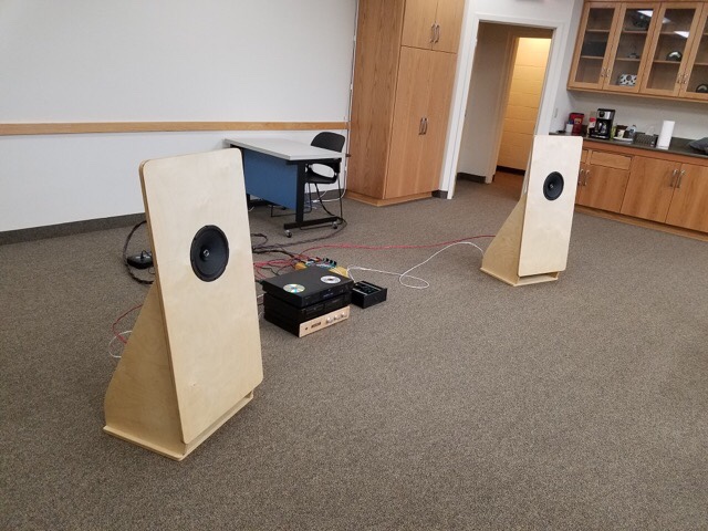

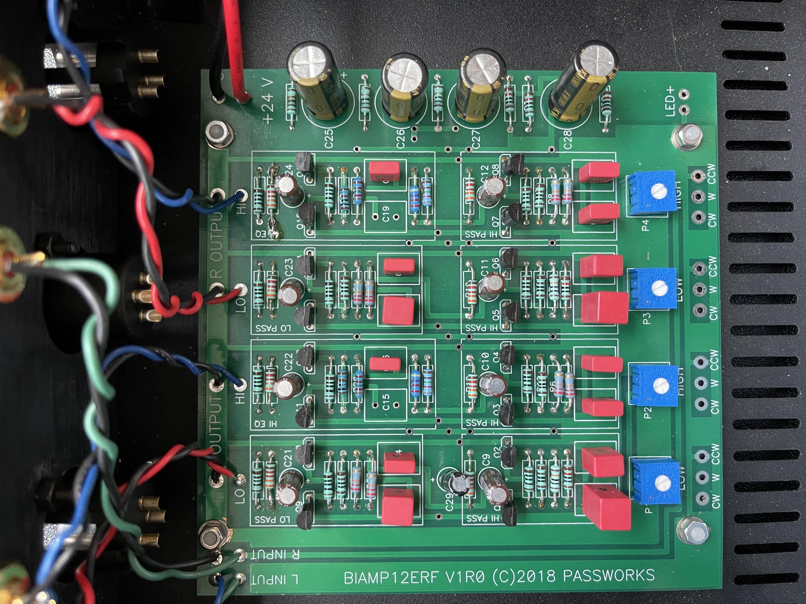

Project update- I bought an ACN crossover from a diyaudio member. With help from another member I was able to set up the crossover for about 150hz. I'll add some sockets to the low pass resistors and try some lower crossover values and see how they sound. Low pass is out of phase to the High pass.
There's a noticeable difference between the ACN and an older opamp based crossover I was using. Thanks to Papa and the Diyaudio members who helped.

I’m using a B5 for crossover duties. Still playing with it. It’s currently set to about 300Hz.

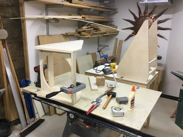

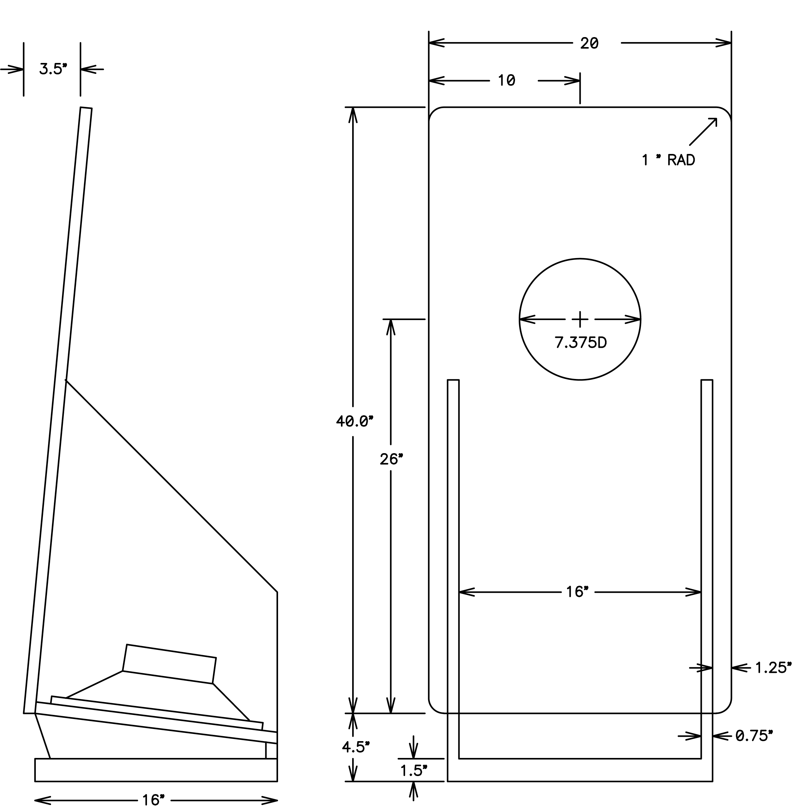

Attached is the file I used as a starting point.
Link to the thread that's helpful-
Pass Open Baffle
If you do some reading and searching, you'll find more info. Papa wrote an article about the "big" open baffle speakers with 6? woofer drivers. That speaker has much more written about it. It can get a bit confusing figuring out which speaker people are commenting about.
The pair I built in the attachment are much smaller with one woofer per speaker. I went for the WAF. (And it was cheaper.)
Pass Open Baffle

Mine are crossed at 150Hz. I'll have to try a higher value and see how it sounds.

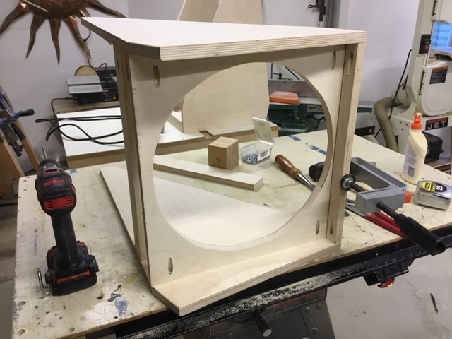

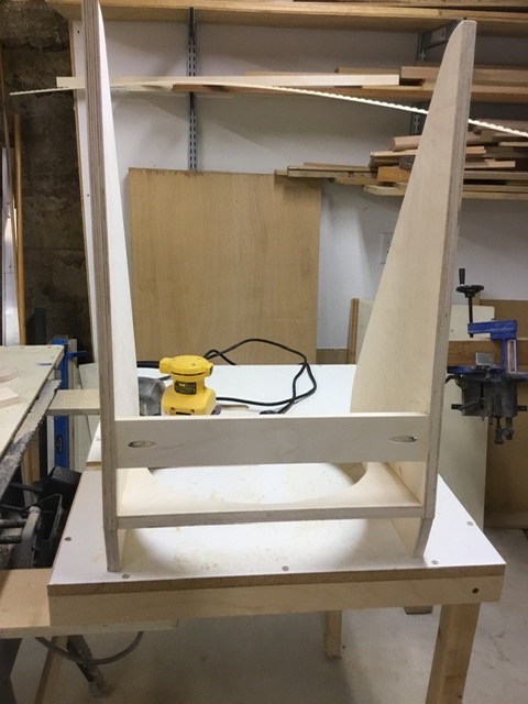

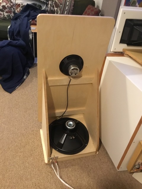

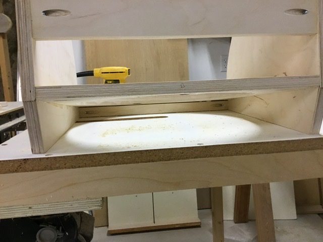

Since Jim, 6L6 likes pictures.
Pass Open Baffle
Very cool!
Thanks.
WG45, be carefull with higher frequenz for the woofer. The slot loaded woofer may have a resonance between 200 and 300 Hz. Better first to measure the woofer by itself. I guess Nelson choose intentionaly the 150 Hz.
I think in a way the slot loaded woofer behaves similar (but not exactly) to Ripole loading and as such should not be crossed over higher than 150Hz.
The Ripoles also use a dedicated trap circuit, but it may not be required here. Only listening and testing will tell you.
Member Rudolf is a good source regarding Ripole info.

Very nice. I guess that these should be active/biamped since the 8" or 10" fullange will be much more efficient than a single 15" bass (which will struggle a bit if you want to play loud).
That said, I remember that Nelson has also tried a passive 1st order crossover with this OB (just a big 20mH inductor and a capacitor). Anyone else tried it?

Thanks for the comments. Yes, I'll take it easy when I try the higher frequency crossover value.
I have only tried the crossover at 150Hz and I'm very happy with the current sound. Being a fearless amp builder, it should be worth the experiment to see if 150Hz is the right spot or if higher is better.
I do use the external LX Mini/ACN crossover and the drivers are bi-amped. It's no problem to fiddle around at low volumes with the woofers.
