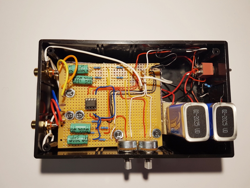

In looking at the schematic I realize there are no supply decoupling capacitors on the op-amp pins, you need to add 0.1uF (ceramic cap) from each supply pin to ground in order to assure stability. Not sure about your grounding arrangements, but needs to be low impedance enough to work, fortunately the 4558 isn't too fussy.

To your question about the voltage polarity to the cartridge, these cartridges have opposing polarity outputs so inverting one relative to the other is necessary, generally it is done with another stage or as is done here the supply voltage polarity is inverted.

To test the pre-amp you can either plug the cartridge in or connect a 1K resistor across the inputs - you should see somewhere around 3V.
To confirm ... Thats 3 volts ... Not 3mV (spec from panasonic)
Check to make sure your RCA shells are actually connected to the circuit ground, it sounds like something is open.

The op-amp should be fine, not my first choice but adequate for experimentation. (May or may not be a bit noisy)
To confirm ... thats 8x capacitors? ... (you mention "Supply pins")
. Not sure about your grounding arrangements,.
I set the battery connections up as per the attached picture ... which should be as per Schematic ....
On the other Pic of my board ... Top RHS (near switch) You can see the setup of connection >> 3 lines of wires << i set it as per .....
>> RED = Pos <<>> White = Earth <<>> Black = Neg
