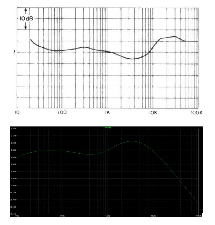

See the attached picture below. I have actually measured a couple of my cartridges and they closely match the frequency response shown in the upper graph from a long ago review in Audio (August 1974) - unfortunately I have misplaced those response measurements.
The graph below it is the response of my most recent EQ which I am finally happy with. (It only took 8 tries lol)

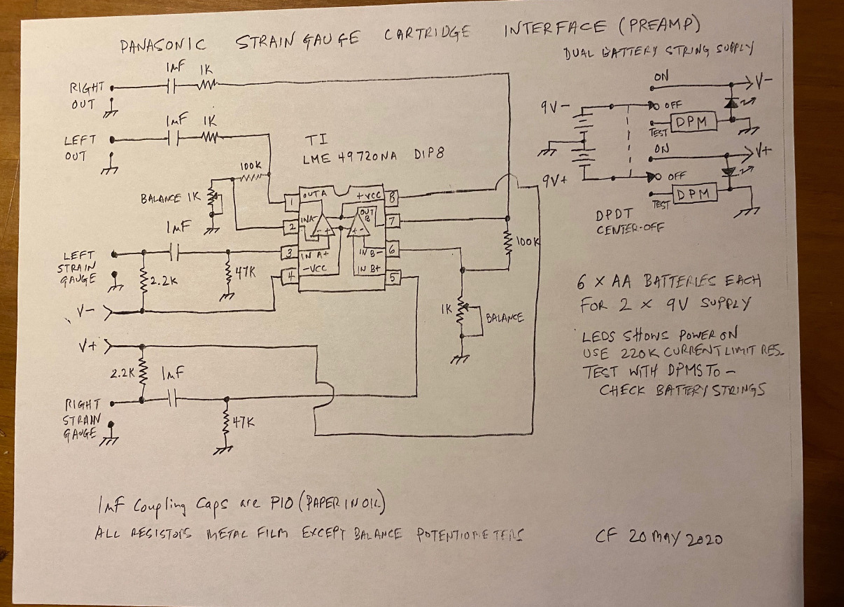

Attached is a simple way of doing the basic cartridge interfacing. No EQ on this. Done by a member on VinylEngine. Nice as its in the 'junk box' territory for being able to knock up for an experiment.

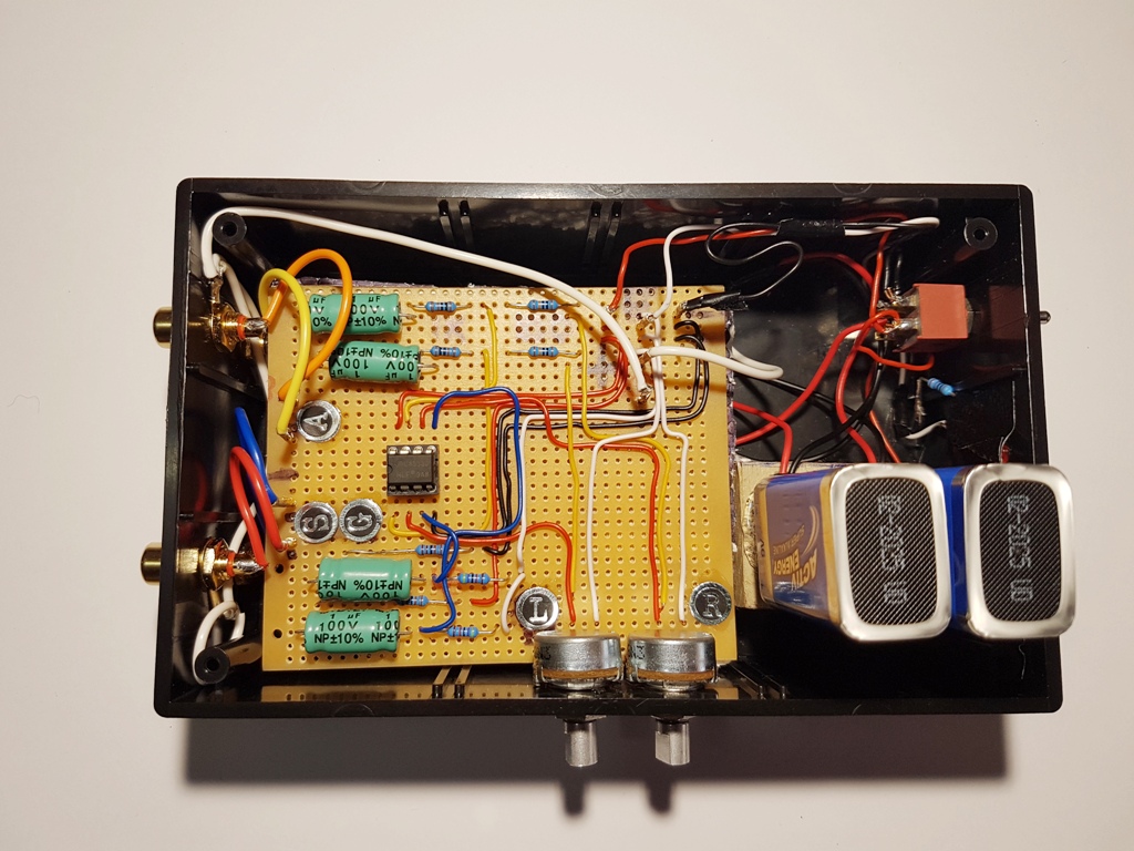

I received the Panasonic EPC 451c and have built the pre-amp
As this would be the 1st time i have ever soldered up a complete board design ...
( i would be in the beginner, novice category (Usually do minor repairs only))
I chose to go with the pre-amp design as per the diagram by Chris.
Like to thank / acknowledge CD for the easy to follow design.
I built it exactly as per the schematic ... and this should reflect in the position of parts and wires on the board.
I made some changes to suit being ....
Dual 9v batteries (Dual 6x AA's spec'd)
1K resistors for the LEDS (220K was spec'd)
Deleted the DPM ... in lue of exposed, removable battery's
Standard Caps ... 1uF non polar ... (No PIO caps available)
Using OpAmp KA4558 at the moment << (it appears to be fine) ... Waiting for LME49720NA ... 6 weeks delivery time from the USA.

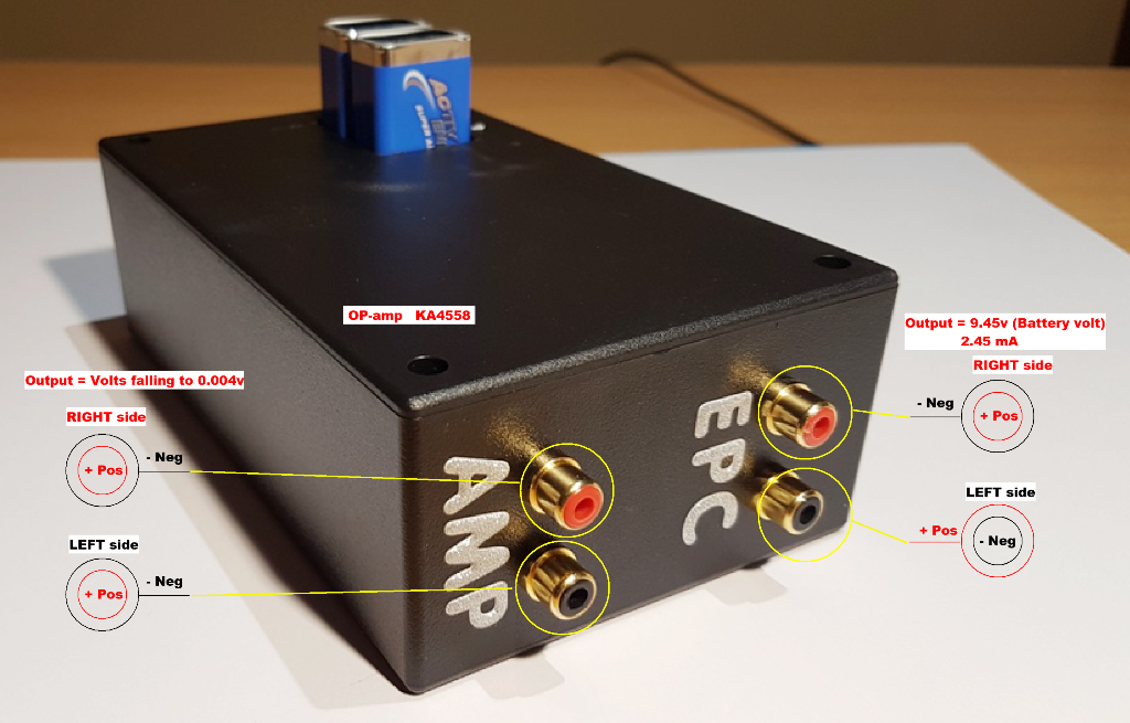

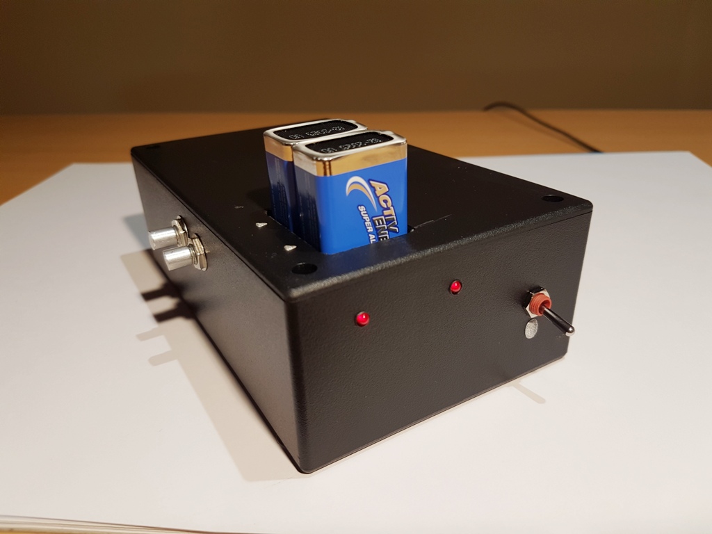

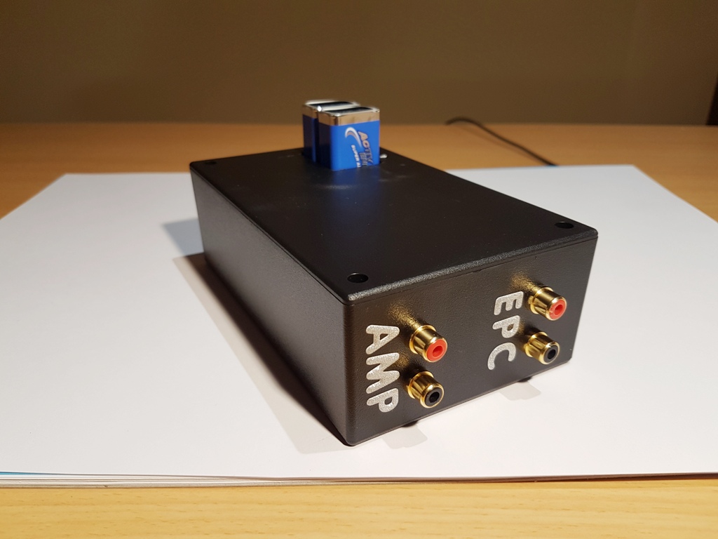

Attached are some pictures of the setup ...
I have some questions
STRAIN GAUGE CART
Panasonic EPC 451c is described as 1000 Ohm's.
I measured the resistance on both sides ... and got the following results
Poles >> GREEN - RED = 691 Ohm's
Poles >> BLUE - WHITE = 764 Ohm's
Is this correct? ... could someone measure their EPC 451c to confirm please.
OPAMP>> OpAmp KA4558 ... I have attached a picture of it's schematic ... Connections OK?
PRE-AMP
I have not connected it to anything just yet .. and am testing the AMP and EPC connections with a multi-meter to confirm that all is fine.
(in one of the pictures i have marked up the results)
AMP side .. (Refer to picture) .. comes up with correct polarity .. along with 5 volts & falling ... Also .. 1.6mA showed up.
It seems good to connect to a main amp ... however .. Is there another method of test i can do?
EPC side .. (Refer to picture) ... RHS has correct polarity .. all looks fine <<>> However ...
>>> the LHS ... polarity is reversed. (Following the schematic >>> LEFT STRAIN GAUGE)
Is this the way it was intended? <<>> or i should correct this via >> just reverse the LHS connection by putting Earth to the Centre Pole and Negitive to the Outer Pole.
Voltage and mA wise ... both Left and Right show up 9.4volts and 2.5mA ... which is basically the Battery Volts / mA's
How can i test ? ... to ensure that the Voltage is good to go for the EPC 451c ? ... and NOT burn out the Cart.
(what am i missing?)
Any added advise please.
Cheers
Mike
The cartridge resistance varies significantly from sample to sample. I've seen resistance values in the low 600 ohm range to 1K depending on the specific cartridge.
To test the pre-amp you can either plug the cartridge in or connect a 1K resistor across the inputs - you should see somewhere around 3V. (It's not critical)
The cartridge is not very electrically fragile so as long as you are reasonably careful you should not have a problem.
If you want to implement EQ, my latest design will work with this pre-amp, but you will need to add a second op-amp on each channel to boost the gain back up.
Thats a wide variation from Spec ...
I added the 1K resistor .. and it still maintained 9v ...
Either something not right ... or the Opamp is not suitable.
as per the method principal of the picture >> I did a Test of reducing a 9v battery by connecting 3x 2.2k resistors and achieved 3v .. unsure of the problem at this stage.
I thank for your knowledge on this subject .. and for your design ... will need to sort out the above first
To your question about the voltage polarity to the cartridge, these cartridges have opposing polarity outputs so inverting one relative to the other is necessary, generally it is done with another stage or as is done here the supply voltage polarity is inverted.
Check to make sure your RCA shells are actually connected to the circuit ground, it sounds like something is open.
The op-amp should be fine, not my first choice but adequate for experimentation. (May or may not be a bit noisy)
