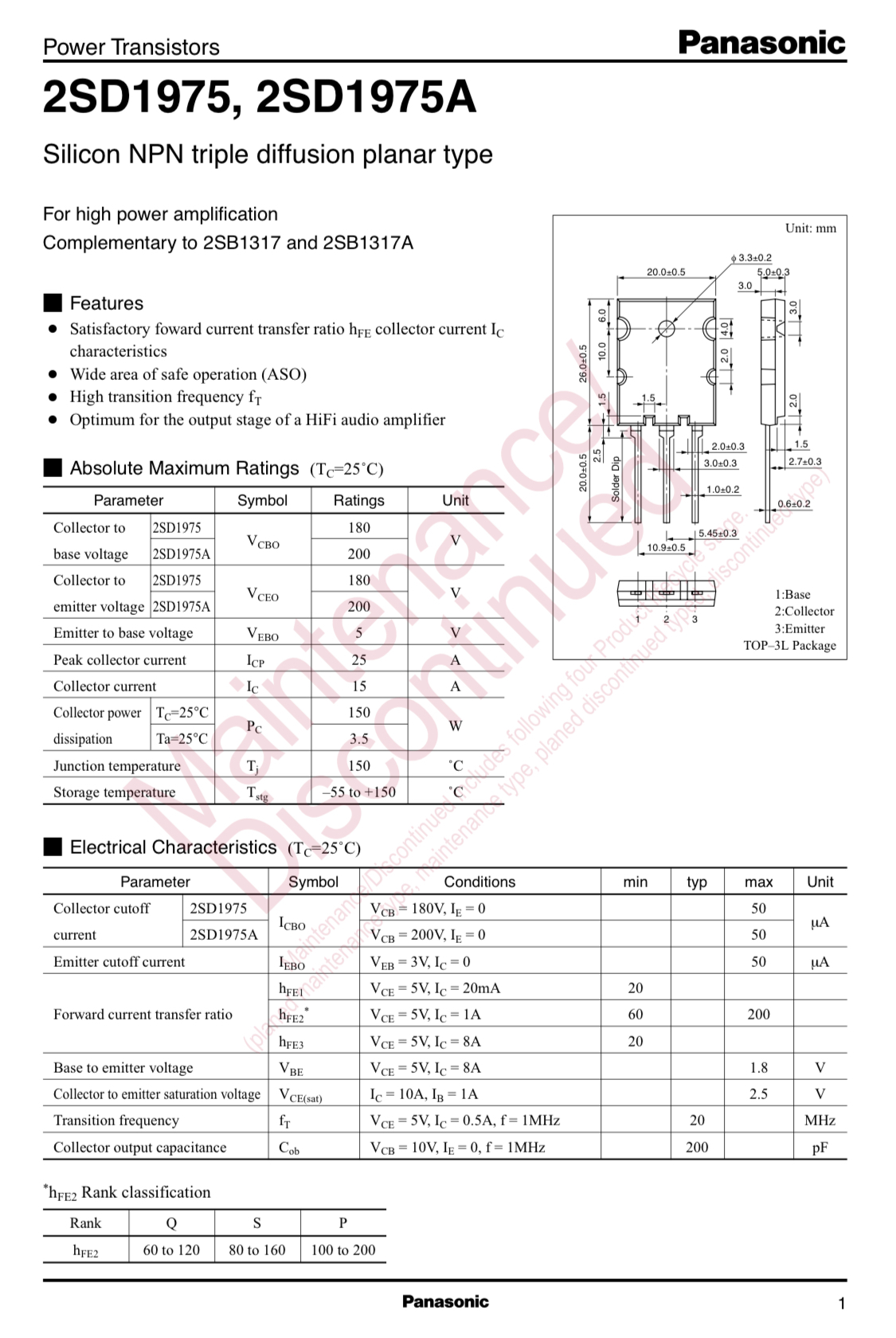

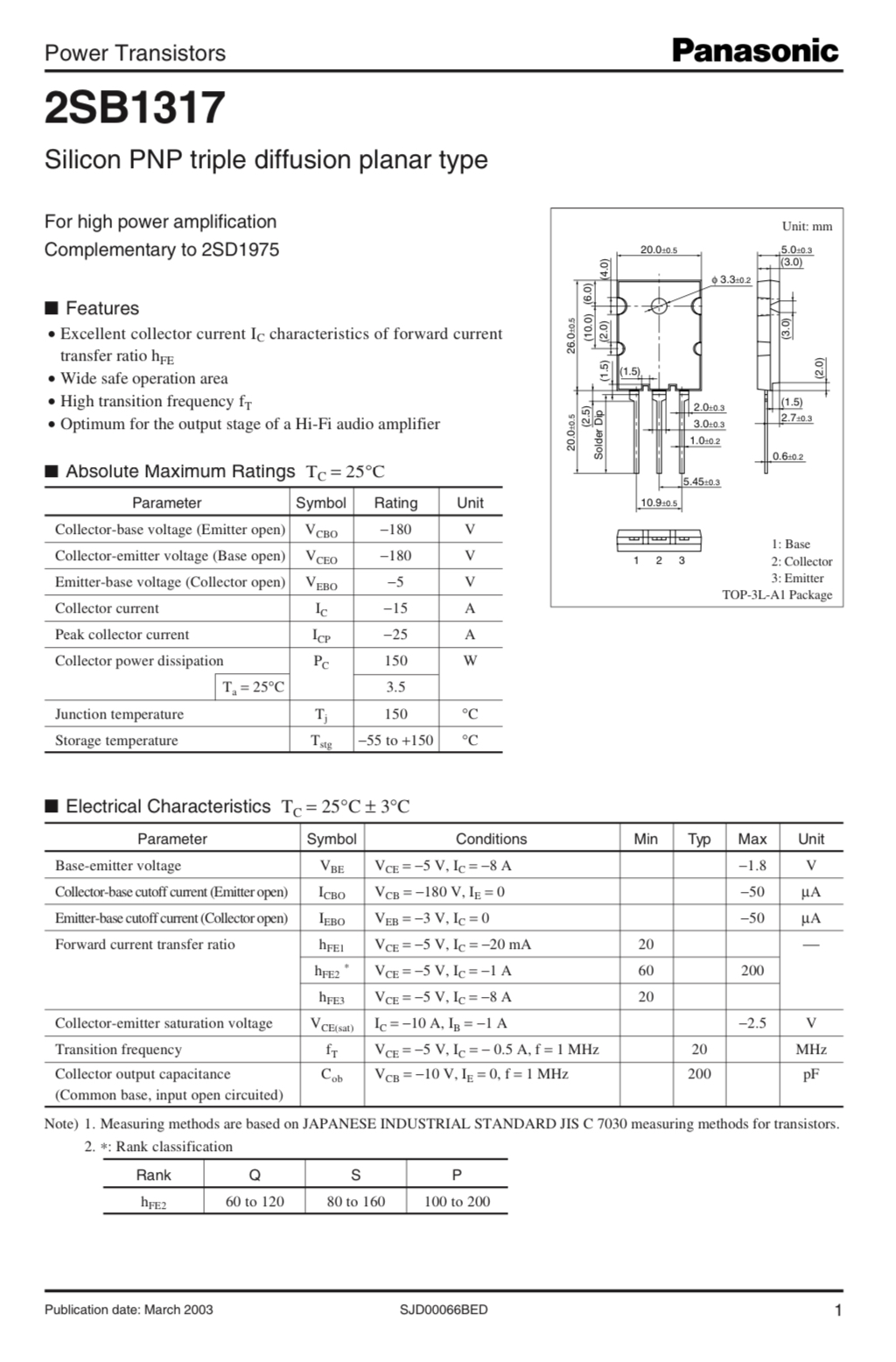

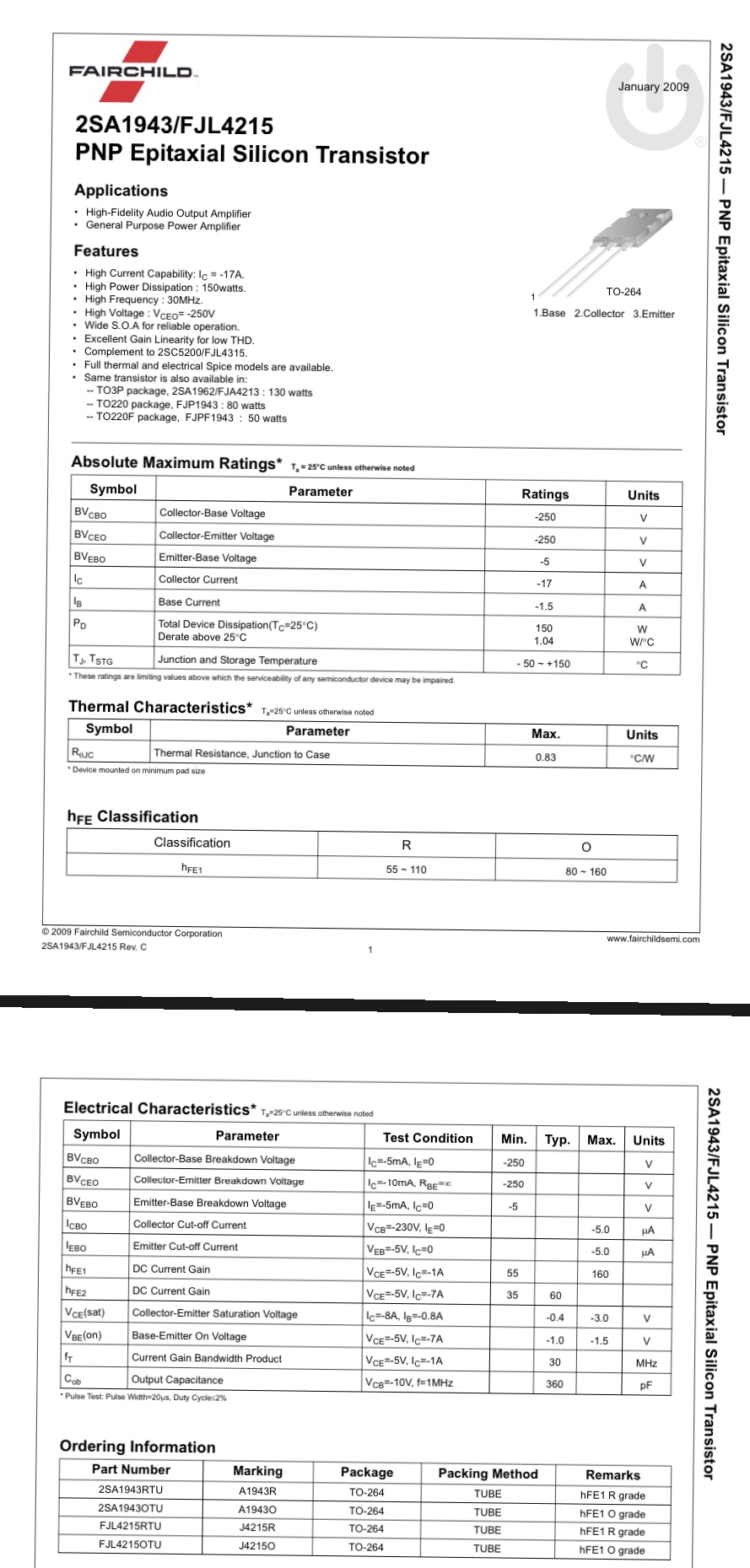

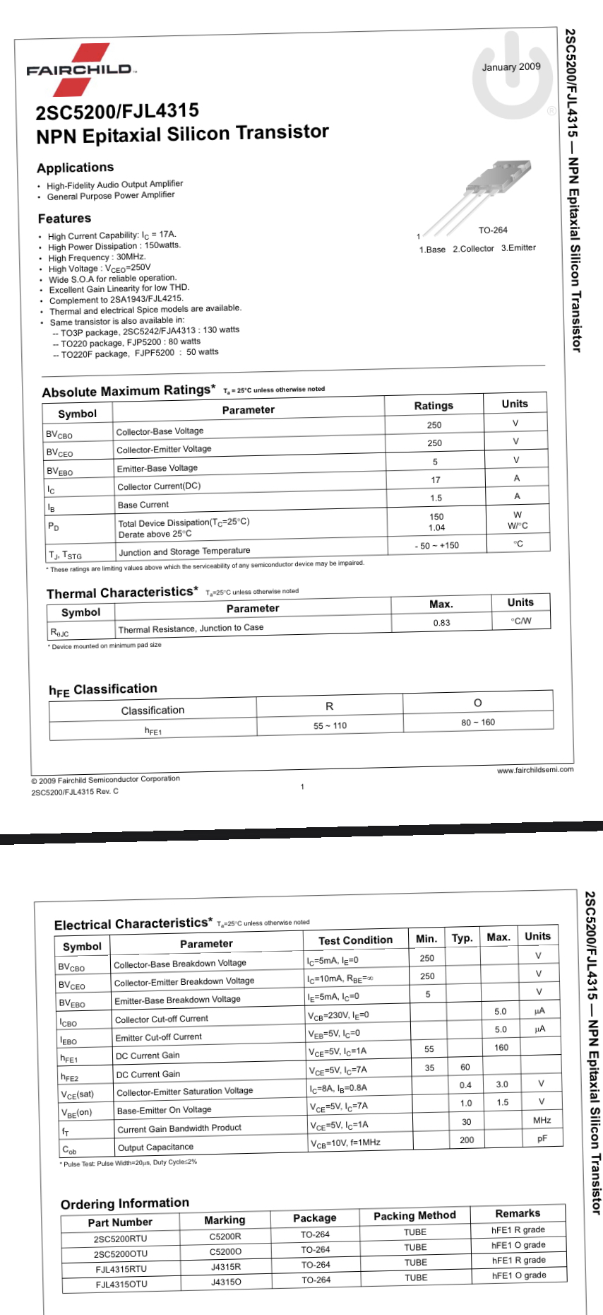

Any recommendations for replacing 2sd1975/ 2SB1317?
(Need to replace all)
Been looking and looks like 1943 / 5200 from ON/fairchaild could be ok. Although freq is at 30mhz instead of 20mhz. ONs are hfe 80, also a version with hfe 50. Not sure what to choose. What difference does it make here. Can’t find exactly what hfe the Panasonics have.
Can i keep everything else the same? Right now res are 0.22R. Bias is recommended to be at 8-10mv
Same with new ones?
Would be nice with just a swap.
Pinout should be same too and to-264 also.
Thx for help

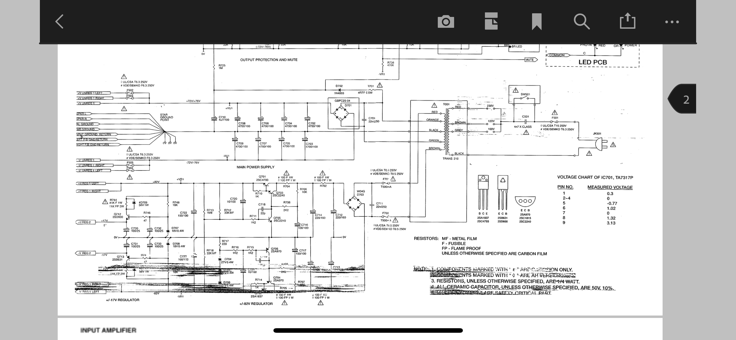

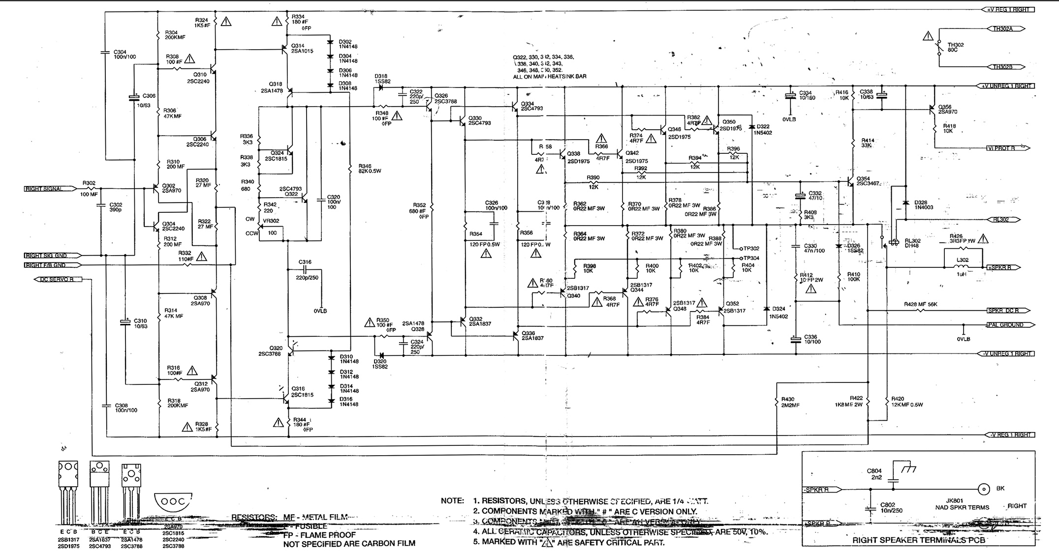

A circuit drawing could be of tremendous support here...
Also, datasheets (screenshot may suffice) of D1975/B1317 are welcome.

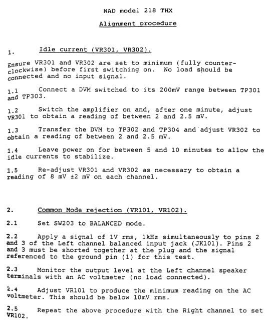

Bias... 8-10mV???

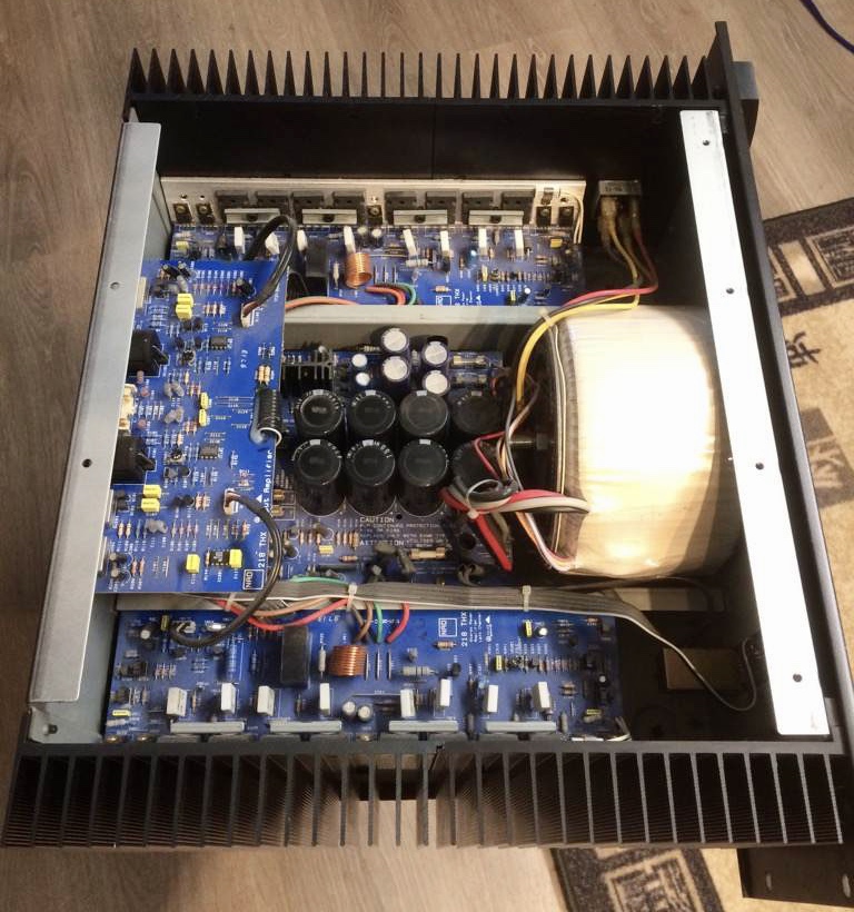

Nad says in the manual that bias should be set between 8mv (+/-2mv) and that what i can see the Panasonics are To-264 package mounted to chassie on big heatsinks (whole chassie basically can cool them down)

Nice solid circuit. Lots of stages though.

Yes. Both teams are ok for the job. 5200/1943 I consider better. Beta is up to 100, so less demand from previous stages. Check Ccb recommended.Can I keep everything else the same?
Yes. Initial warming up is with a 10mA setting, then increase to 36mA per branch. Warming up is at 0.75W, operation at 2.7W per bjt.Right now Re's are 0.22R. Bias is recommended to be at 8-10mV. Same with new ones?

Indeed. Pinout is the same.

With 10mA or 8 i mean at the testpoints pointed out in the manual.
Isn’t then 10x8bjt=80mv per channel?
The 4 pairs of bjt are on heatsinks and think only c3788 and 1493 is mounted on the board.

I'm talking mA, not mV.With 10mA or 8 i mean at the testpoints pointed out in the manual.
Alignment says 2-2.5mV (10mA) initial warming up.
Then readjust to final setting 8+/-2mV (~36mA).
10??? No, there are 6 junctions in series. This applies to the total biasvoltage set with VR301-302.Isn’t then 10x8bjt=80mv per channel?
That's ok for me, though I expect Q321-322 (& poss Q323-324 also) on the grill. Temp stabilisation!The 4 pairs of bjt are on heatsinks and think only c3788 and 1493 is mounted on the board.

...Then readjust to final setting 8+/-2mV (~36mA):
[8 - 10 - 12 ] mV / 0.22Ω => [ 36 - 45 - 55 ] mA
Given Vps = +/-72<>76Vdc, say +/-75Vdc, Pdiss:
Pd = 75 * 45m = 3.4W
That's for the two channel amp 54W central heating.
Say 100mA idle dc current per channel, that's 80mW classA drive.
Approx 0.3% classA efficiency, so definitely a class AB amplifier.

When you say central heating 54w do you mean the 72/76v supply? The 82v unreg is not important here?

So basically it seems like its quite easy to replace all trannies with 5200/1943 (basically plug and play)
