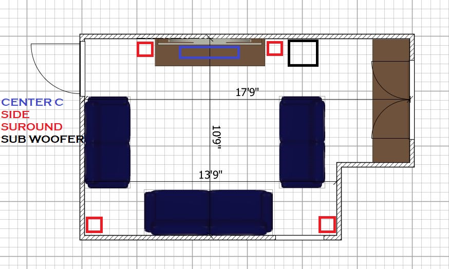

Use as home theater setup, mainly for music and movies."better" depends on what you are trying to do ?

Okay if I have to stick to single tweeter which will have lest issue with dispersion.
For woofer I am picking up 4 x HiVi B3N in parallel.
