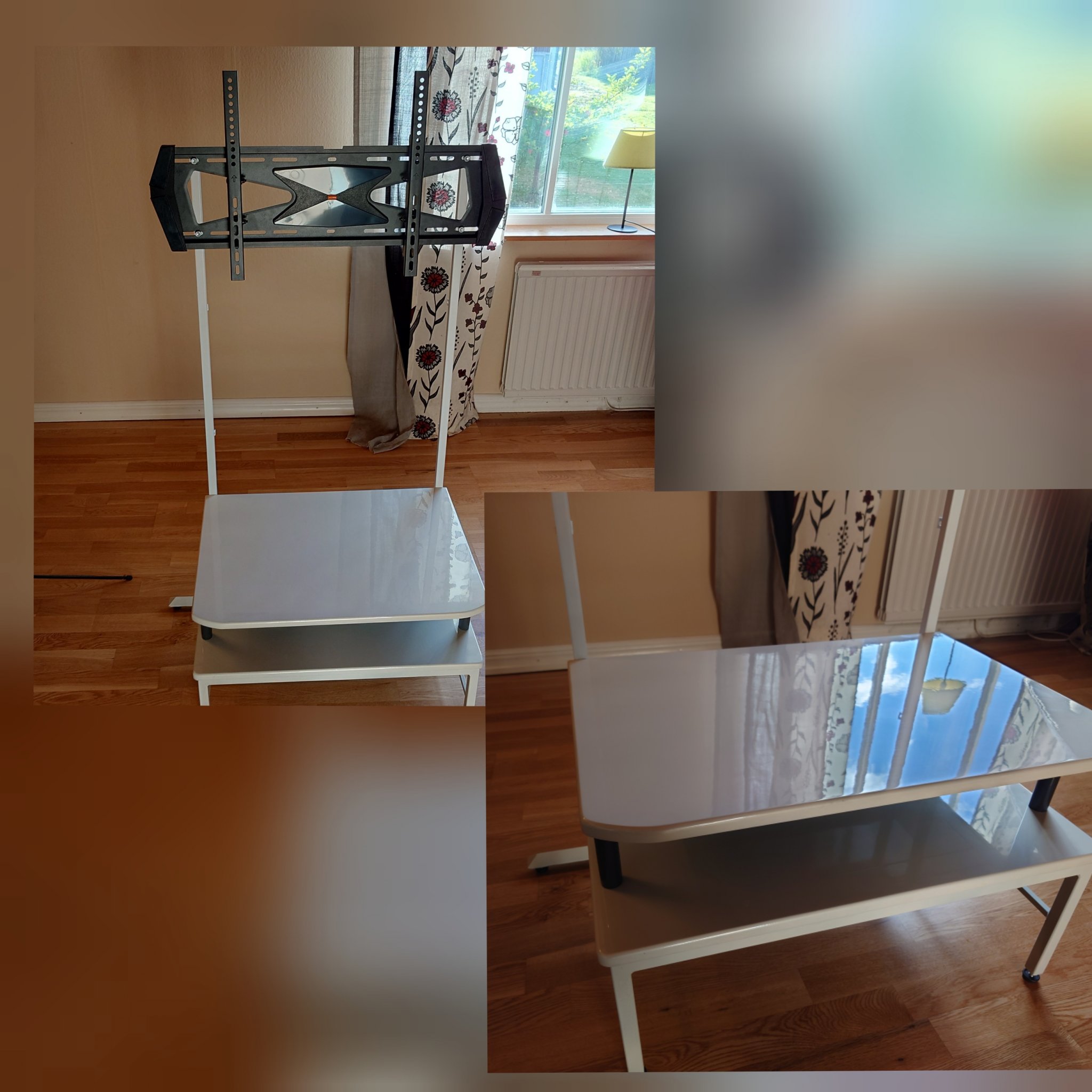

I just finished fabrication and painting of my new TV/stereo bench, one rattle can of automotive 2K filler, it really can't be any easier (if you have a ventilated area to paint in). Just make sure to look at the edges, you might have to let the first layer cure to be sanded lightly before you lay down the final coats (as long as the can stays somewhat cold you'll have almost a day to use it).
