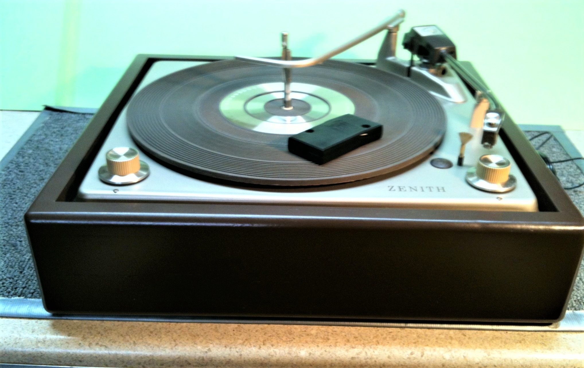

I recently fabricated a wood base for a turntable I wanted to sell.
Wood recently has become hard to get in the right sizes and grain patterns, so I opted for painting.
I used the Rust-O-leum dark brown satin for the finish and it came out quite nicely.
Of course the photo doesn't do it justice.

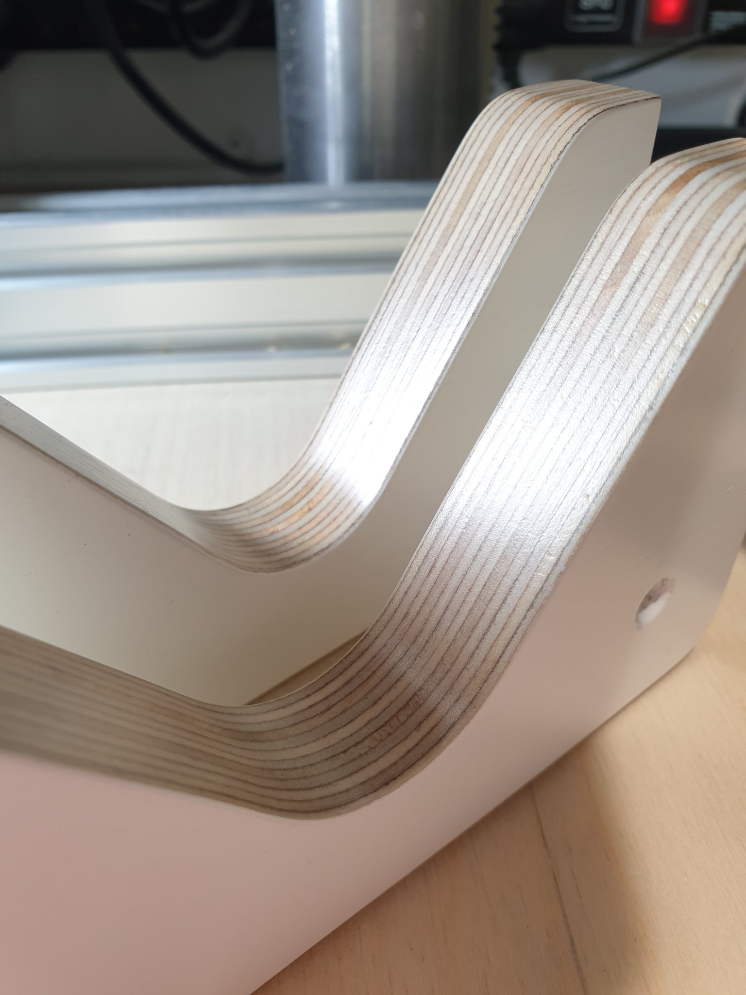

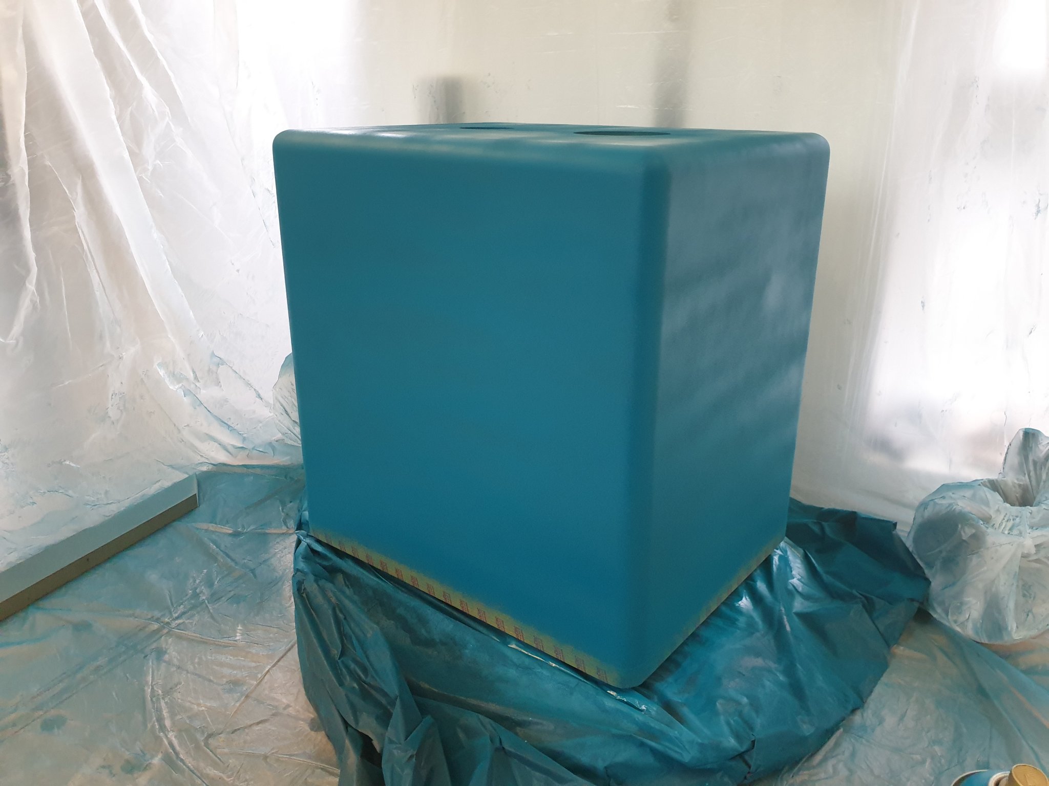

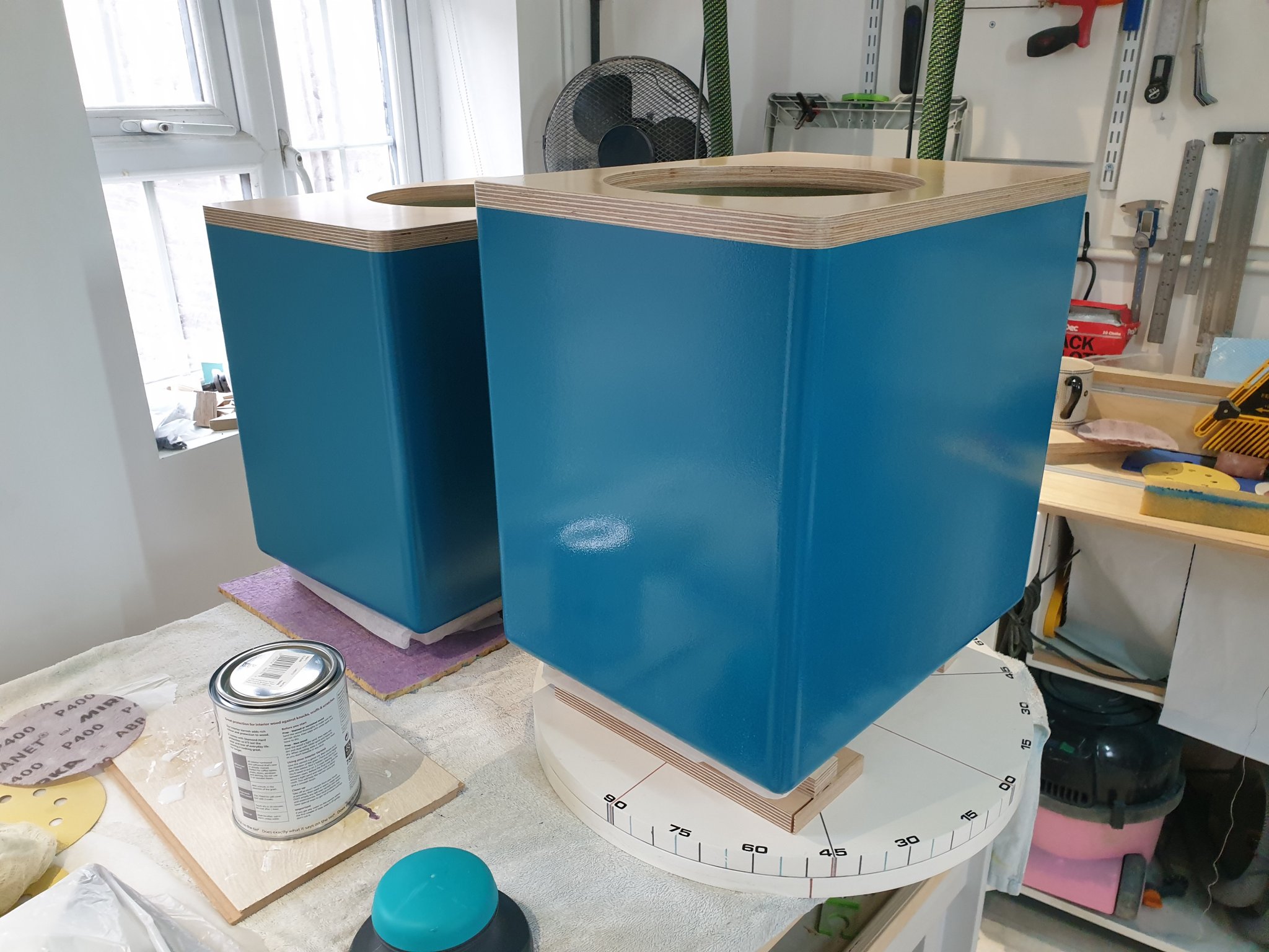

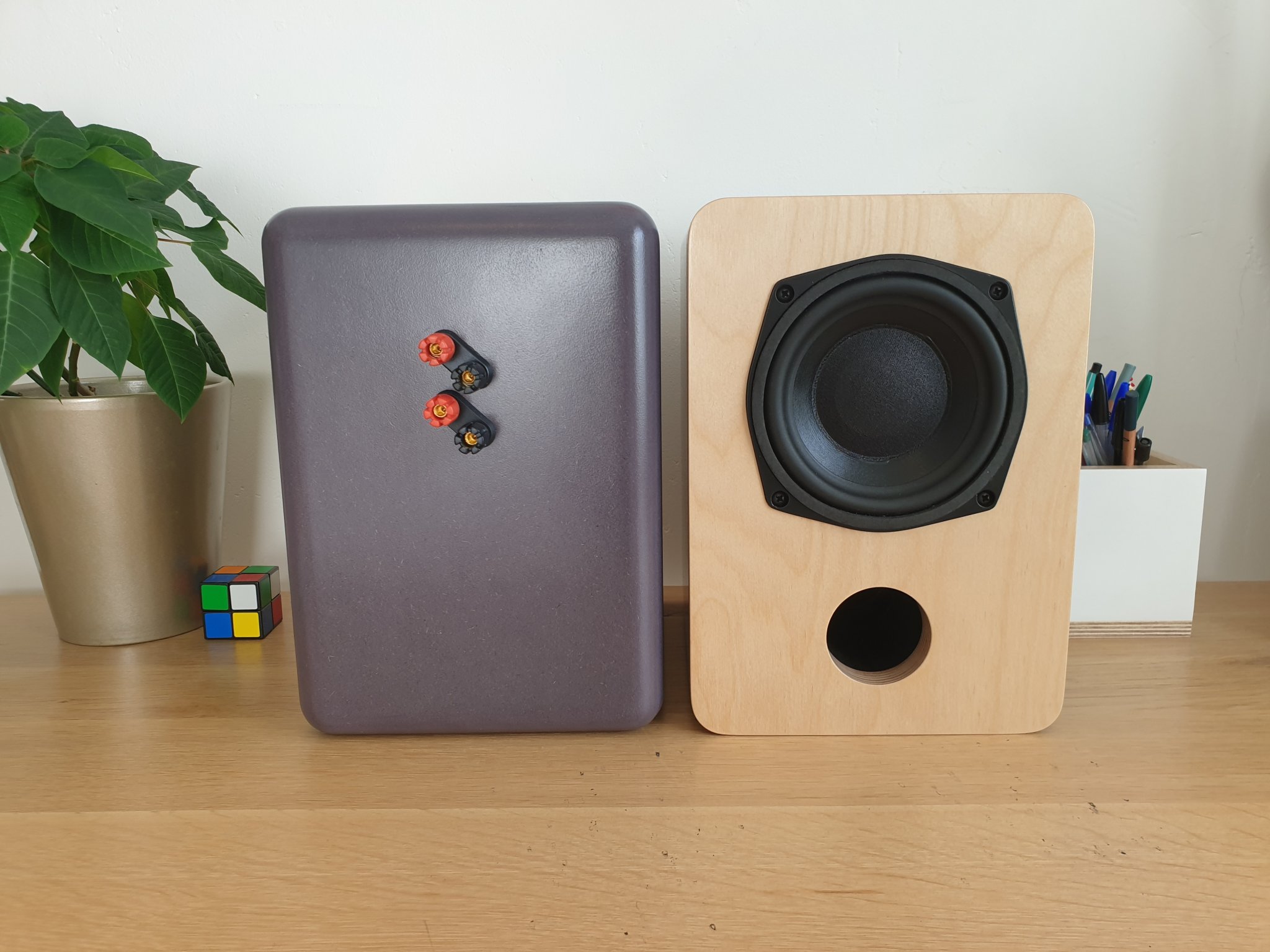

With MDF (I use MRMDF which takes finish a bit better as it is made to be less absorbative) I lay down 2-3 coats of waterbased matt or satin varnish with a high density foam roller and sand inbetween. By this point you can look across the surface and see most imperfections and can fill or deal with.
(the third pic above is as the varnish is fresh on so hasn't levelled itself yet so looks more orange-peeley than it ends up but the reflections in the baffle which was already done show what you can get)
After that I use whatever paint I have plumped for and roller it on with the high density foam roller. You can get these with concave ends so they leave less lawn stripes. Layer on the paint a good few times then once thick enough I sand it back down to get rid of the majority of the built up texture. The over the top of that I do a couple of clear coats with the roller which sanding in between.

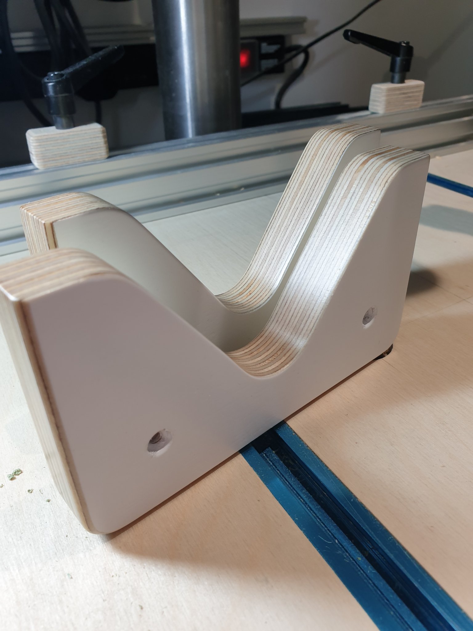

If it is a small project I do the above but do a final final sand then clear coat with Rust-O-Leum Crystal Clear satin. You have to wait for the waterbased stuff underneath to cure though. Then do some wire wool action then a final spray.
Here are some brackets I made with the roller/spray/wire wool combo:
Using a roller is a skill in itself, I have a realised. It's all about pressure and as you track down a panel you want to relieve pressure from the side that is the finished edge. You can get excellent results that show no roll marks as can be seen below which is black MDF that has had LOADS of clear coats:
Rollers may not leave the uber-flat surface but it's just about what I consider passable.

Cool but you are missing the most important data, WHAT wood did you use?I recently fabricated a wood base for a turntable I wanted to sell.
HOW did you prepare surface?
Sanding, sealing, how many coats, etc?
This is s practical advice thread 🙂
Thanks.
Pine.Cool but you are missing the most important data, WHAT wood did you use?
Thanks.
Sanding and sealing, yes.
3 coats.
