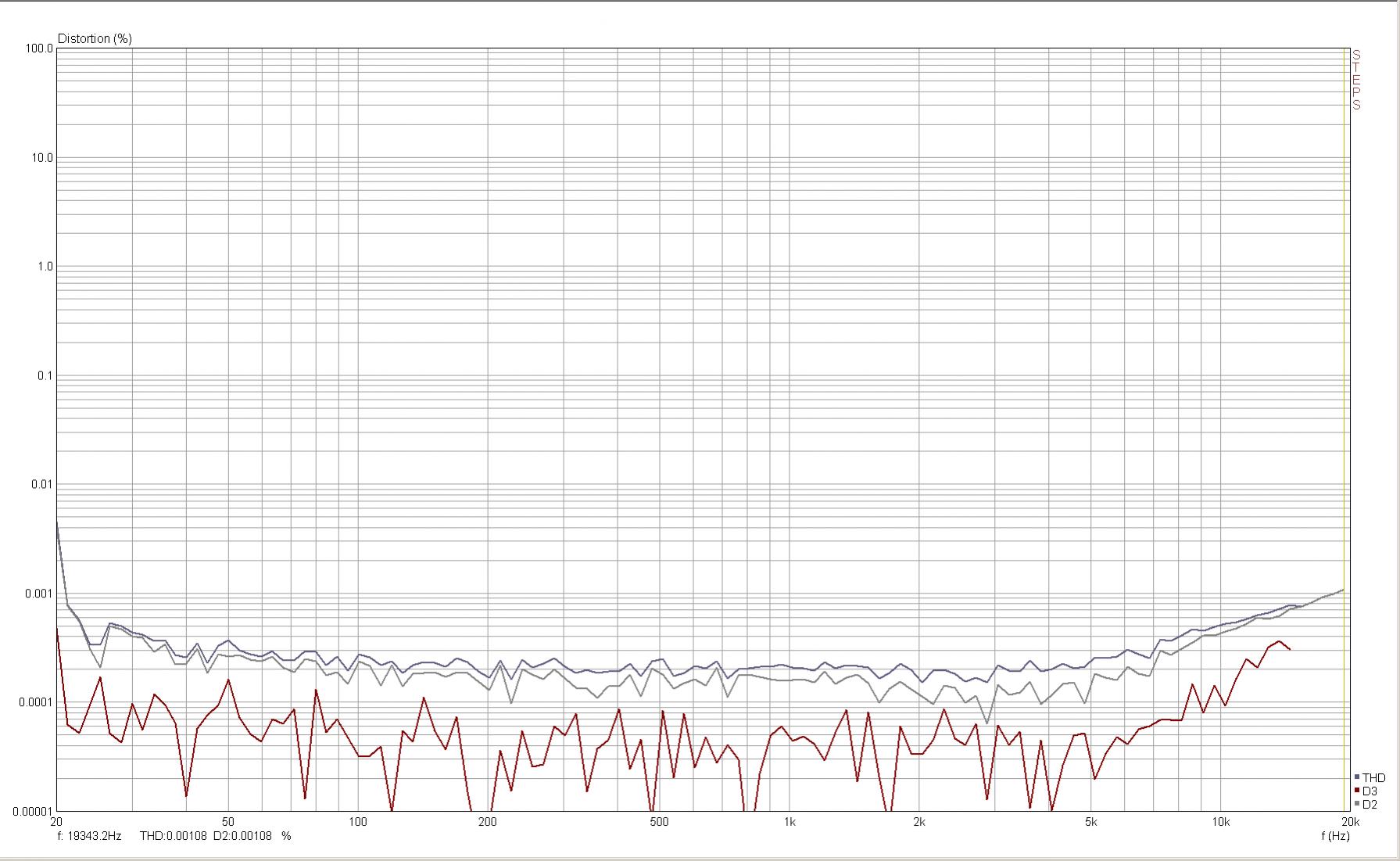

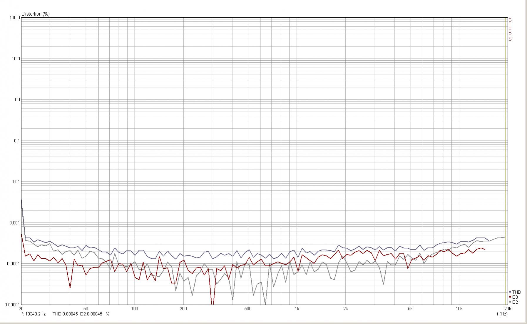

Tom,
I understand You had encountered this problem with your topology, your design.
In the cited project of mzperx he had measured 0.0003% THD at ~1W output, 4ohm, though.
Also, I had been testing a completed, full version of the Mauro Penasa MyEvo amplifier with unselected parallel LM3886 outputs. The parallel version gives better, lower distortion in the high frequecy range than single current pump configuration. Parallel current sources do not fight over dc offsets! I have measured not more than 3mA in the output 'ballast -- no, feedback/control' resistors.
Attached below is the distortion scan at 5W output into 6.8ohm
a) EVO classic, single current pump
b) EVO full, double current pump
C) EVO full at 20W output
Sincerely, George
The problem of standing current between two LM3886es or the two halves of an LM4780 in parallel are well documented on this forum and are not unique to any particular topology. As I said, the offset voltage of the two amps will differ, hence, a standing current between the two amps results. That is why people use the ballasting resistors. Without the ballasting resistors you'd have a short circuit as one amp half drives the output towards Vos1 * gain and the other towards Vos2 * gain (Vos1 ≠ Vos2). This is a problem with any amplifier that runs multiple channels in parallel.
All I am saying is that the circuit designer needs to deal with this somehow.
You are correct that in a current source amp, you can run multiple channels in parallel without fighting. They'll just add different amounts of current. Instead of having to deal with the DC offsets, you get a stability challenge. This is documented by Bob Pease (see link elsewhere in this thread) and by anyone who has attempted to build a current source amp, including some of the savvy builders on this forum.
All of these problems are solvable. I'm just making the designer(s) out there aware that they exist.
That's great. I measure 0.00012 % at 1 W and 0.00020 % at the full output power (55 W into 8 Ω) and 0.00021 % @ 1 W, 0.00033 % at full output power (110 W, 4 Ω) in my Parallel-86. Like I said, the problems or challenges I point out are not insurmountable but they do exist. I think it's reasonable to point them out.

You can do that in the BPA200-type circuit as well by adding a DC servo to each LM3886. Wrapping a composite loop around such a circuit can be another challenge, but it's a solvable problem.
The EVO shows good performance, at least on the THD plots. How's the IMD and the transient response with a capacitive load? I'd also be curious for the performance at higher output power than 20 W - how's 100-120 W into 4 Ω looking?
