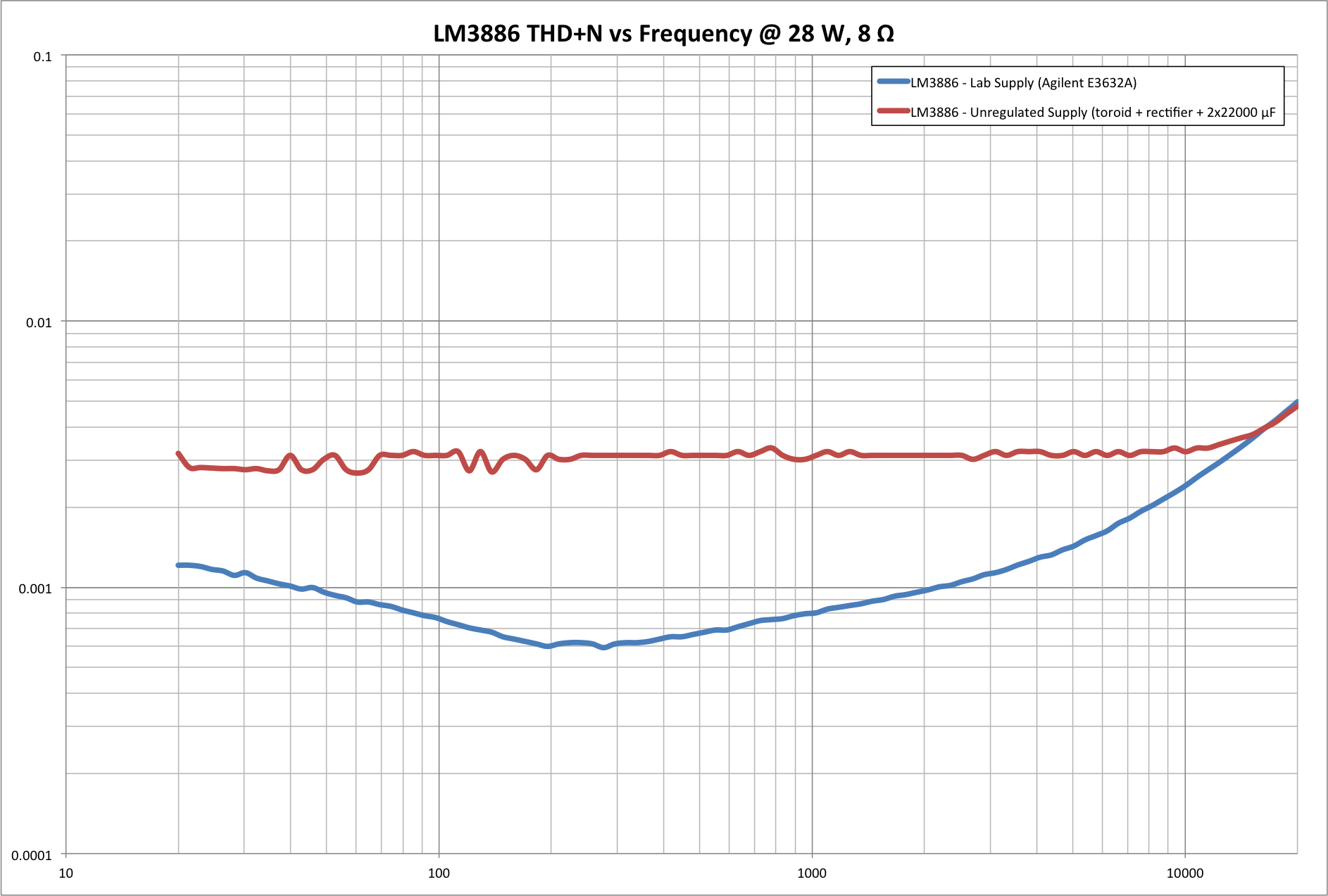

The Parallel-86 uses two channels of the LM4780 in parallel for higher output current. The Parallel-86 can deliver minimum 14 A peak of output current. This is enough to drive a 4 Ω load all the way to the ±35 V supply rails. If you lower the supply voltage to ±28 V, the Parallel-86 will drive a 2 Ω load with vanishingly low THD.
The Parallel-86 is a composite amplifier. In the composite topology, a precision op-amp is used to perform error correction on a power amplifier. The end result is low noise and very low THD. The THD of the Parallel-86 is almost 10 dB below the measurement capabilities of my Audio Precision APx525 analyzer.
The Sympatico is a composite amplifier as well. It uses the two channels of an LM4780 in series for a bridged amplifier. Each channel of an LM4780 is guaranteed to be able to deliver up to 7 A of output current, but with the amplifier channels in series, that means the maximum output voltage across a 4 Ω load is 4*7 = 28 V.
This means a bridged amplifier based on the LM3886 (or LM4780) will not be able to deliver any more power than a single LM3886 (or half LM4780). To me, that defeats the purpose of the bridged design.
In addition to the incredibly low THD, the composite amplifier topology also results in incredibly high power-supply rejection ratio. I measure the same performance of the Parallel-86 regardless of if I'm using a regular non-regulated linear supply, a pair of $1200/each well-regulated lab supplies, or a switching supply (Connex SMPS300RE). With non-composite chip amps, you can count on a degradation in THD+N of about 15-20 dB (5-10x) over the performance specified in the data sheet (see attached measurement).
One note on the LM4780: TI has decided to discontinue the LM4780 along with a handful of other ICs. The LM4780 is getting hard to find in low quantity. I picked up a tube of LM4780s and offer them for sale with my Parallel-86 boards while supplies last.
Tom

"Dead quiet" would refer to the noise floor or residual mains hum. That's what you hear with the music off, but the amplifier on.
What I measured in the graph in Post #2 was the impact of the power supply on the amplifier THD when the amplifier is delivering a signal to the load. I suspect the reason many chip amplifiers sound kinda strained and harsh is due to the interaction between the supply and the amplifier. The composite topology of the Modulus-86 and Parallel-86 remove this supply/amp interaction to the point where it disappears below the measurement noise floor. The result is an amplifier that sounds open, natural, and clear-as-a-bell transparent.
Tom

Actually, no. The reason for the difference in THD+N of an LM3886 when using a regulated supply and unregulated supply (shown in Post #2) is because the load presented by the amplifier on the power supply creates signal-dependent variations in the supply voltage. This shows up as THD (not noise) on the output of the amp. It's the THD part of the THD+N that rises.
A good amplifier will have high PSRR, hence, reject these signal-dependent variations in the supply voltage. As a result, it will show better THD and THD+N performance at high output power.
I tend to use THD as a synonym for THD+N and count on the reader to have sufficient context to understand my point correctly. What's shown in the plot in Post #2 is THD+N (measured using an Audio Precision SYS-2700 - two measurements combined in MS Excel).
Tom

What I was referring to is the supply ripple caused by the desired signal, specifically by the load current. Ignore all mains hum for a second. The power supply has a finite and non-zero output impedance. Hence, any supply current will cause the supply voltage to droop. Hence, if you have the amp deliver, say, 1 A peak to the load at 1 kHz, you will see a supply current of 1 A peak (plus the idle current of the amp). The supply current in a class AB amp will be half-sine shaped pulses with a frequency of 1 kHz. The VCC rail will contain the current from the positive output swing. The VEE rail, the negative. This current is not pretty and due to the finite non-zero output impedance, it will set up a series of harmonics of the signal frequency (1 kHz) on the supply voltage. It will cause a signal-dependent ripple voltage at the signal frequency (1 kHz) and harmonics thereof (n*1 kHz). Some of this ripple/droop will make it through the LM3886 due to the low PSRR and cause an added signal at harmonics of the signal frequency. So you'll have signal (1 kHz) + harmonics (n*1 kHz) of the signal. That's harmonic distortion.
The reason the regulated supply results in lower THD with an amplifier with poor PSRR, is that the output impedance of the regulated supply is much lower, hence, less droop occurs when the amp starts delivering current to the load.
Tom

If you look at the FFT of the output signal of an amp when running on a regulated supply and when on an unregulated supply, there's no difference in the noise floor. On the unregulated supply, there are some mains-related components starting at 120 Hz (assuming 60 Hz mains frequency) and up to about 1-2 kHz. I suppose these could be the "random frequencies" that you mention, but I've always found them at integer multiples of the mains frequency.
I'm sure there's a bunch of other crap on the mains. Loads switching on and off. Switching supplies with broken EMI filters, etc. I've never seen any of that cause a rise in the noise floor or frequency components on non-integer multiples of the mains frequency present on the amp output, though. Perhaps they've been filtered out by the reservoir/smoothing caps of the power supply.
If you watch the FFT of the output signal as the amp delivers more and more power to the load, you'll see the THD creep up. That's the case with any amplifier on any supply, assuming you can get the harmonics to show above the noise floor.
With an unregulated supply, on a typical LM3886 circuit, you will have some mains related components from the rectification present on the amplifier output. As the load current increases, the rectification/mains related hash will increase in amplitude as well. So you see an increase in mains-related harmonics on the amp output. This gives rise to an increase in IMD (n*60 Hz + desired signal). So the desired signal and harmonic thereof (due to THD) will have a skirt of mains-related hash around it (due to IMD). All this IMD is deterministic. It occurs at combinations of n1*Fmains + n2*Fsignal. The analyzer will interpret this as noise, hence report a degradation in THD+N, unless an FFT or continuous sweep analysis is performed to extract the THD (no +N).
In addition to the mains ripple (and other rectification hash), there'll be a ripple component that's signal dependent. If you've ever watched the mains ripple on an oscilloscope when the amp is delivering significant power (say 25-30 W @ 1 kHz) to the load, you'll notice that you get the usual rounded sawtooth 120 Hz ripple with a little 1 kHz component riding on top. That little 1 kHz ripple will make it through the LM3886 supply pins as well. The 1 kHz ripple component is not a high-purity sine wave (say <0.0001 % THD) and the path through the supply pins is not clean. Also note that the PSRR on the VCC is much higher than on the VEE pin of an LM3886, so the signal-dependent ripple will cause a rise in THD.
One could tease out how much of the THD+N degradation is due to the supply impedance and how much is due to the mains ripple by adding resistance in series with the supply leads on the regulated supply. I hope to touch on some of this next time I update my Taming the LM3886 pages.
