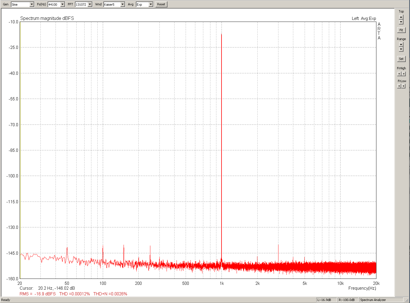

The specs at the end of the document do not make sense.
40 W @ 8 Ω, ±37 V is way low. You should get over 50 W.
56 W @ 4 Ω, ±37 V. Why? At ±28 V, you should get over 65 W, so why are you only getting 56 W at ±37 V?. What's going on there?
Damping factor, 8 Ω = >200 (frequency and compensation dependent)??! Okay... So under which conditions were the >200 DF measured? Last I checked, DF = RL/Zout and Zout for a current source should be very high. Is the circuit even a current source then? It's marketed as one...
S/N (600 Ω): >90 dB (compensation dependent). Again. Under which conditions? The SNR of the MOD86 is 112 dB. That's right at the hairy edge of detection for the APx525.
THD, IMD < 0.05 %. Yeah. Not impressed. I'm getting 0.000067 % THD (1 kHz, 38 W, 8 Ω, ±28 V) and 0.00069 % IMD (SMPTE, 60 Hz + 7 kHz, 38 W, 8 Ω, ±28 V) on the MOD86.
I'd be interested in seeing the THD+N vs frequency and THD+N vs output power for the circuit as well. The THD+N vs frequency will tell you a lot about the layout, as well as the circuit. I'm curious for the THD+N vs power to see the effects of the clipping circuit you mention.

It's probably so, it would be interesting measuring the My_Ref Fremen Edition or the My_Evo without the limiter.
Nevertheless the 0.00011% THD measured by JosephK say it's not that much detrimental, after all 😉

You can find complete My_Evo JosephK measurements here and Fremen Edition here.
My_Evo:
Fremen Edition:
