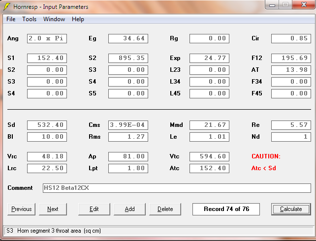

Coaxial ported is looking like the direction I am headed. Starting to study HR a bit more as I am struggling to get some ported designs to sim well. I must be doing something wrong but at least I am learning... Might be even brave enough to try and create a sim for HS12.

Anyone willing to shoot my sim of the HS12 full of holes??? Learning alot but not confident I am there yet. Pics/data in post 7. http://www.diyaudio.com/forums/pa-systems/160911-jbell-pa-top.html
