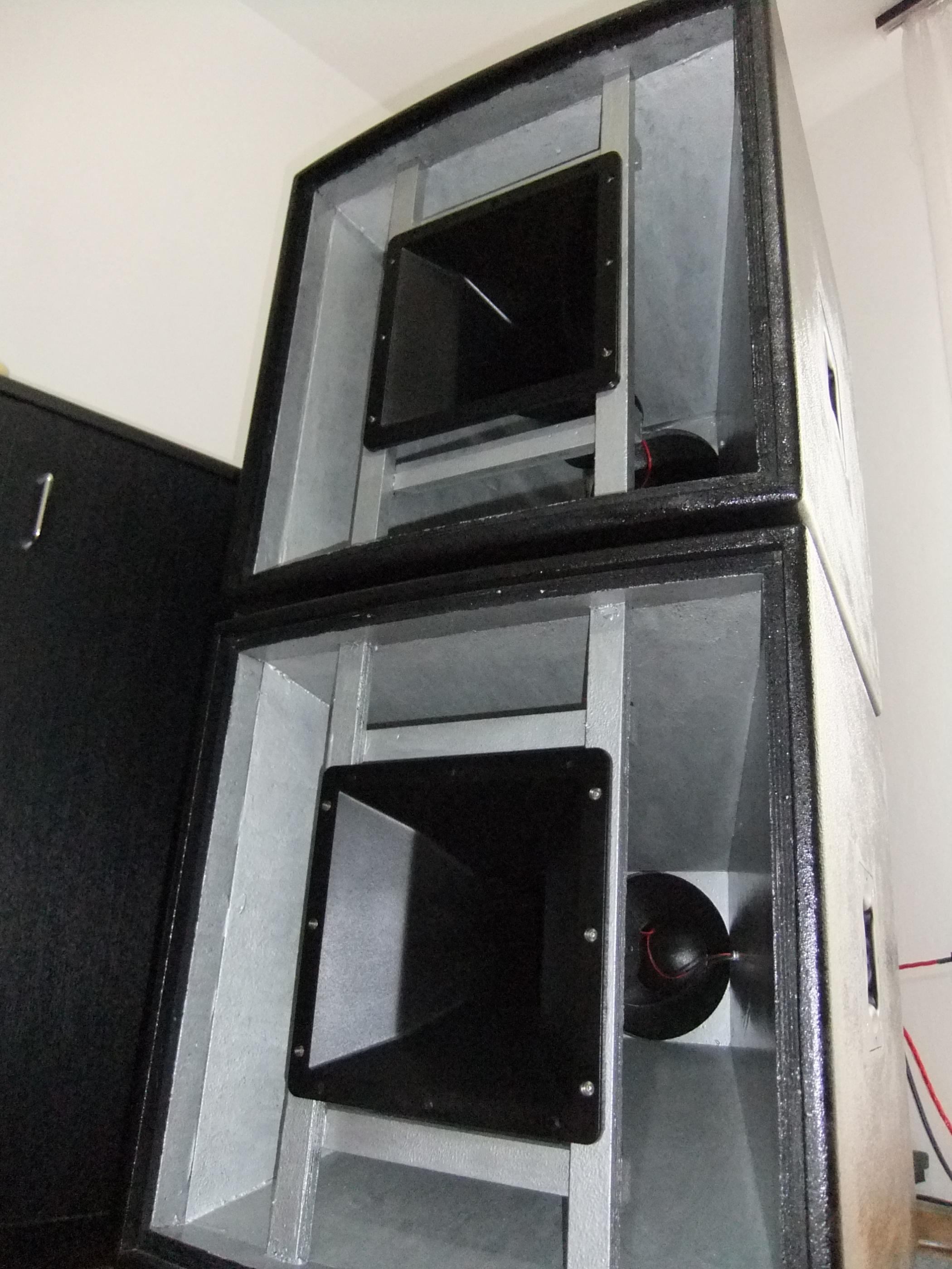

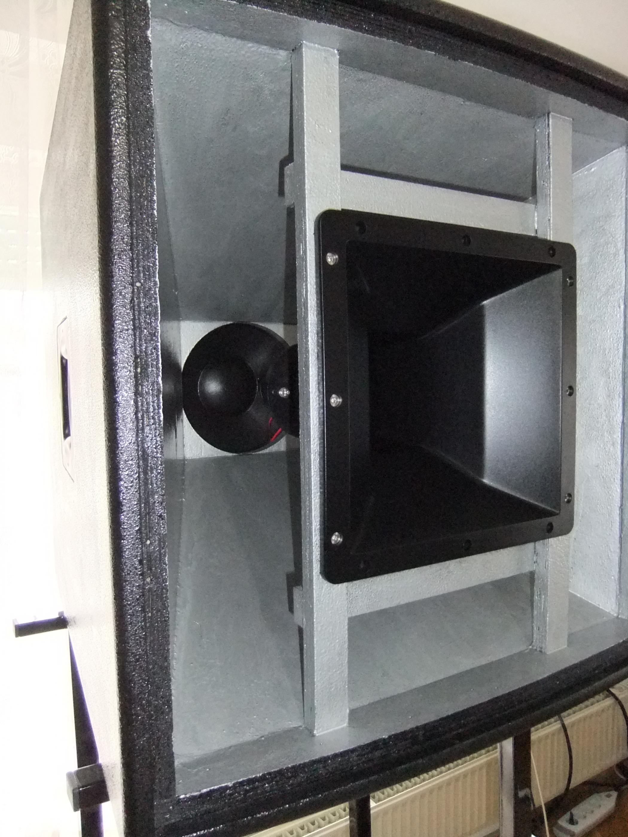

This is my 12 inch size La Scala with your port mod(only upper 2 ports are in use) and loaded with quad 8 inch PPSL plenum per side. (Thanks for the design!)
