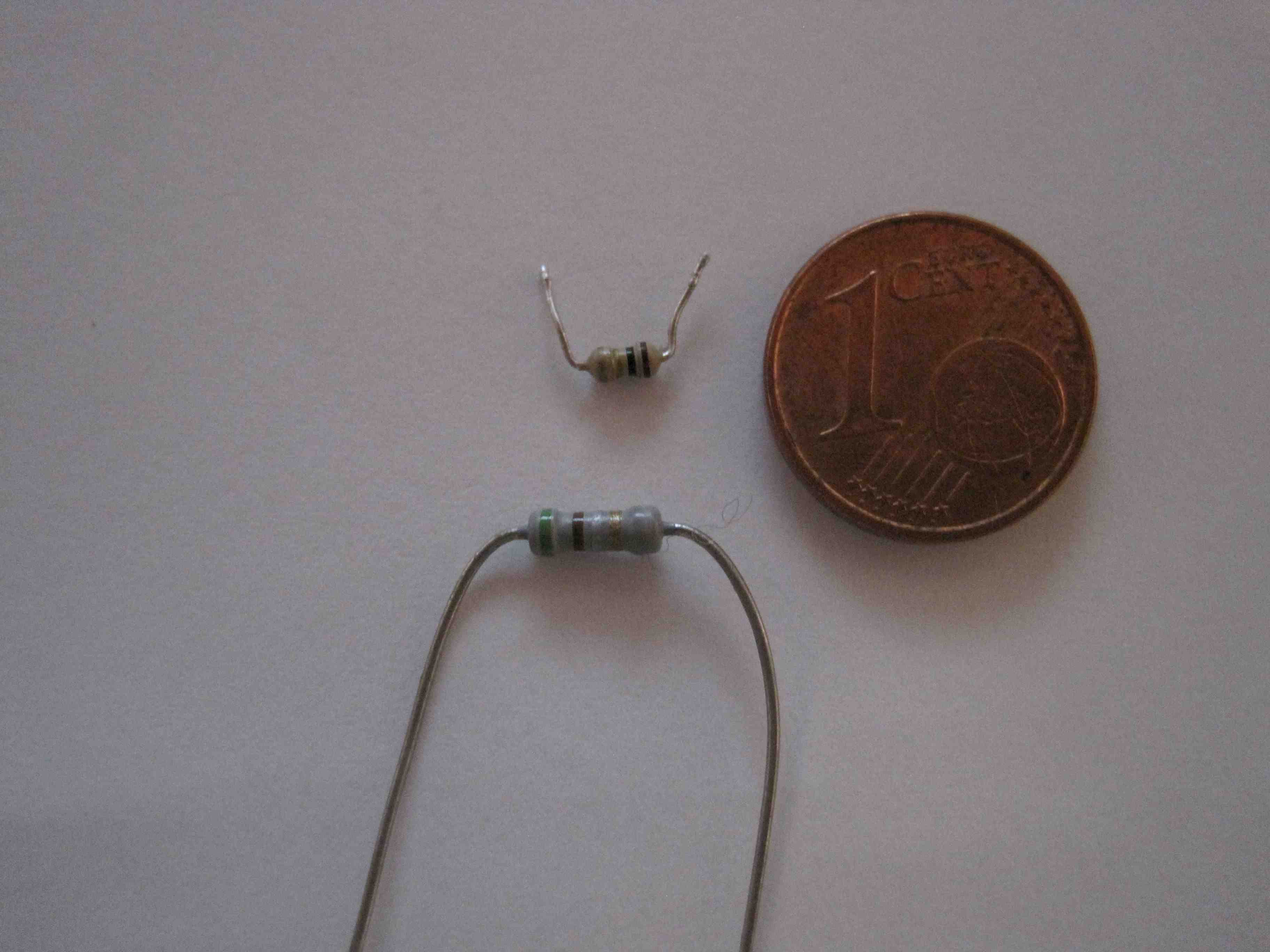

I found a couple of 1 ohm resistors which are quite big. They wouldn't fit in the board unfortunately..

I've been in a repair shop and i found some resistors which are slightly bigger in size, but they fit perfectly in the board, but they are not 1 ohm but 0.66 ohms.
Is that ok, what do you think?

at this point i'd be less concerned with the replacement resistors as i would be with the rest of the circuit (you have the amp running on "the dim bulb tester") i'd temporarily jumper the solder points of R22 R23 and check that everything is ok with the regulators and assuming that's ok seeing if the pre-amp board lives (remember we still don't know why this failed to begin with and it's possible there's still potential problems with the remainder)
due to your time factor i'd spend more time checking the rest than shopping for parts.
what wattage rating are the 0.66 ohm resistors?
I don't know, the tech didn't know.. Is there a clue to know that?

physical size and type.
some metal film flame proof types are quite small compared to old carbon composition resistors.

Ok. So, before i burn something else, you give me the permission of making a bridge where the resistors were, and try to power on the amp? I could see if i got the famous -+15 v.

it should be a 0.5 W one, against the original 0.25 W.
colour code says 0.51 ohm, i got around 0.6/0.7 with my DMM. at the tech place he measured 0.9 ohms..
in picture you can see both of them.

i did mention keeping things on the current limiter for now if there is something like a hard short you'll know it the limiter lamp will tell you (to turn it off and start lookin' for the new problem)
ok to help your understanding can you figure out why i'm interested in the wattage rating of your replacement resistors?
Well, we don't want to burn them again, i guess.
Being lower in resistance means having more current on the circuit but less power dissipation trough the resistors themselves. Since the "new resistors" are more capable to dissipate power, we should be on the safe side. Question is if the increase of current would damage or dosturb something after the resistors.. I don't think, after all it's "just" some ohm decimals...
Is it right what i said?

not quite
think of the behavior of a fuse (which is what this is intended to replace) if you allow more current you can risk potential damage.
your not one of"those people" who thinks it's ok to just increase a fuse rating so it doesn't blow are you?

Uh, I believe we are talking about 1 kohm protection resistors R22 and R23. And you are proposing to replace them with 0.66 ohms? I would not do that. 660 ohms maybe, but not 0.66 or a bridge. Blue Blue brown is 660 ohms, blue blue gold is 0.66 ohms.
One way of finding the component that blew the resistor at first is putting in some resistor smaller and higher wattage that won't allow the transformer to burn up. Then look for heat. I suggested a 47 ohm resistor, but I've never run into a transformer that weak.
Before I tried anything but a 1 kohm resistor of higher wattage, I'd replace all the electrolytic capacitors with new ones that will charge to > 100 kohms on a meter ohms scale. that includes the four on this board, and the 47 uf capacitor shown on the op amp board.

Beside romanticism, the colours of the original resistor are: brown-black-gold-gold.
And that's a tiny 1 ohm. After all a fuse is actually in that range, isn't it?

Yes, I would put the brown black gold resistor (which is one ohm) in my 1 to 10 ohm storage bag, and not use it for R22-R23. You did ask for 1 kohm at the shop, didn't you? I suspect you are more of a musician than a detail person. That is one kiloohm, or brown black red. Sorry if the abbreviation didn't translate at first.
a 1 kohm resistor, on a 16 vac per side circuit, will drop 8 volts at 8 milliamp, which is not very much load current.

No man, i asked for 1 ohm.. There is another place i could go, the owner is a japanese wo worked for Sony in the '80s. He might have some spare parts.
Actually i don't know how and who said these resistors would be 1kohm.. If it was me, i really am sorry..
well short of a better resolution scan of the documents i think it's 1 ohm because looking at both the silkscreen and schematic it still looks like 1R to me (different notation) but to me that says 1 ohm 0.25 watt or does my vision need retesting? in looking at the twenty one volt rail and the same scheme is employed there 0.22 @ 5W
