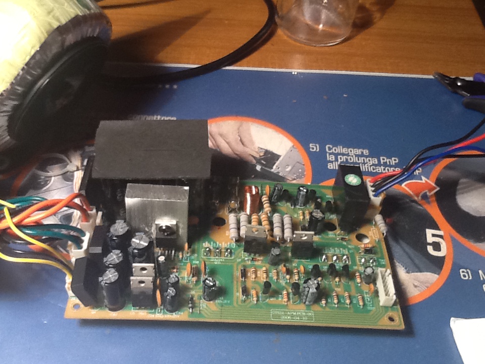

So, i would say that after repairing the ground trace i put a new 4558 and if with the poor speakers i'll have a good behaviour i'll try it on the "good" speakers.
I report as soon as i can. 🙂

Check the voltages and make sure they are ok.
If not; all the rest is pointless and a waste of time by you and all others.
Second:
Let us know the values and how you measure them.
All the rest, again, is pointless and a waste of time by you and all others.
If you do not use a method, starting with the power supply and fix it first, then, again, all the rest, again, is pointless and a waste of time by you and all others.

C'mon, no stress guys. Tarzan, i totally underastand what you mean, it isn't (hopefully WASN'T) easy for Turk and Indianajo to explain me every thing, i'm a rookie and they are (hopefully WERE) very kind to me.
Don't take this thread as a reference though! 🙂
Let say that if from the very beginning i would have been clearer and less impatient we might had arrived to conclusion earlier, i dunno.
Anyway, B power board and B pre are playing in their bix, XTC's "English Settlement".
So far so good. Now i assemble speaker A. I report as soon as i can.

Guys... THEY BOTH WORK!
Hallelujah... Guys i'm so happy and grateful you have no idea.. Thanks so much to all of you.
But now, sorry Turk, i have to take out my best Tequila, you know....😀

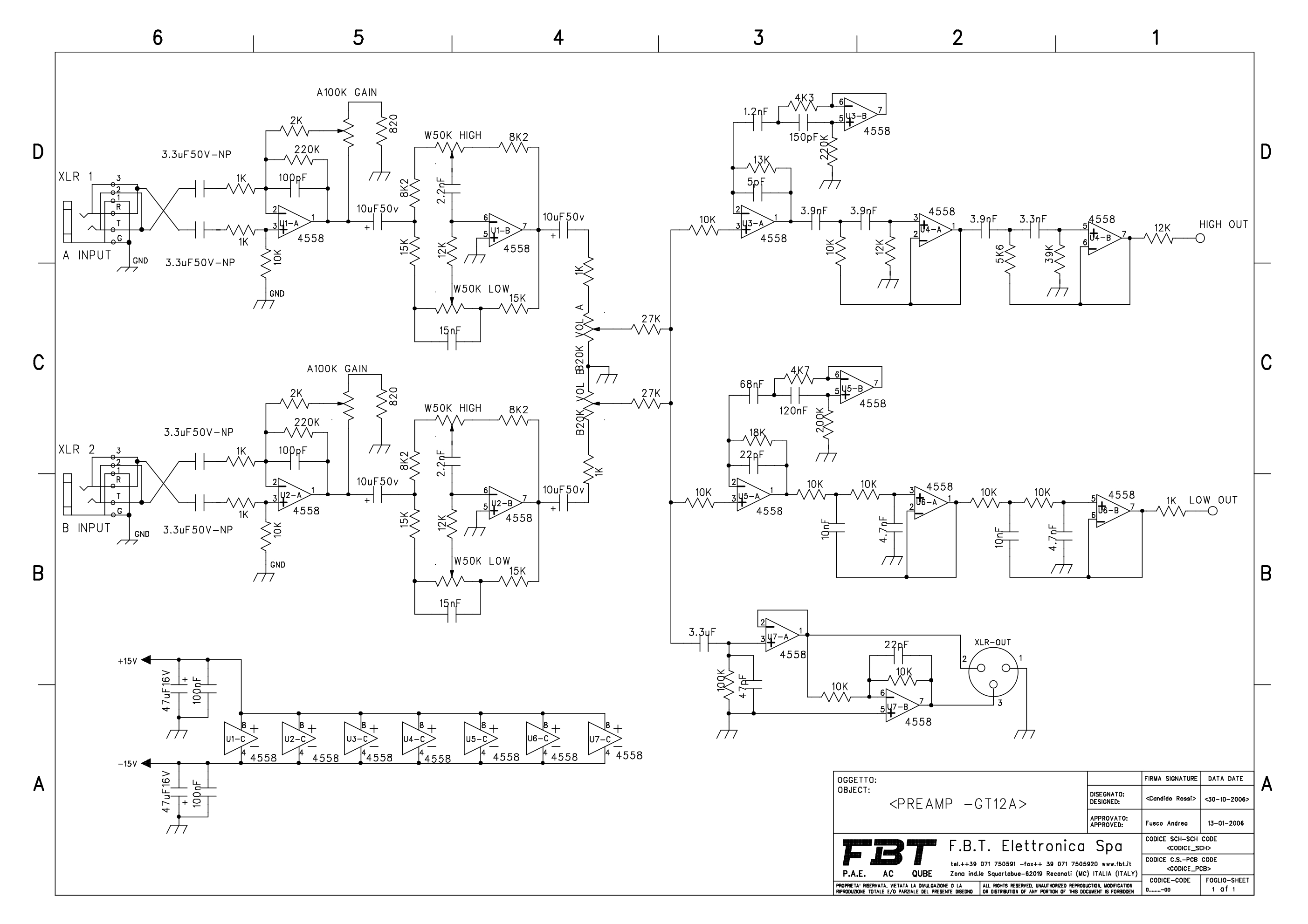

I'm having a problem gt12a kempton .
I have no tension in C11 capacitors, C12 , C15 and C16 has only 3,4V .
Medi resistor R12 25V and has R1 as well. the diode D4 has 0v .
What is the default ?
