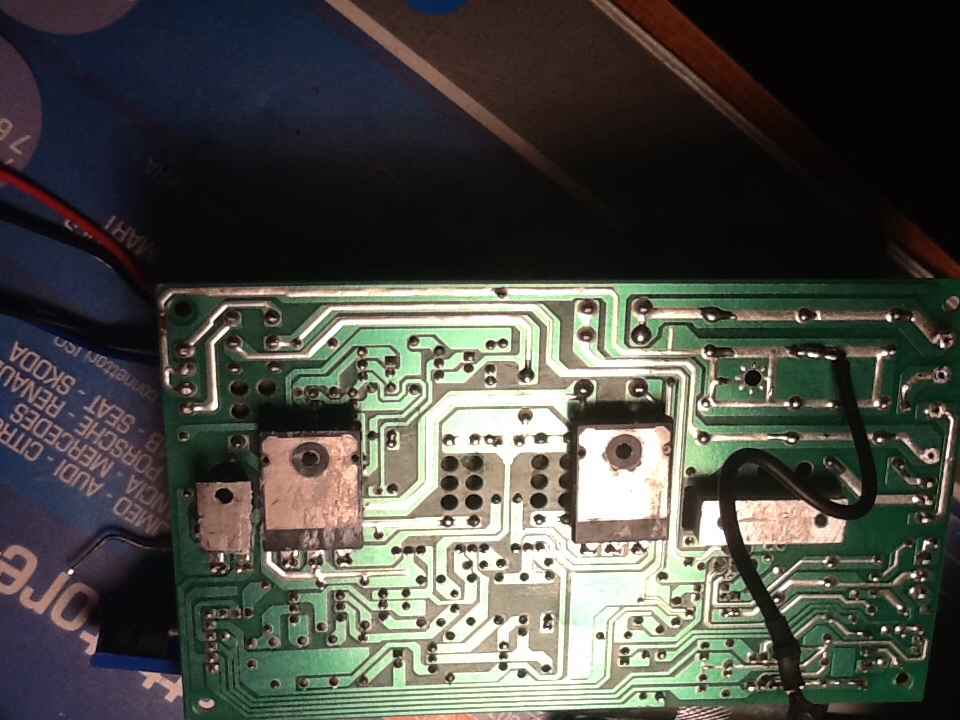

I was checkin this 15v and i damaged again something else. Mamma mia! I don't know if it's normal or if i am an idiot. Anyway, i think the speaker wire touched themselves of a part in the circuit. So i heard a BANG and blue smoke (again...) . The lamp is now constantly on, obviously the circuit remanis still, something is burned (again).
I made a couple of pictures with the ipad. Hope you can see: there is a burned point in the ground trace (maybe where a wire touched?) on the lower right part, and on the - of KBJ606 bridge (it's for the big rail) on the lower left part of the picture.

eek! SLOW DOWN and make sure that your not going to cause yourself more problems! i thought you where going to check for continuity between the boards?if your doing that with the power on your just asking for more trouble.
Yeah, and i couldn't find any problem. I mean.. It's not a problem of wiring or bad solder, i am quite sure of it.. I just started with the amp turned on when this tragedy happened. Oh boy, oh boy.. 🙁

make sure the load (speaker) is disconnected from the amp and unplug the preamp board we'll look at that later. check for DC on the output of the amp.if you see anything more than 0.6 VDC power down and check (with your meter) for shorts on output transistors.
