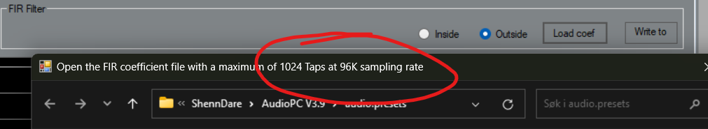

Think I figured it out, seems like there might be some EQ functions that rely on FIR to work, this makes a lot of trouble if you set EQ for the woofers.
Blanking everything to default settings and using external EQ and filters seems to solve everything, lowering Master gain on the amplifier makes it useable for low volume listening.
It seems impossible to deactivate noise gate, minimum value is -100dB.
Not sure how much of the EQ settings through the interface is FIR and what is IIR, I was hoping it would be IIR, FIR is great for tops but useless for bass...
It is possible to enter custom FIR from external sources, 1024 taps per output at 96kHz.
Maybe it works half decent for lowpass, for highpass @20-50Hz forget it, completely useless.
You'll spend all the taps getting a half assed result, better to have phase issues using IIR instead, though you can smooth out most of those if you know your setup well enough.
I had to educate my teacher in this a couple of weeks ago actually, you spend 10x as many taps doing a filter at 100Hz vs the same filter at 1000Hz, high frequency stuff using FIR is awesome!

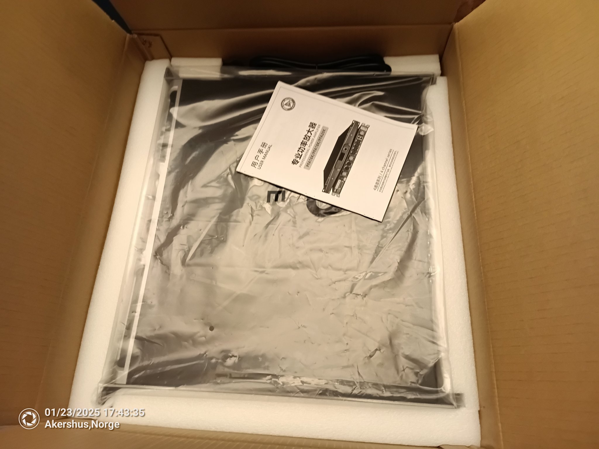

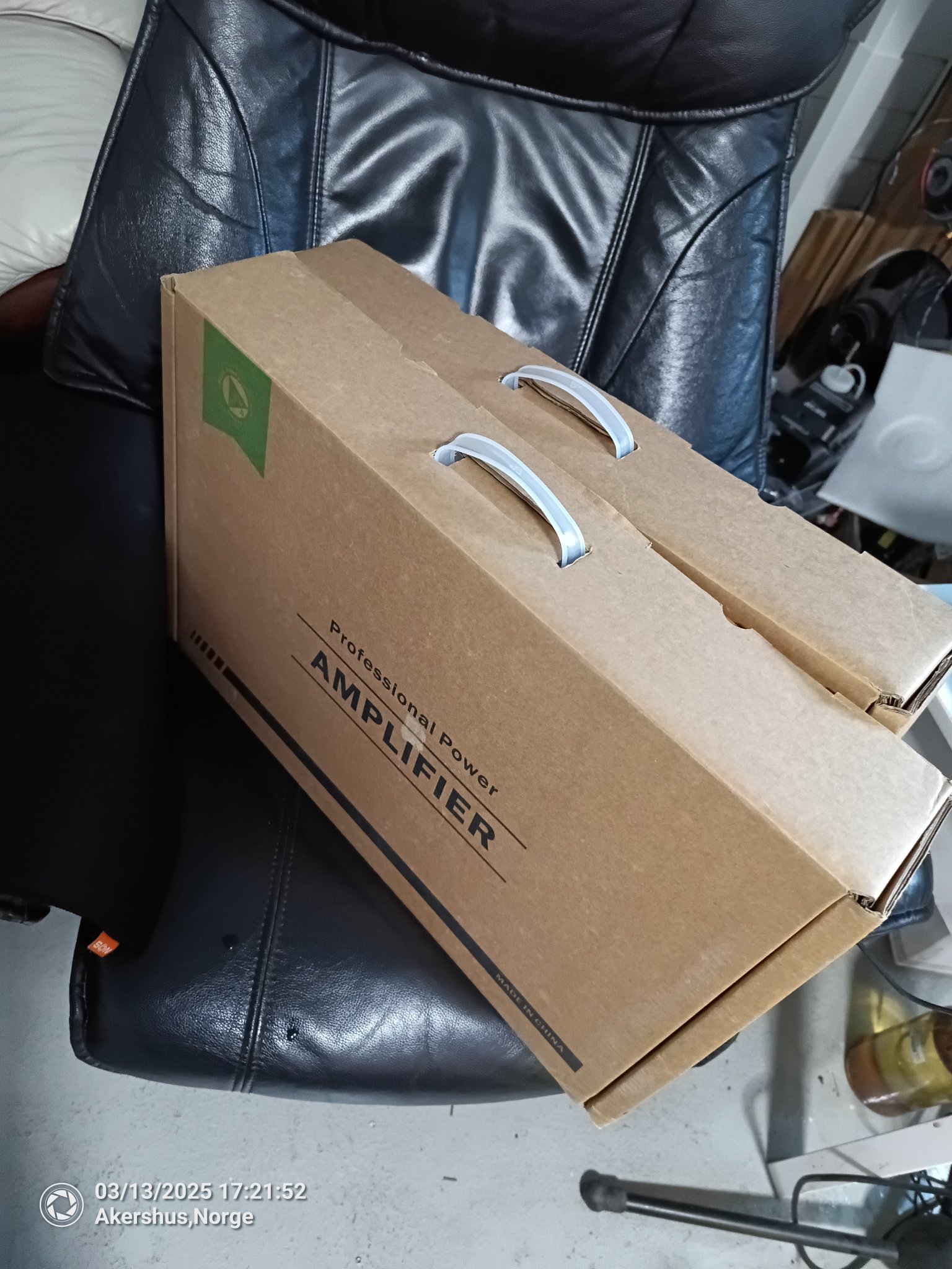

After some communication I ended up purchasing another two amplifiers that are completely new off the press, received my two brand new PFA6K4 a few days ago, these are some smaller amplifiers without any DSP that suit my particular use-case better.
Will start another thread about my progress with "the rack" and what's in it.

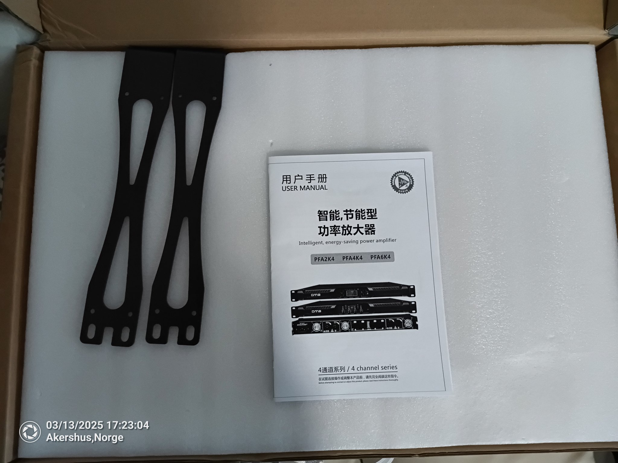

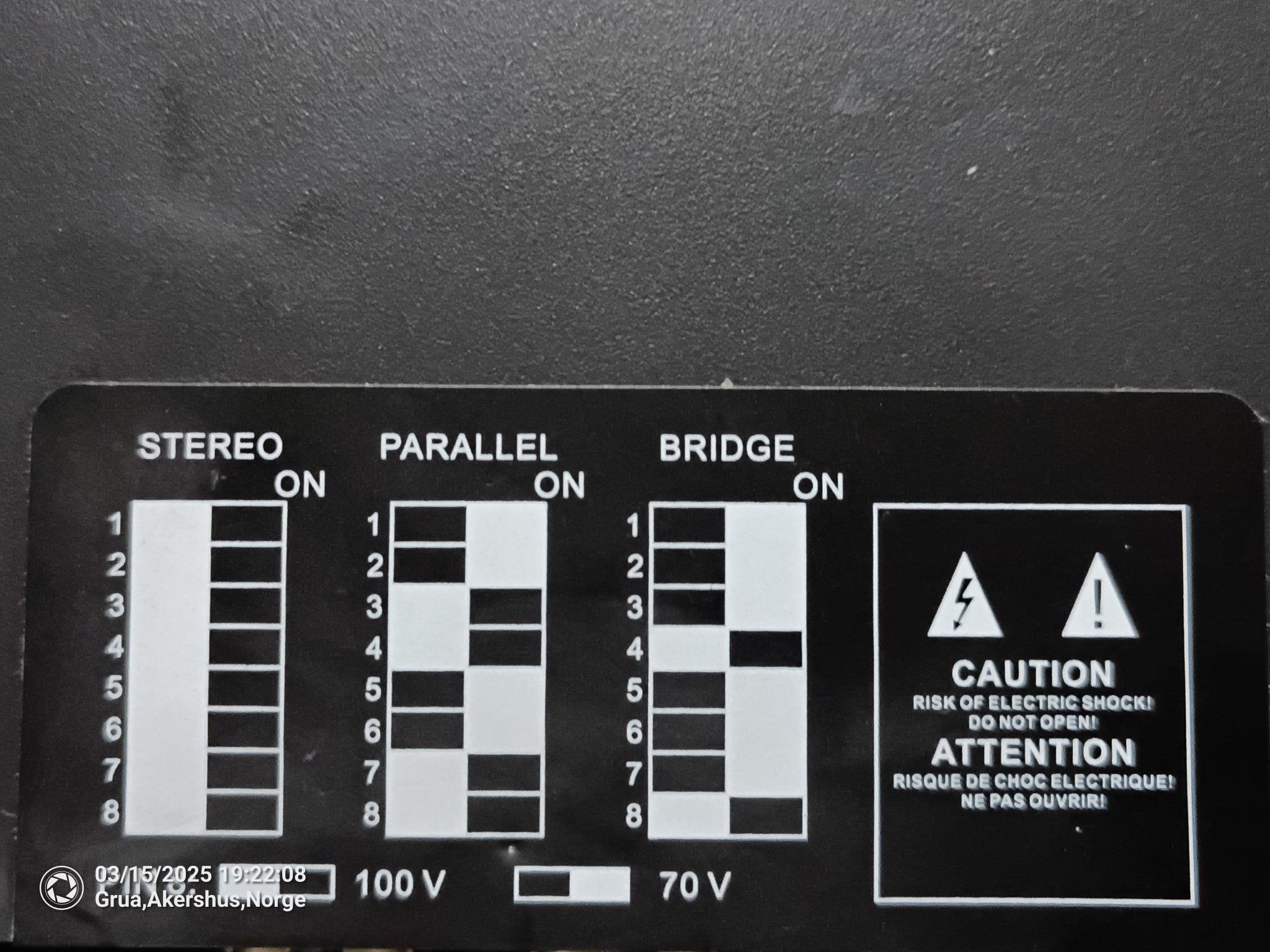

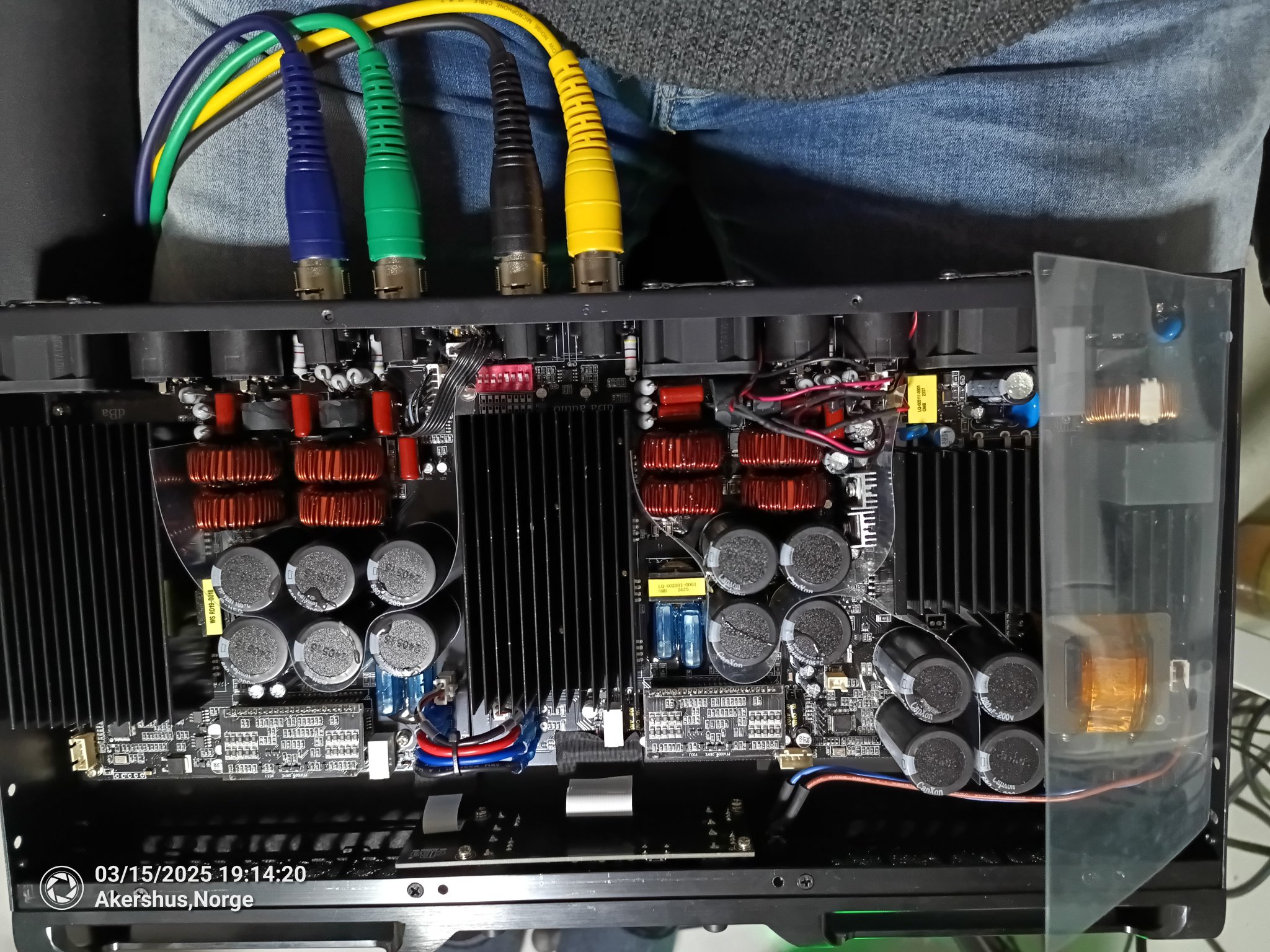

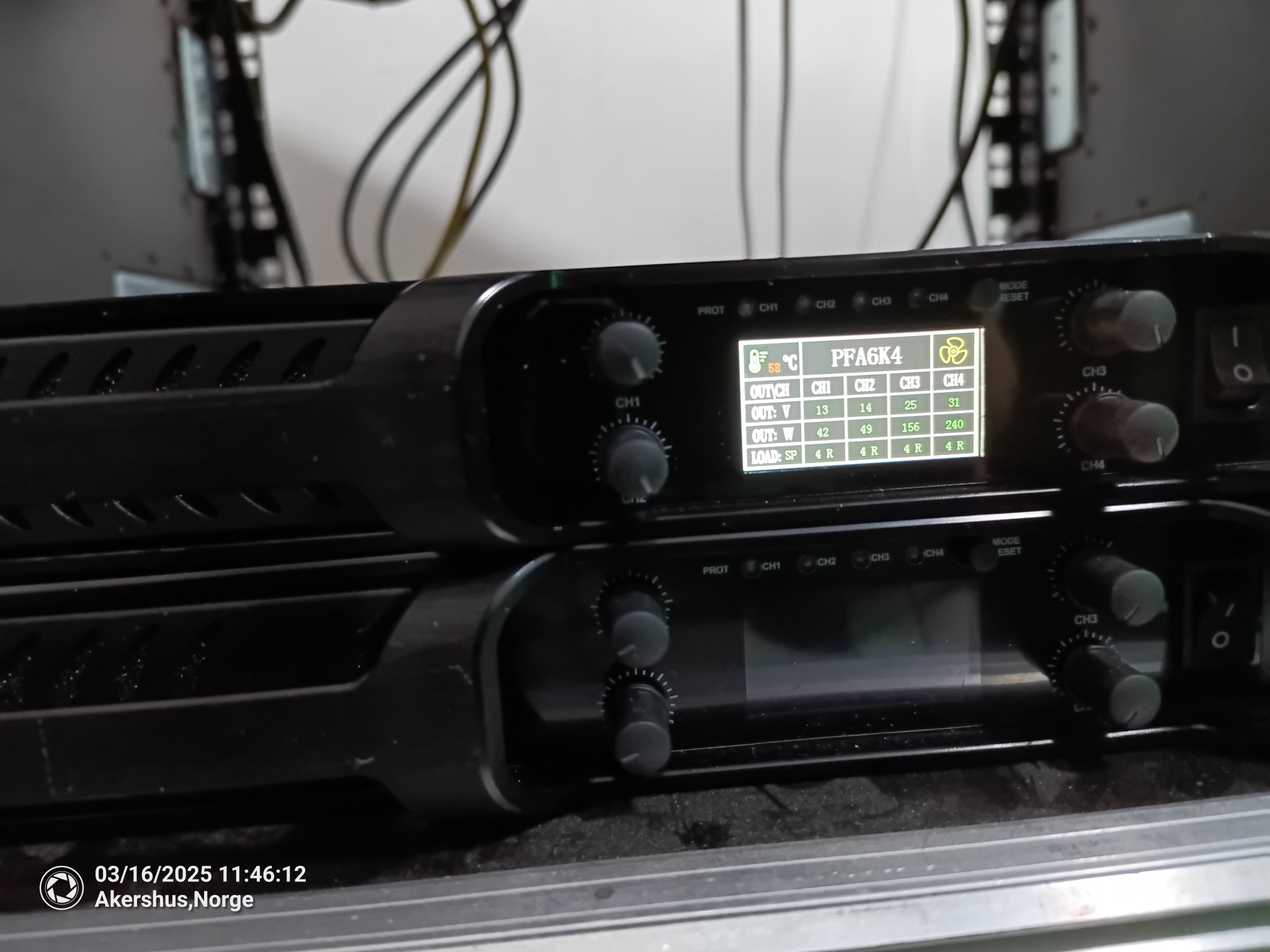

Transition to PFA6K4pro:
I wanted an amplifier that was useable in both my den and outside the house, and integrated DSP was not really important to me because I have the HDX28.
The PFA6K4pro sounds really good though the noise levels are not quite as good as a good TPA3255 design at lower levels, but at higher volume levels it is vastly better.
One nice feature is the display that tells the output voltage and power as well as the measured load impedance, or you can switch it to input levels.
I am also a fan of physical adjustable volume knobs, and the power switch is also on the front.
Protection features are very good, at overload the channels are cut and come back on after a few seconds, the other channels work 100% fine during this time.

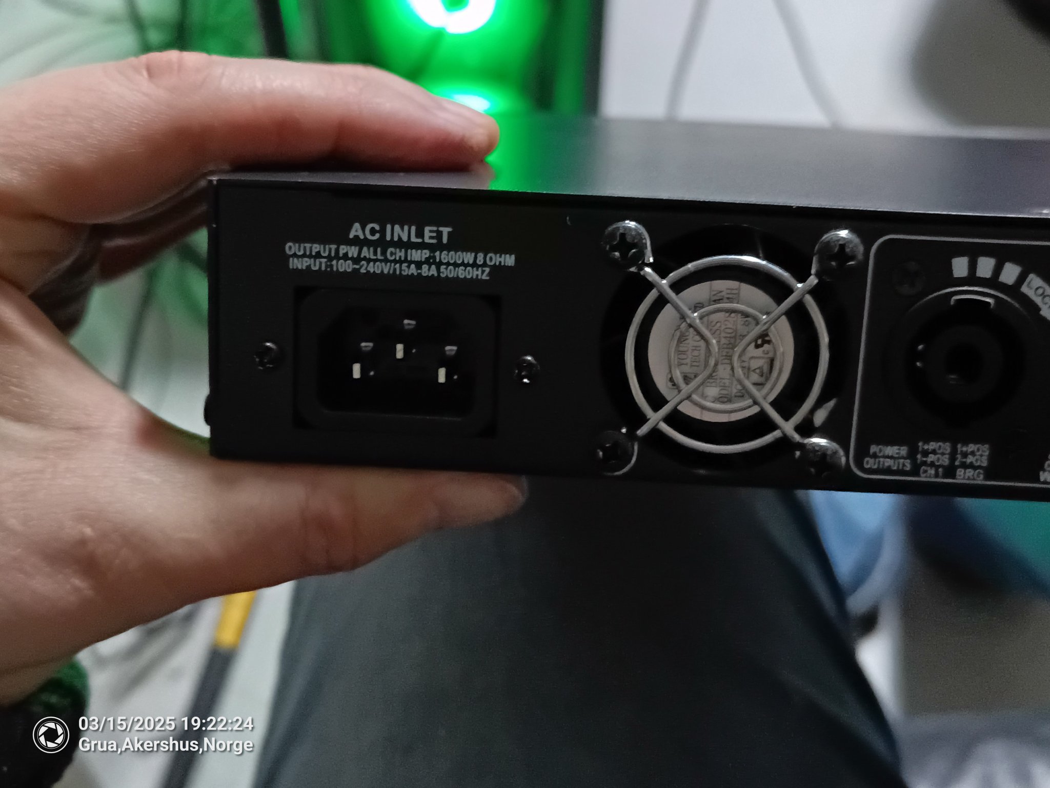

To keep things to thread topic I have a bit of info that I wrote to a fellow member that had a few questions about the PFA6K4 Pro amps:
Seems like there is some level of intelligence involved.
On the back it says max power out divided between all channels is 1600W, I have each amp power subs and tops and this seems like a decently balanced load.
Pushed around 600-700W/ch to subs and then the automatic protection kicked in, which is about right since the tops have a much lower power draw so probably under 2kW draw from the wall.
1600W total is very realistic.
The protection features are very good, takes a few seconds timeout and then it starts right up again.
So max power draw is between 1800-1900W or so, and max power out between all channels is around 1600W.
Personally I think this is a very good feature to have, so it is easier to distribute the load across a few circuit breakers for small compact PA setups.
