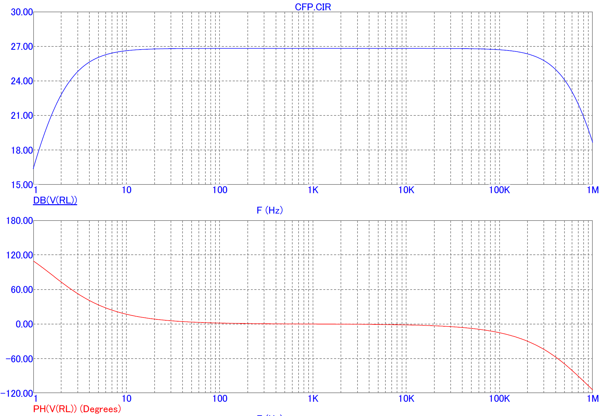

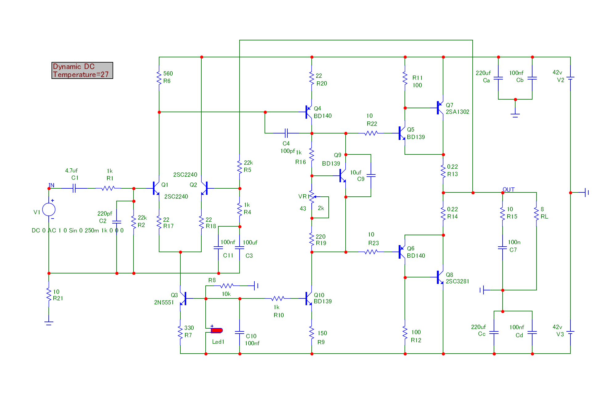

I am departing from my originally planned P3A mod. I thought it was pretty inconvenient and misleading from the original design. I am going to attempt to design one CFP, I know this is going to be hard. I am showing the schematic I have drafted, it looks pretty generic and it could also mean a complete failure but it shows some good results in simulation.

Change R8 to two 8k2 in series.
Connect the junction of these two resistors to -Ve supply rail using a 100uF 50V electro.
Q10 is running @ ~250mW, why use a medium power transistor?
Either use a 5551 @ 4mA, or use the bd at 8mA to 10mA
Adding Q10 has moved this from a P3A
Give it it's own Thread.
Hi, I just run an LTSpice simulation and making R20 to be 10R, bypassed by 1 to 10uF, has a positive effect on THD
Yes, you have increased the open loop gain and increased the feedback.Hi, I just run an LTSpice simulation and making R20 to be 10R, bypassed by 1 to 10uF, has a positive effect on THD
You have seriously reduced the stability margins and the amplifier may oscillate, or at the least, sound brittle due to excessive overshoot on fast changing signals.

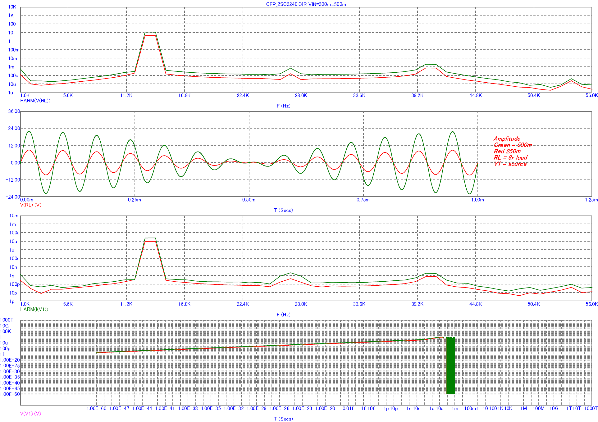

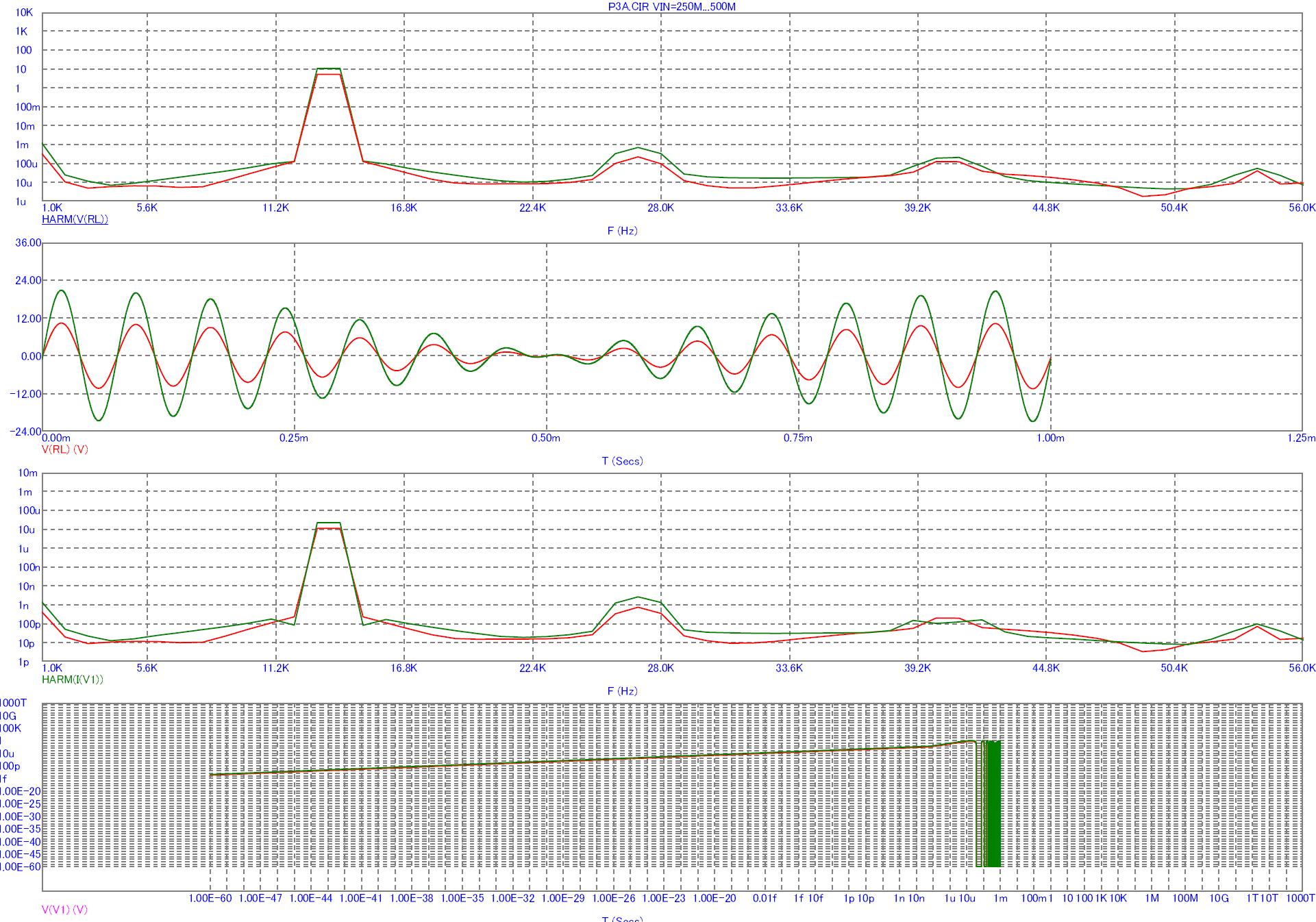

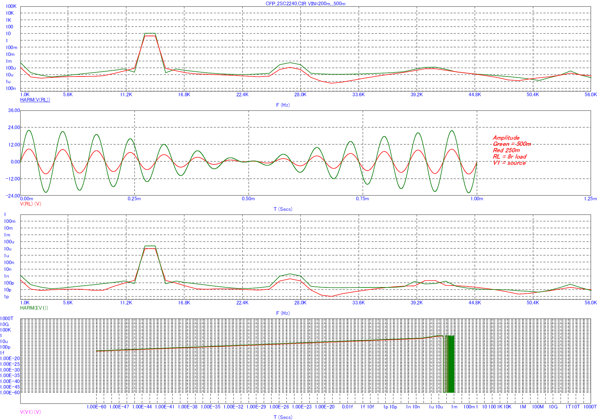

Hi guys,

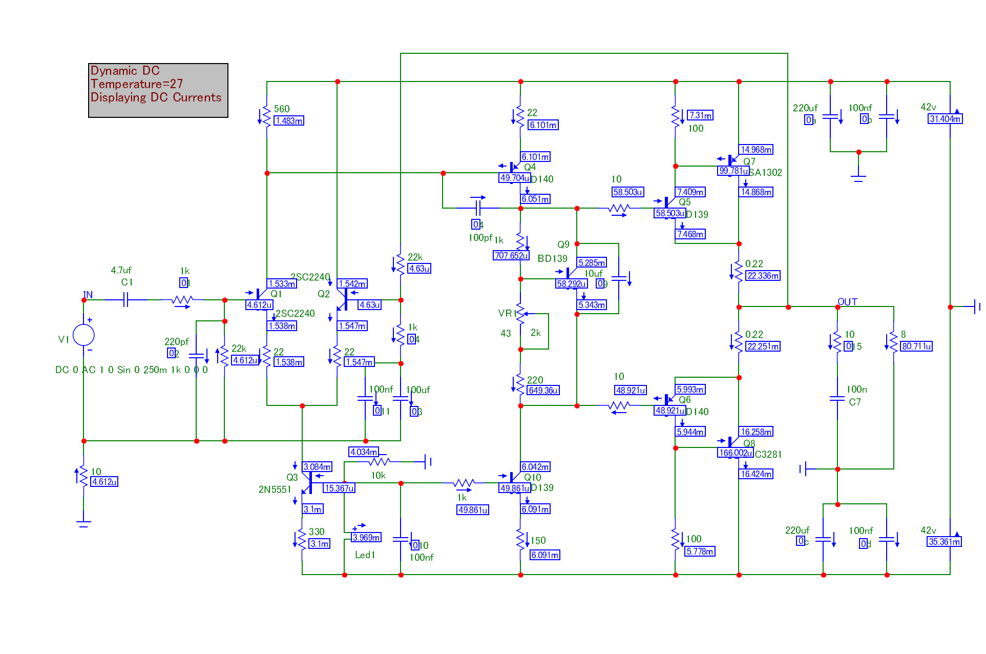

Here is an IMD analysis of the plain P3A and my circuit. I have also run a few IMD analysis of some modified P3A circuit, It was surprising though that none comes closer to the plain P3A and simulation shows that currents and voltages of these circuit is almost identical to that of the plain P3A.

VAS current is at 6ma. Your suggestion of the 8.2k with an e-cap to ground looks like the Blameless approach.

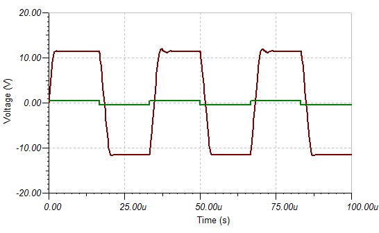

^at that frequency even the board lay-out will have an effect even if you can get to make that smooth in simulations.....
that "horn" at the top swing is called overshoot, frequency compensation ought to take care of that...exactly how? that is the exciting part, i am sure the gurus here will chime in..
how do the waveform look like at 10khz? square wave testing at 100hz, 1 khz and 10khz are usually enough...
