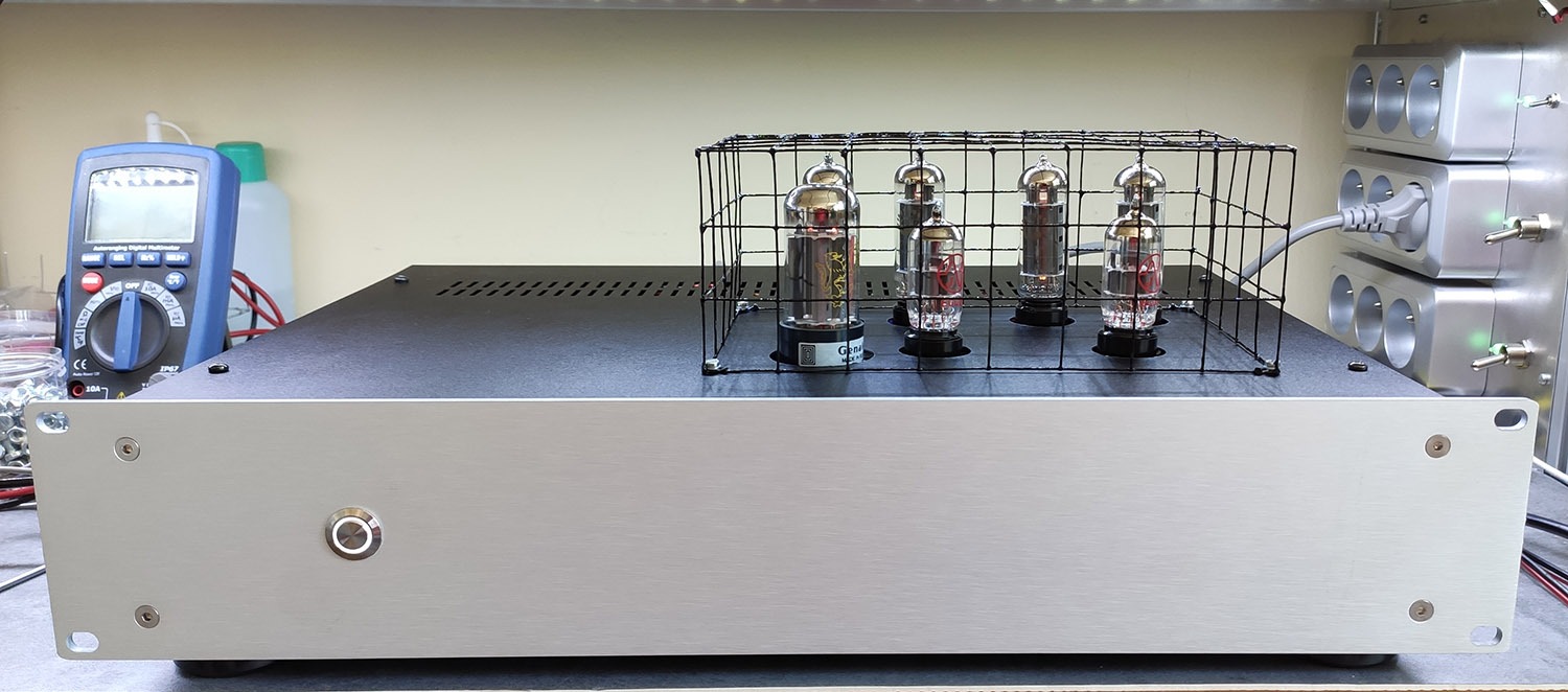

I precise that my diy audio hobby is tube amplifiers. My favorite is EL84 SE, more dynamic than 6V6 or EL34 SE amps. I'm working now on a EL84 push pull amp more powerful than SE.
