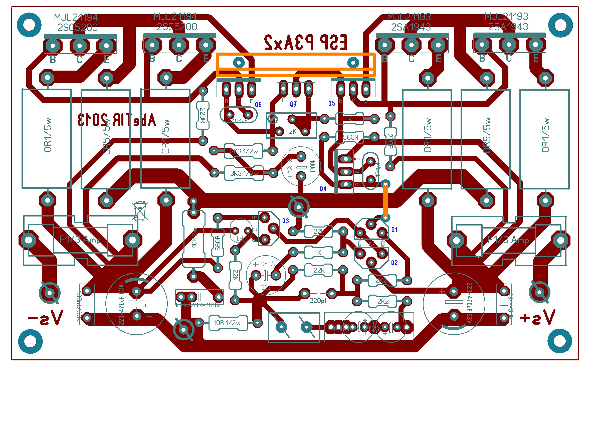

Hi All,
The attached lay-out may not qualify to be called as upgrade but I wonder if anyone of you has successfully built a 2 pairs output P3A. The concept was from another ESP project (attached schematic) All TO-92 transistors are 2SC2240.
I have always thought that the CFP is a poor choice for Class AB output due to the awful switch-off behaviour of the CFP pair. I'm not alone in this regard. Yet this amplifier has a good reputation. Mr. Self found that the distortion of CFP is lower than double EF at high signals but was worse at very low signals. I'd be interested to know whether the CFP is in reality worse, better or equal to double EF ?
CFP amplifiers of this range will play far better than EFP the bad reputation is next to them mostly because people do not know how to make them properly and most of the times look at a CFP schematic but always think inside of them EFP wise ... Since EFP is more common ..That alone is a very bad practice and most of the time and for most people with just a quick look it is impossible to understand the principal of operation for a CFP amplifier .
Consumer wise only an amount of 2-5% of consumer amplifiers was made like that .
As about bigger amplifiers CFP( with many outputs ) made i think that this cannot be done properly with today's available technology /schematics

CFP crossover distortion is indeed less than EF but the crossover region is narrow, which results in low levels of high order distortion extending well beyond audible limits. EF crossover distortion is typically of greater magnitude but lower order because the crossover region is broad, even if the discontinuity is worse.
Subjectively, we prefer low order distortion but the P3A design is way overbiased at 70 mA or more. The result is different to what you may be guessing and by using a sound card or spectrum analyser with low, < 500Hz tones, it is quite interesting to compare the design as specified to when using "optimal", 13 mA bias. That is where the sound quality becomes identifiably CFP.
Randy Slone discussed and illustrated this well in his High Power Amplifier Construction Manual. Others discuss it too but I think his is the simplest and easiest to understand presentation. In a nutshell, don't judge the amplifier simply by it's generic design. SQ is not defined simply by topology or power supply etc. For example, we often percieve bass strength to be greater, not because it is, but there are more upper harmonics above bass frequencies - around 100-200 HZ that give it greater presence and definition. It may be quite a synthetic effect but we tend to like it and you do hear guys ranting about it as a positve in reviews with some music types.

So was the 70mA bias determined through listening tests ? A bias of 13mA sounds awfully low anyhow so I'm not convinced this would be the theoretical bias to compare with. In fact, with OR33 emitter resistors I would have thought 70mA about equivalent to a double EF. What am I missing ?
Hi Gareth
I couldn't say what rode's criterion for the P3's 70mA nominal bias was. High bias certainly was the norm for older commercial CFP designs like Hitachi and Sonys' which people still speak well of for SQ on these usually hot running amps. we are told that the P3 genesis was many years ago too.
According to Self though, the "optimal" CFP bias for a single pair, R(e) = 0R33 is: Iq 8.5 mA and Vq 5.6 mV
"optimal" EF2 bias for a similar pair, Re = 0R33 is: Iq 74 mA and Vq 48 mV
The latter may be more familiar figures but there are fewer junctions to bias with CFP in any case, so Vbias is only half the EF value to start with. All the same, many people here treat bias as arbitrary but an experienced majority seem think 100mA is about right for an EF pair.
13mA is cited by Randy Slone and is about "optimal" for Re=0R22 so to be consistent, I quoted his nominated bias current for the CFP output stage.
The point I was trying to make though, was that if the bias is so far from the textbook level, there's going to be little correlation with the model performance and the SQ won't be what we might expect. It's certainly true of the P3 and similar designs anyway.

For P3A 70mA bias is certainly overbias condition where gm doubling causes distortion to rise, not to fall. Could it be that shifting bias level up (relative to optimal) serves as some kind of subtle tone control, a kind of aural exciter? May be that is the reason why most people prefer overbias to optimal bias?
