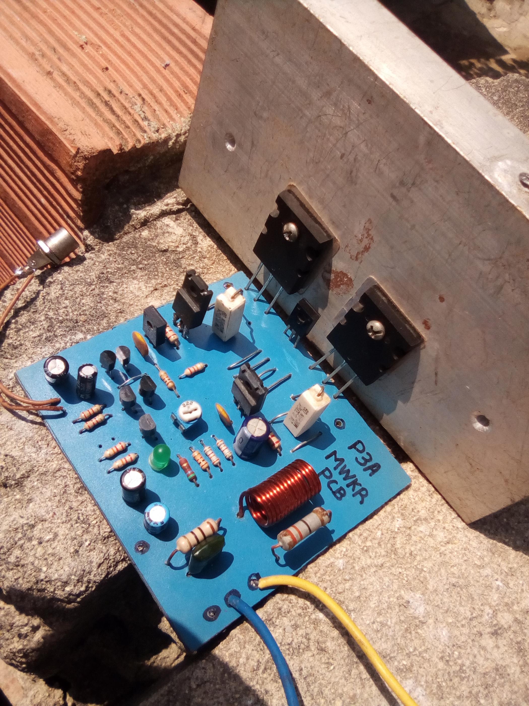

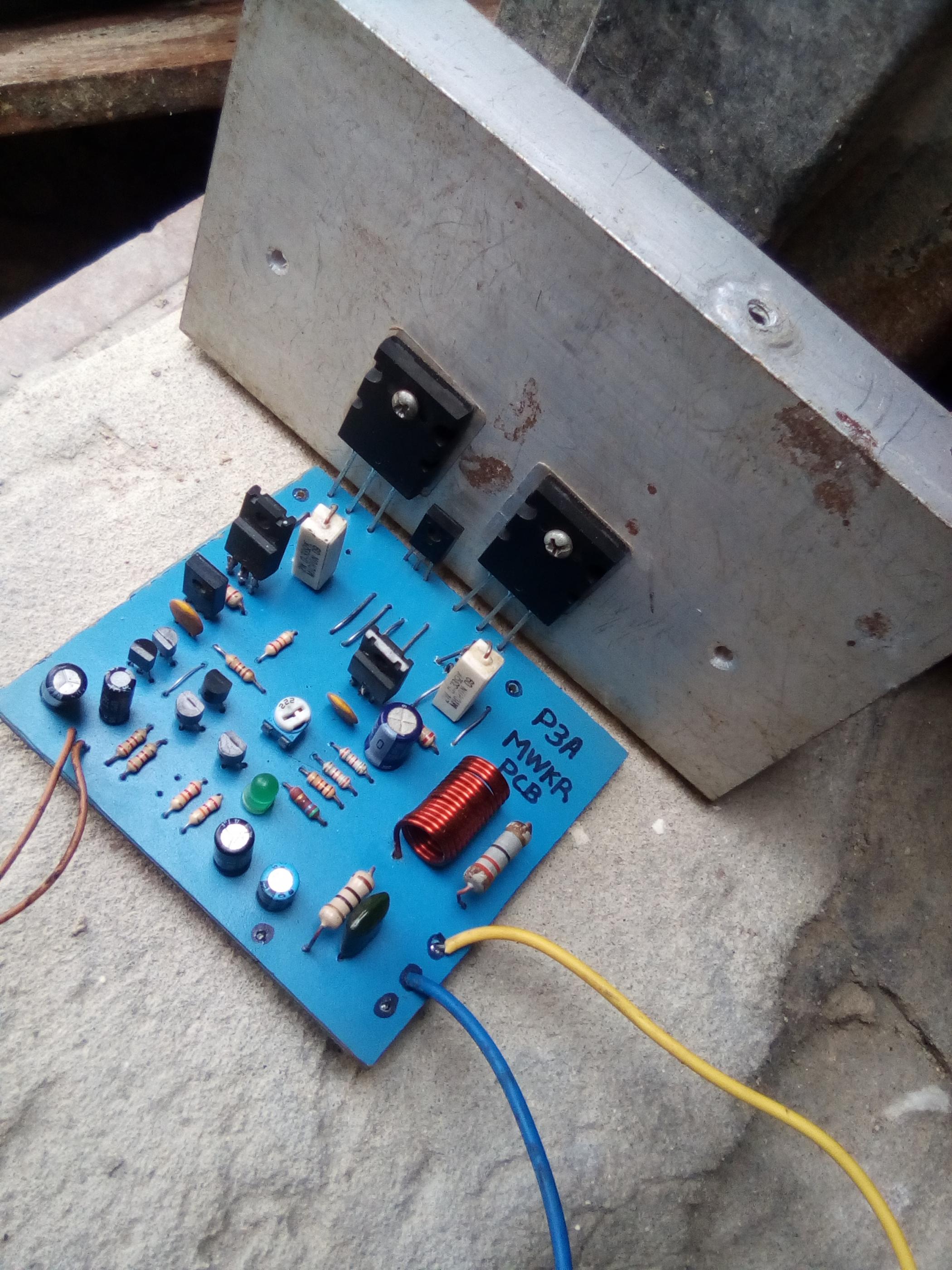

Long time ago I wanted to build this wonderful amplifier. I upload some photos of it..I
thank Stephie B., my friend, for helping me get original transistors for the input stage. Getting some old reciclying parts, at last! I finished the amp which differs from Rod Elliott's only by adding a current mirror to the differential pair collectors. I supplied the amp with +/-40, using C5200 and A1943 in the output stage, I left bias current at 30 mA for each transistor maybe bias is high but temperature through them kept normal. Rod does not recommend the Vbe multiplier is attached to the main heatsink since overcompesation can occur causing crossover distortion due to the complementary feedback pair or Sziklai pair used in the output stage. The sound is very good.
I think the recommended value is 50-70mA? Then 30mA is probably the minimum. If you think you need more current, you have to reduce the driver's collector resistors from the 220 Ohm, and prepare a small heatsink for the driver.

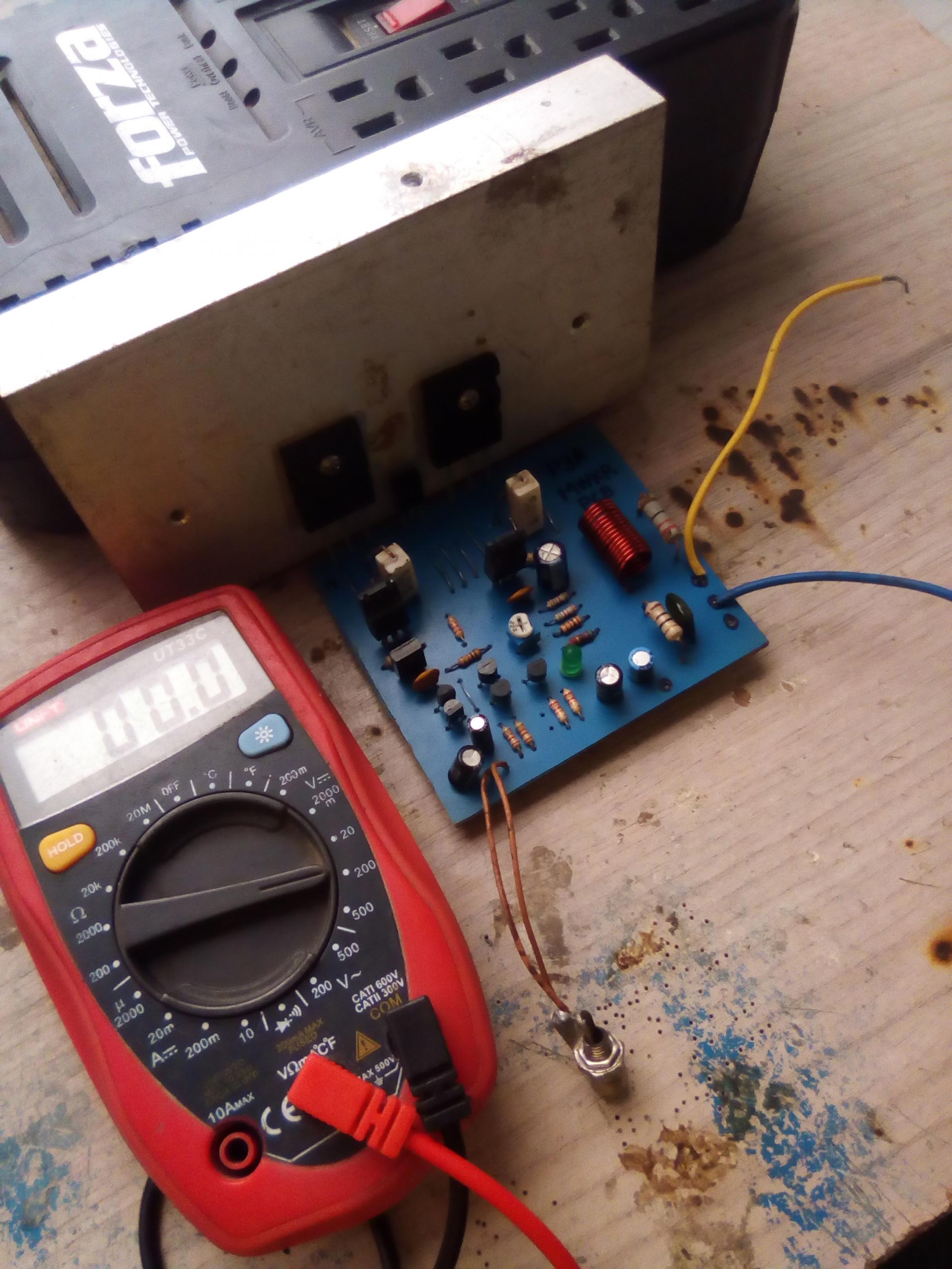

Hi Jacques, but you measure bias current between collectors of both Power transistors?
You can measure bias current in a number of ways.
1. use the amp reading of your PSU if it has one.
2. remove one fuse (see original schematics) and measure intensity across the fuse terminals with a multimeter.
3. Like Johnego suggested: read voltage across one of the output collector resistors and calculate intensity with Ohm's law.
Hi Jacques, I measure the Voltage drop across one of the emitter Power resistors and the result is divided into emitter resistance (Ohm's law).. I just thought 75mA for each transistor was a high bias current. I left mine at 30mA for each output device.

voltage across emiter resistor should be measured with input shorted to gnd, if you want to adjust idle current. so,no input signal,measure voltage across emiter resistor and than use Ohm law.
Like 44250 said, the input must be grounded. The same thing I did, by applying Ohm's law.. I felt the heatsink got very hot when I fixed bias current at 50mA for each transistor.
Something must be wrong. This amp is designed for low bias current. Heat may come from oscillation.
Hi John, you speak about this amplifier is designed for Low bias current.. I think 30mA for each transistor is ok..
Recommended bias (best sound quality) is a current around 70mA. If you read the early pages of the P3a comparison thread, you'll find that Sakis agreed with this too. The optimum, theoretical bias current for lowest THD is about 15mA, like most simple CFP output stages. Unfortunately, that setting isn't the most pleasant to listen to. Even 300 mA has been applied (with larger heatsinks) but higher increases like that don't appear to improve the sound any more.
