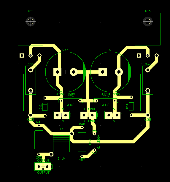

I'M Trying to understand and applying that.
could be that the right way?
I was suggesting something like this. High current traces would be changed to planes.
That on its own brings a dirty ground from speaker return and zobel next to sensitive circuits like the input stages ...
very common mistake ...
0.1uf capacitors will work far better placed on the upper side next to the outputs ... ( the value though is very low )
My earlier post says return speaker grounds to the supply, not the amplifier.
You didn't read my post completely. Very common mistake. How about providing an example. You keep telling us how wonderful you are at it, but never show anything to back it up.

If you think about where signal currents flow and where dc flows and where ripple current flows you will understand the reasoning behind Sakis comments - e.g. speaker gnd return goes to rail cap near output power devices, not back to power supply, only dc through speaker will show up at trafo center tap. Calling every node at nominal zero volts a ground doesn't help make things clear I'm afraid.
As I said earlier, there are many theories on this. Everyone providing a theory is correct in their own mind. I just go with what the general agreement is with most of the people willing to give some actual helpful examples. The three people I listen most closely too are AndrewT, Ostripper and VZaichenko. All three agree that speaker returns should go to the main supply star ground as far as I'm aware.
Ground carries loads of dirty products , produced by the combination of type of load , speaker cable zobel and so on
You don't want this ground close to your LTP many designers use a clean ground through a resistor to provide a cleaner ground to the stages of the amplifier that needed
Farther more that is one of the reasons that you don't want your ground twisted with the rails Obviously at some point of the operation the one will eventually modulate the other and that will create catastrophic feedback
Think out of the box Why designers often use regulated supplies for the first stages often above rail voltage ?
1) because they need the cleanest available
2) due to softer clipping reasons
So yes making sure that all conditions are clean as possible at your input stages is mandatory ...

I know that I have to repeat myself.Andrew you have commented that in the past check you own writing
Members don't bother doing much research for their own project.
Yes Andrew that is very correct ...
Let us not forget what said from a legend of the forum that classic EF2 amplifiers are very forgiving and tolerant to many of the mistakes designer or diyers do

But the examples are so convoluted that I can't follow what you are suggesting is right and wrong.
I am Greek you know .... I already think that the level of my English is at least enough ...
I try to keep things simple
as a conclusion
ground is to be kept as clean is possible
so away from rails triplet
away from any mains problems
I have applied Andrew's advice on grounding and minimisation of high current loop areas on my projects and have observed less noise residual on the scope trace and in practice with my ear to the tweeter. I don't usually bother with ground lifts anymore - they are not required and can even prove detrimental when the layout is optimised.
Sakis, thank you for providing some information that can be used by all. This is much more useful than just telling everyone they are wrong!
I agree, the LTP and the whole input stage require a silent ground. Many, including myself are using a separate ground wire to the input stage from the supply star ground.
In my experience, AndrewT's suggestion of twisting speaker out and return does seem to lower noise emission of the output wiring, but there's always room for more properly explained theories on this. I also achieve very good results with the twisted triplet of power supply to the amplifier itself. How would you suggest to feed them in the quietest way possible?

To explain farther in a few words i have to post my PCB I promised not to do that ...
Think out of the box keep heat sinking out of the picture and design like output transistors do not heat sink ...Then you will solve most of the problems
After that you will need to find out how to cool the outputs ......far easier

As you said, these guidelines apply to all amps. A suggested layout for any output would be helpful. A picture's worth a thousand words. A thousand words is worth nothing if nobody can figure out what you are saying.
- P3A layout
