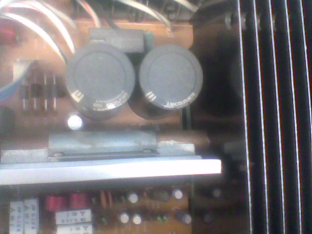

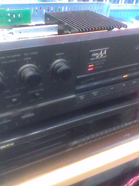

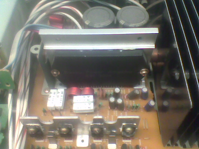

service technics SU-V450
never repaired any of these before ...Very nice amp based on the powerfull SVI 3204 IC which is by far better from older stk cousins
the quality of built inside is actually very high and materials used are the best of quality .Seems also that arengements inside signal routing and cable rooting is done in the besto possible way ..
For sure this is not a high end design but remains a very good production comercial amplifier ... Bandwidth is very fine tone controls are elegant have also defeat switch and source direct control .
with one active source all sound pretty fine there is very clean sound deep with soundstage ... on the negative side i could put the choise of Q and mid frequency of the treble control that works mostly like a presence control than a treble control .... still this is done very gently ...
enjoy some pictures especially the ones that hydraulics meet electronics
(specific amp has copper pipe filed with freon (?) or something else to transfer the heat from the back of the ic to the heatsink ... nice !!
kind regards sakis

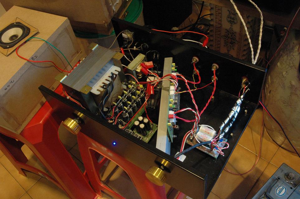

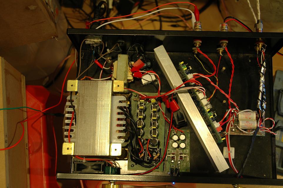

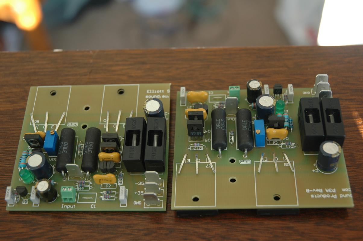

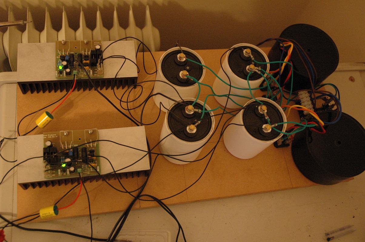

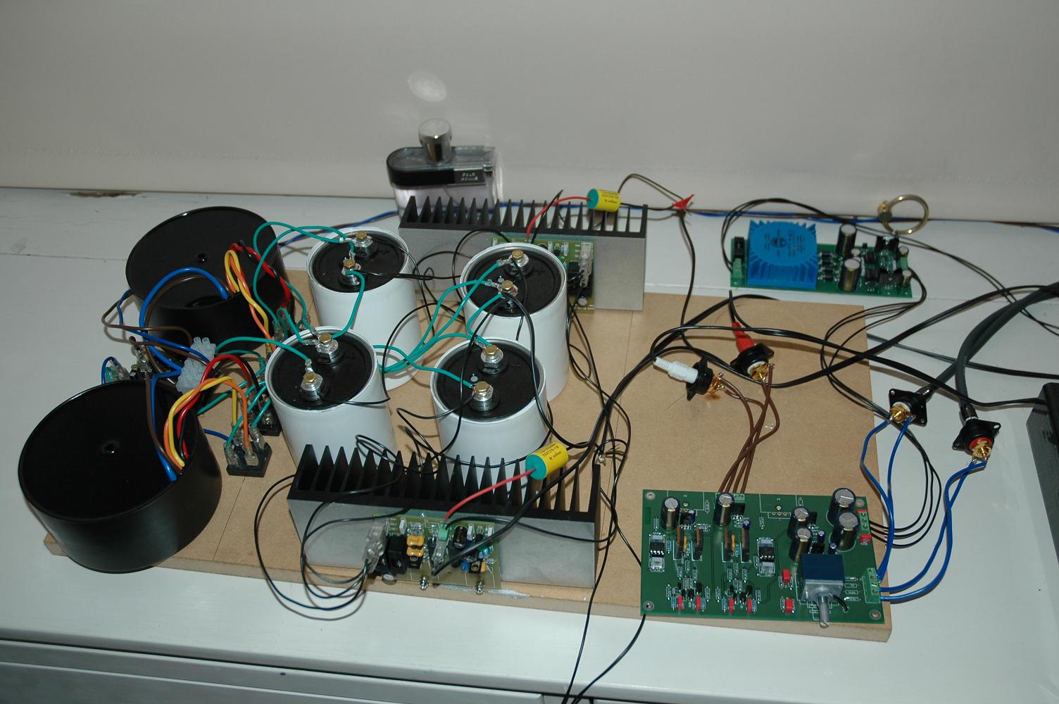

Complete P3A with P37A DoZ preamp
Hi sakis n all,
I have completed Rod Elliot's P3A and P37A preamp build in a single chassis, aka integrated amp. Some features :
11,000 uF per channel formed with 5 X 2,200uF caps. Each cap has a 0.1uF MKT snubber (ultra low impedance PS). 35A 400V bridge rectifier used.
Transformer : 500VA dual secondary 18V - drastically lowering my power =(
Grounding - Power supply ground connected to chassis via single wire. IEC ground pin connected to chassis (surely!)
Vishay 50K log pot
Preamp P37A module : Input cap - 3.3uF Mundorf M-Cap
All carbon film resistors (finally reduced some high freq
agressiveness)
Output cap removed, replaced with wire link
P3A amp module : Input cap - 1uF Wima MKP
Power trans : MJL21193/21194 from Farnell
KOA 1% Metal film resistors (Farnell)
A small 20VA transformer delivers the power to the preamp PS PCB and also powers 2 small CPU fans. One blows on the large trans, the other on heatsink.
Bitumen damping on EI transformer, as well as all the underside of PCB's.
I am in love with this amp. Dead silent, no hiss or whatever.
It trancends above the level of my other amps.
Midrange is ultra transparent, electrostatic like. Bass thunders, dynamics are frightening. Highs are soft, tube like. Best way to describe : lifelike sound.

well ... i am back from the dead ...been away for almost 2 months with various company problems but now this is all in the past ....
ok here it is ... Nice of you for making the P3A but personaly i would a few thngs in an other way ... most of it should be wiring issus and make a construction that is better organized ...your powe supply eventhough could work properly looks terrible and that would also apply to your wiring and shielding of input cables
the pot you selected to use is a terrible you should look for something better that will ensure more linear tracking and most of all equal signal for both ch .
Finaly i dont belive that any of the above will make audible diference except the pot but will make your amp look and work better
other than the above all the rest looks fine .... so happy listening for you ... and i ecpect your comparsion with any other amp soon .

What's wrong with the pot? Those 9mm Vishay's are pretty decent, conductive plastic, and not cheap!
Hi Sakis n guys,
I sort of forgot abt this thread =S
THis is the first amp I ever made and completed!
Regarding the pot, it turned out to be ok, tracking is very good and I have a very stable image centre. No hum/hiss, superb performing amp. This P3A is back in my main listening area as it somehow matches my speakers the best. Bass is full, deep and tight, midrange very clear but a touch thin - that is ok because my 8'' cones sound too warm if valve amps are used. Components are dirt cheap, yet the sound rivals some of the best amps I've heard. Here are the list of amps I own (in no particular order) :

Goldmund mimesis comes to the shop for repair ...strangelly havent been working with those ever again ...
The amp was serviced back home to mama in switzerland just a few days ago (owner has a brother traveling there ) anyway after come back owner happy trys to play with it works for a few minutes and then big boom and bad smell with a bit of smoke comes from it ....
then it comes to my shop where we actually found on of the main caps blown to the moon ( see att fotos ) said to myshelf that this worth looking at .... try to ind out why and how ...
my conclusion was that when goldmund choose to use PHILIPS capacitors ( but Japanese transitors ha ha ha ) that actually have very wierd pin spacing and 4 non compatible pins
that also means that the pcb canot use any other capacitor like a Nippon or anything else since pins do not fit
that also means that when capcitors replaced on service could be as wel from the same batch as from the original order made to create the amps ... hmmm that doesnt work very well since a 6-8 year old but other than that new capacitor is onot the best way to go
on the other hand it may aswell be just a faulty cap ... who knows
i moded the all thing ...i dont like philps parts and also neve rthought that 6800 mfd was enough for this amp so i go for 10.000 nipon with a small mod
all worked fine amp was working perfeclty all right and after some days developed some problem that sounded like a dry soldering which is a coomon problem around the hubrids of this amp .... amp was returned for more checks but since i felt kinda sorry for the costumer that has no amp for such a long time i said to him :

Big trouble !!!! costumer wants to buy the P3A ...trush the goldmund and have a second version to give as a present for his daughter ....keep in mind that the specific costumer is 50 years old ...a very sophisticated listener ...professor of physics with a highly sophisticated ...rest of a system....
enjoy some goldmund explosive fotos

Ultra P3A build
Hi Sakis and gang,
Here is a pic of my dual mono P3A.
I have upgraded almost everything compared to my old build of junk parts.
Some info:
300VA Talema 2X 25V toroidal transformer per channel.
44,000uF filtering per channel using Evox Rifa PEH 169 63V caps.

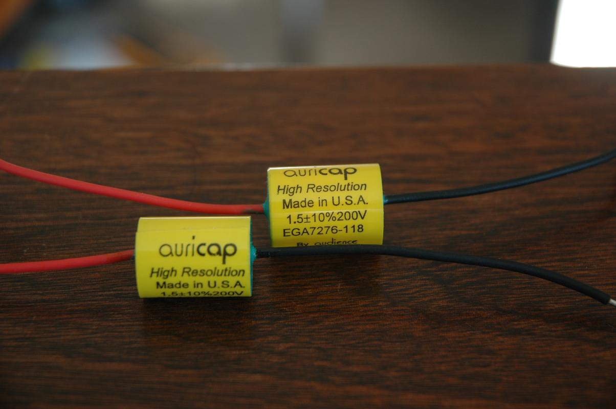

1.5uF Auricap for input.
4X Vishay 35A 400V bridge rectifiers per channel
CDE silver mica 500V caps for all the 100pF cap values
KOA 1/4 miniature 1% metal film resistors
Vishay 3% 0.33R emitter resistors
Matched BD546 / BD139/140 and 2SC5200 / 2SA1943
0.33 Deg C / watt heatsinks per channel
Bias current 50mA. (best treble response)
DC Offset - 11mV and 12.5mV for L and R channels respectively.
[Driven direct via PC as source]
This amp has the sonic profile of my dream amp. It is extremely hard to describe the sound character.
The most incredible deep and controlled bass I have ever heard from a speaker/amp combo.

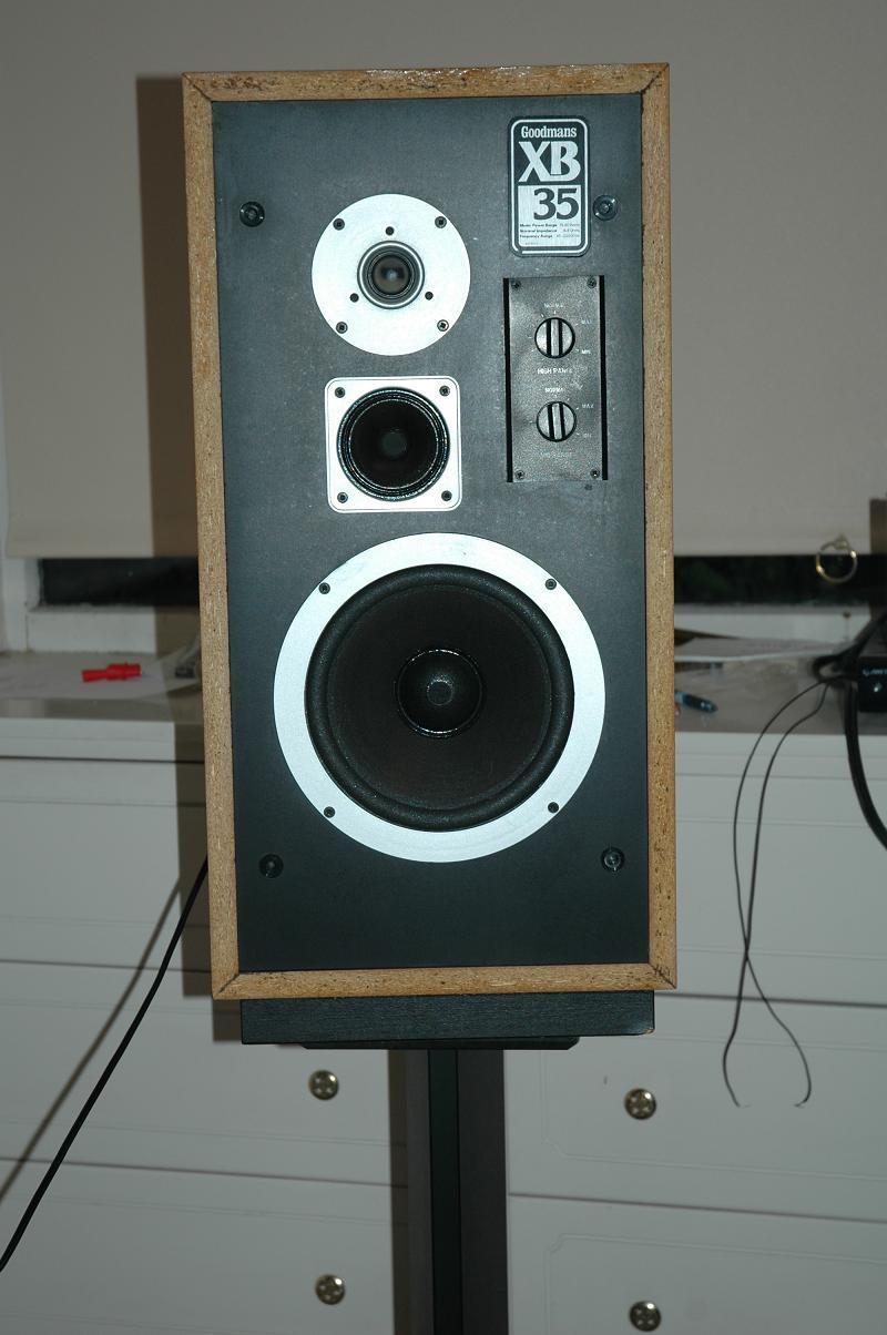

I am using a pair of Vintage Goodmans XB35 speakers and all my mates swore I had left a sub on, hidden in the room.
Separation is phenomenal. Vocal clarity is pristine, pure without "grainyness".
Soundstage is ultra wide with imaging very sharply focused in the centre.
The amp begs to be driven hard and it doesn't break a sweat.
I thought my old P3A sounded extremely good in Malaysia, but here in NZ, it is on a whole new level.
This amp will drive my reference speakers once they are completed.
Sonic bliss at last.....

comment around the bias was very interesting ....
would you like to tell us a few more about it ?
thank you
kind regards sakis
thank you
kind regards sakis

PRE 3 preamp by Pavel
The P3A amp is now being driven by Pavel's PRE3 preamplifier. I was dumbfounded as there was no sonic change when the preamp was introduced.
Did A/B testing for a couple of hours on mono tracks with level matched volumes but there was no difference. Bias is now set at 60mA - heatsinks are still cold to the touch. Ambient temp here is about 21 Deg.
I can only come to the conclusion that the preamp acted like a wire with gain (10X), capturing the essence of the P3A as purely as possible. To be honest, I wanted the preamp to add it's own flavour to the music...oh well =) This is the first preamp that I've built that didn't have any sound of it's own.
A pic of the messy setup. Amazingly there is not the slightest whisper of hiss from the 90dB tweeters.
