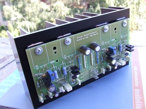

My P3A module
This is my P3A "module" using original ESP pcbs on Fischer SK53 100SA heatsink. All elcos are Panasonic FC, all resistors are metal film and metal oxide (0R33 are 2W metal oxide too). VAS and drivers are 2SD669A/2SB649A (made by Unisonic of Taiwan). Output transistors are Toshiba 2SC5200/2SA1943. There is no fuse holders because this amp is not intended for heavy duties.

My P3A sounds very good indeed! I have three original ESP pcbs and this is the first that I assembled for initial testing. There was no matching of any transistors (not even LTP transistors) because I wanted to hear how the amp sounds in it's worst form. I used MrEvil's cap multiplier PSU and all interconnects and loudspeaker cables are worst there is: loudspeaker cables are 2x0,75mm2 lamp cable and interconnects are the crap cables that you get with mass produced gear. Preamp I used for initial testing was an old opamp based preamp without tone controls using NE5534. My P3A was biased at only 30mA per output pair. For tests I used Ron Carter's "Stardust" CD played on my Marantz CD57MK2.
Contrary to what some people think about this circuit (based only on looking at the schematics) this is exceptionally good sounding amp. I recently had a chance to hear NAIM NAIT XS and I must admit that I like P3A much more. I always liked the sound of quasi complementary output stages more than EF, but Sziklai is much better than both. There is no doubt that in the future I shall focus on Sziklai output stages.

Yes, I was too enthusiastic and very much pleased with the results obtained with the parts at hand. Thanks for the useful comments. I shall have to rethink my intention to use super parts for P3A. (I hate to desolder parts that are not working as they should.) I have some Sanyo 2SA1538 which I wanted to use at VAS position even for this first build. But now I am not sure that 400 MHz VAS transisitor is a good idea. The amp sounds so good with 2SB649A for VAS that I am unwilling to experiment in the wrong direction.

With absolutely no matching of any of the transistors offset is 10mV for one channel and 25mV for the other and stable from first power up. I consider this very good results for amp with unmatched transistors. The sound is very clear even at high power. I am using professional studio monitor loudspeakers which can handle high spl without compression and distortion. Therefore, my conclusion is that, for 60W/8Ohm amp, loudspeakers will be the most limiting factor. In home environment loudspeakers will start to distort seriously much before P3A starts to clip. Most HiFi loudspeakers do not have voice coils of sufficient diameter and thermal rating and I am afraid that fact will influence subjective evaluation of this excellent simple design. For proper evaluation of this design one should try high quality/high power/high efficiency loudspeakers. Something like high quality PA loudspeakers or HiFi speakers with enormous power capacity - speakers with big voice coils like used in ScanSpeak or Dynaudio drivers.
