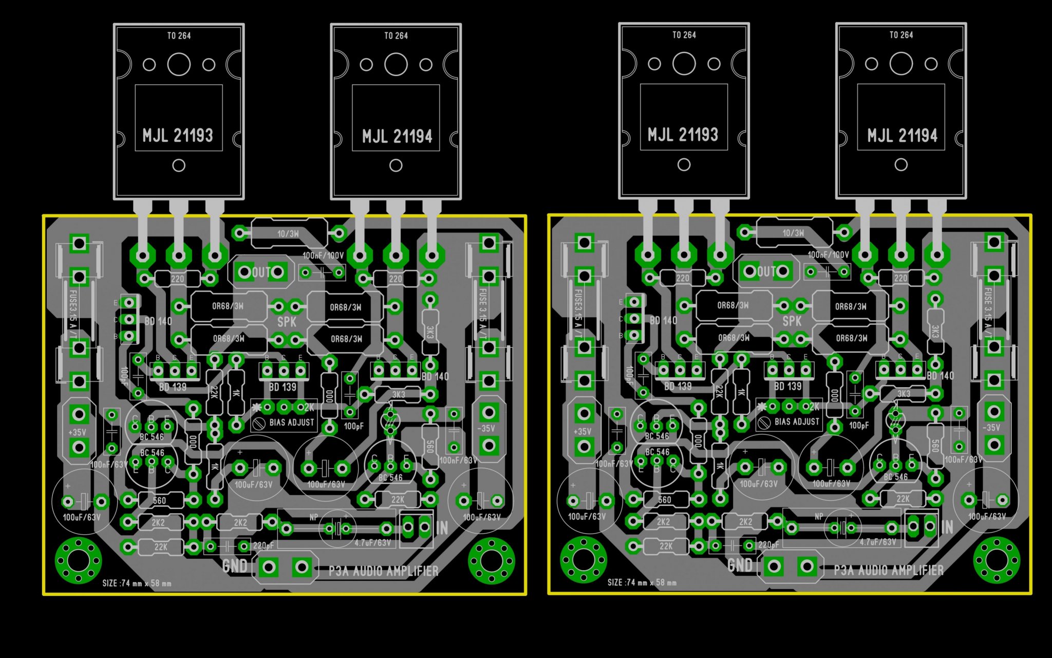

Definitely - take a look at the pics of Rod's latest version of P3A. Do you see the cable tie clamping Q6 against Q9? Most power amplifiers are actually EF (emitter follower) or QC (quasi complementary) designs which are almost always stabilised with thermal feedback from the main heatsink or directly from one of the output transistor cases. However, P3 and its versions have a different type of design that is often called a "complementary feedback pair" (CFP). Here, the driver transistors have a much better thermal characteristic to control the output stage bias current, so now the driver dissipation is the control element, not the dissipation of the output transistors.

There's no harm posting schematic since it is public on Rod's site, however this PCB design is wrong or atleast not well optimized... as others already stated, you need to use insulators between outputs and heatsink... also Q5, 6, and 9 should be away from 'main' heatsink (ideally on separate small sink) or atleast Q6/9 in firm thermal contact...

Since you now say the output stage only fails when you apply full power, it would seem less likely that bias regulation is the problem. However, that PCB layout is plainly wrong! It shows Q9 located next to the the heatsink panel, as P3A used to be, some years ago. This tells us that Sigma Labs (apparently the designer/supplier) didn't understand or at least test their product properly at ~20% higher than specified voltages, as you are using. The trick of locating Q9 near but not on the heatsink is an old one that seldom works properly for CFP designs anyway.
+/- 42V supply rails are also 20% higher than the recommended maximum of +/-35V (read the warning). I have also used the higher 42 voltages for P3A but it also failed on several occasions, so don't you think there's a reason for limiting the maximum recommended voltages? My latest problem incidentally, was fake power transistors from an Aliexpress store. 'nothing unusual about that by the way - some fakes don't matter much but fake power transistors really do and they are the most expensive.

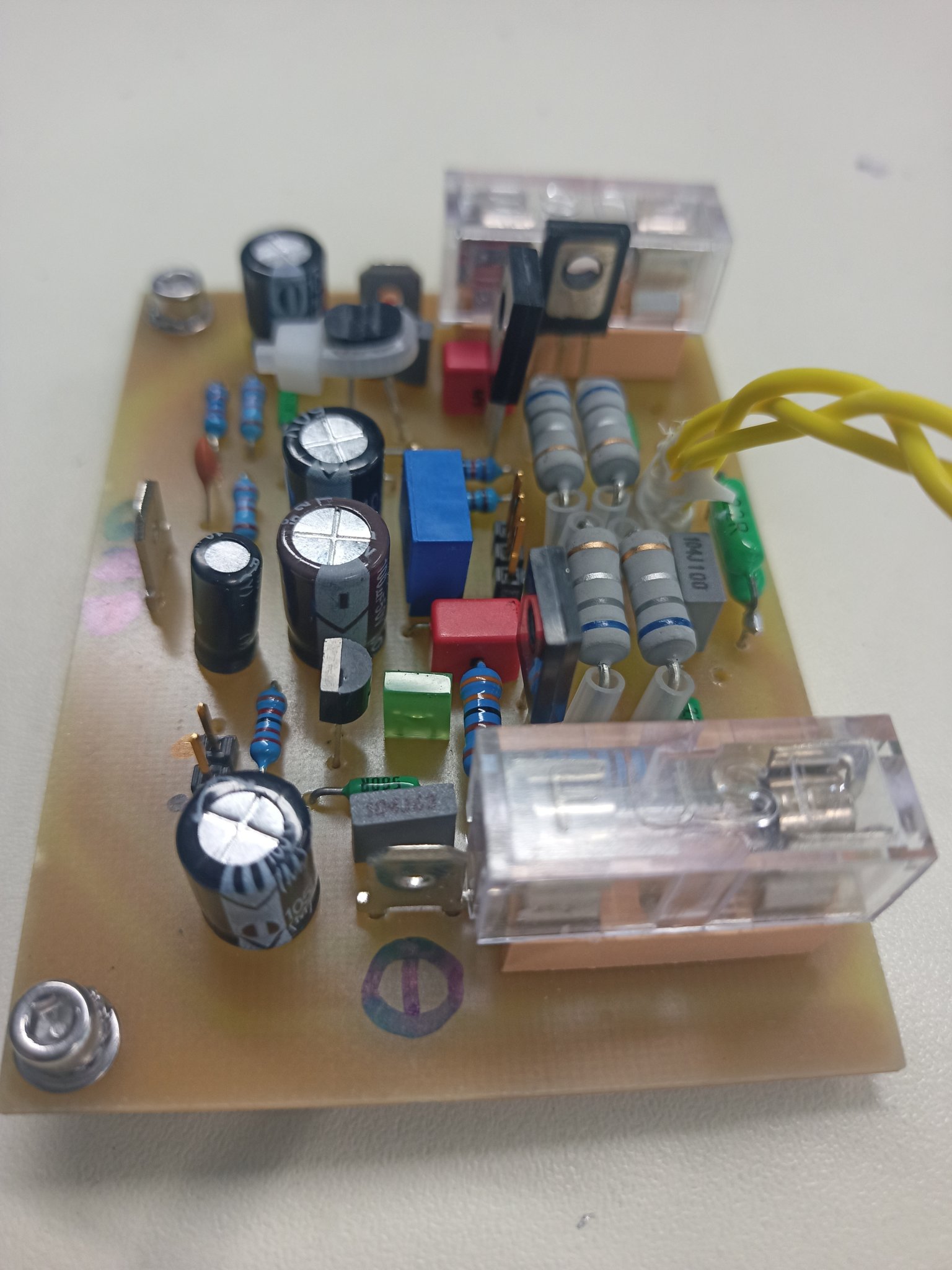

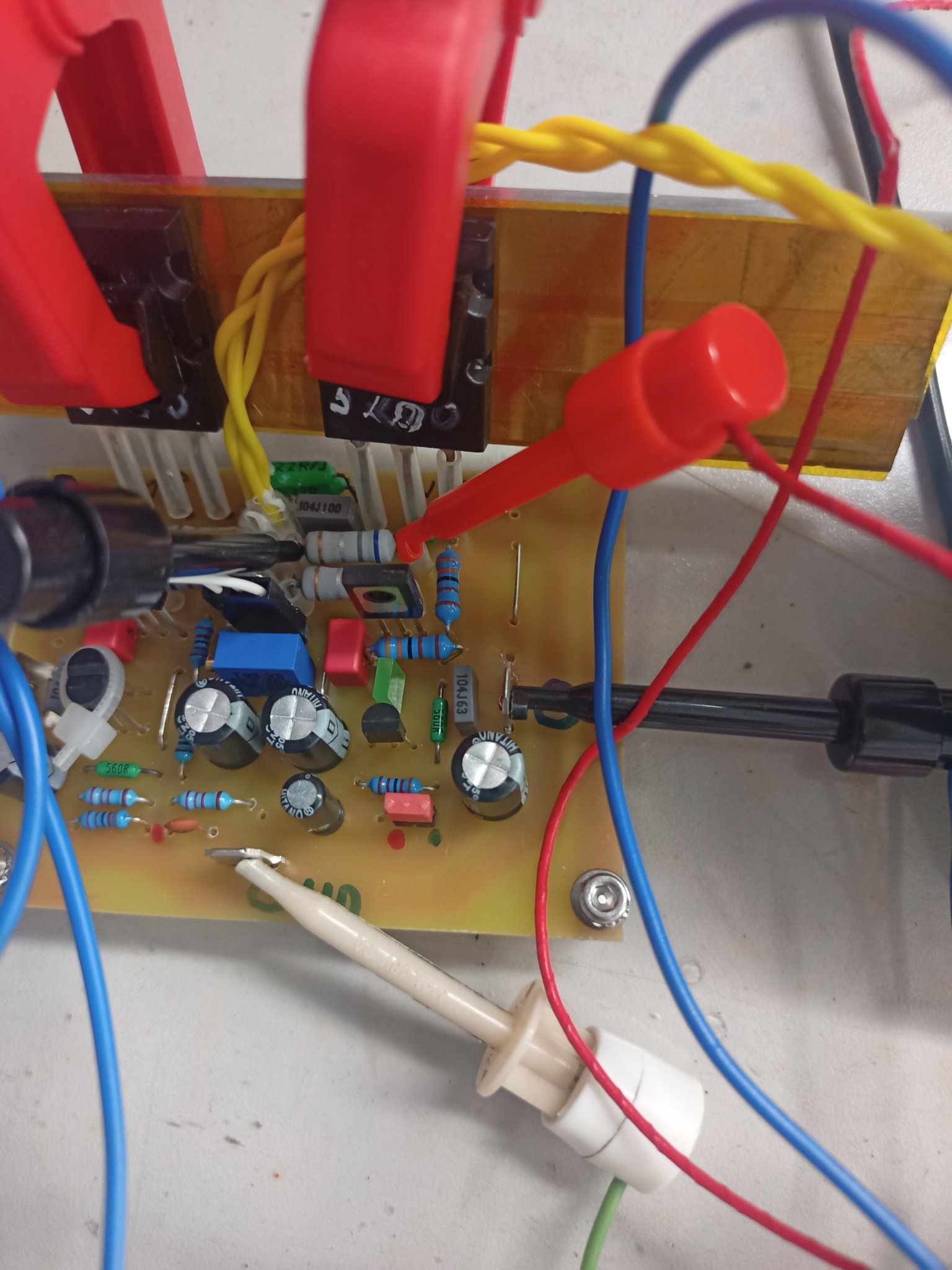

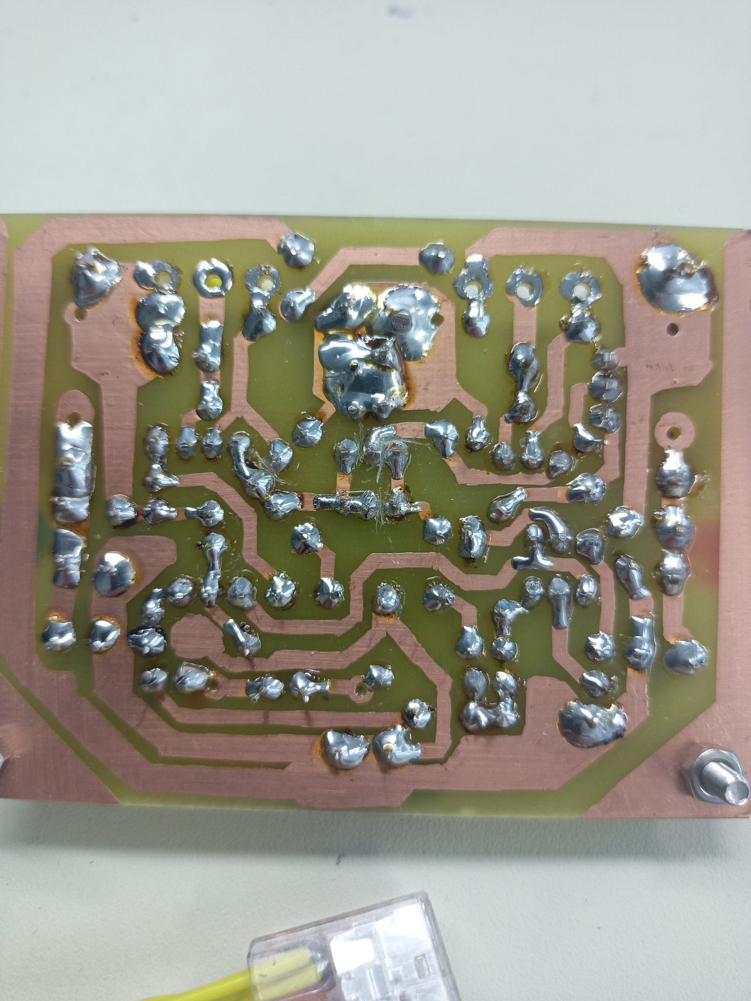

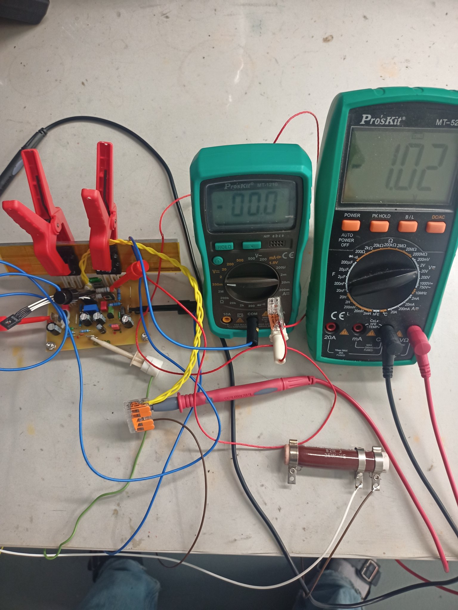

Dobrý den, prosím o radu a pomoc. Postavil jsem P3A a nemohu jej správně animovat. Fotky posílám v příloze. Zátěž je asi 10 ohmů. Když odpojím zátěž, LED se rozsvítí, ale DC offset stoupne téměř na záporné napájecí napětí. When I connect the load the led lights up and the DC offset drops to -1.02 Volts, I supply 20-0-20 DCVolts. Thank you for your help.
Ohh, sorry. Hello, I am asking for advice and help. I built a P3A and can't animate it properly. I am sending the photos in the attachment. The load is about 10 ohms. When I disconnect the load, the LED lights up, but the DC offset rises to almost negative supply voltage. When I connect the load, the LED lights up and the DC offset drops to -1.02V, I'm supplying 20-0-20 DCVolts. Thank you for your help.
More pictures 2.
I use a 2SA1943 and
2SC5200.
