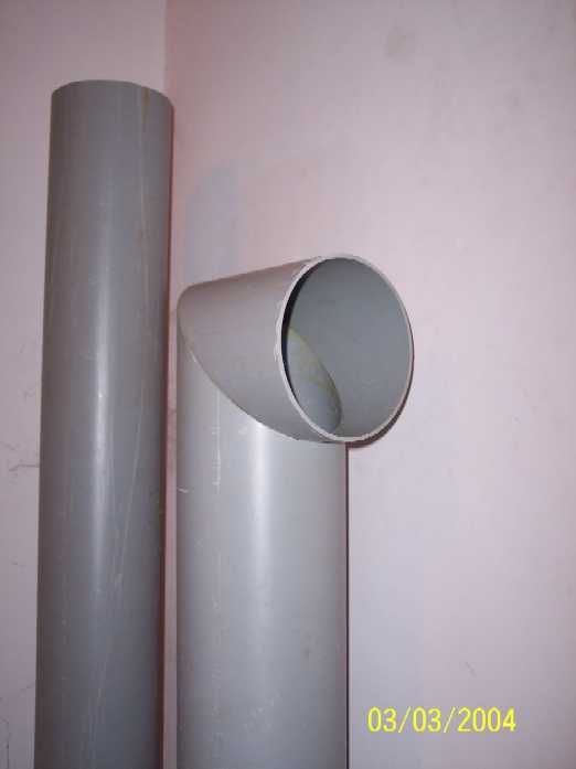

The circular section and the uniform path delays will make edge diffraction peaks more prominent. Will need to find a way of getting around the problem. To add to this i fear the kind of resonance the uniform cynlindrical pipe will produce. (will it behave as a ML-QWT. If that happens i'll be getting a series of resonant peaks which will need to be damped. If the resonances are prominent it will start at around 80-85hz...

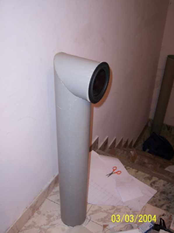

Btw, i've developed all the surfaces required to cut the PVC.
6" at an angle of 45d for the woofer mount and another for a 4"cylinder that intersects the 6"PVC with their axis perpendicular... brushing up my engineering drawing skills...

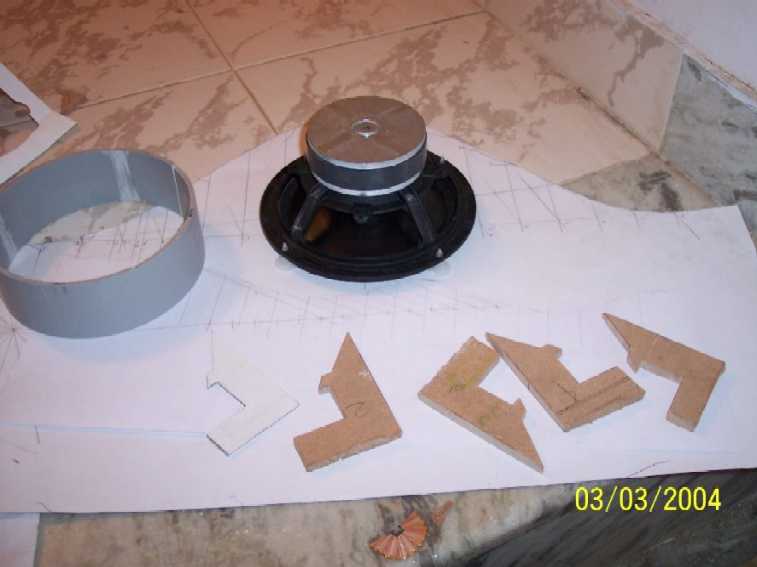

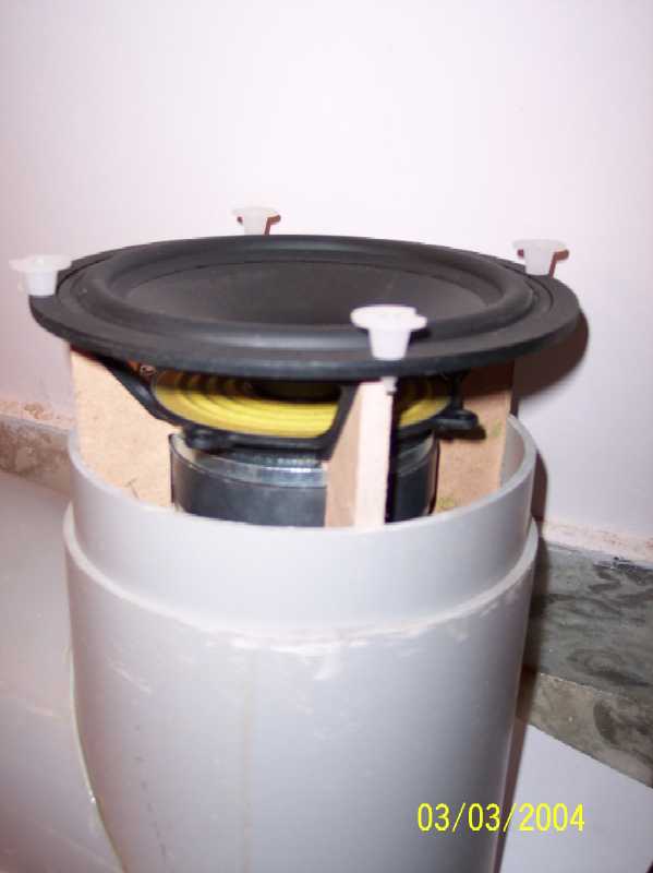

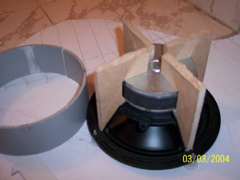

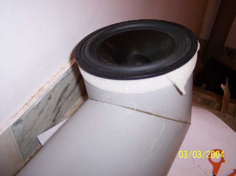

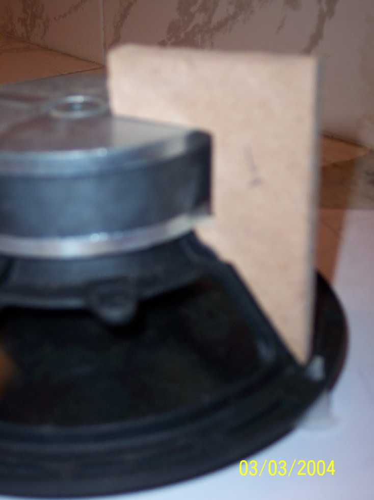

So, i've finally managed to cut and glue the PVC to form the main unit...but there was another problem...the PVC ID and the VIFA's dont match...to worsen the situation, the P17 mounting holes come exactly on the PVC, so cant fasten them with screws...so
had to figure out a way of mounting them...Looks neat...still to find out how well the coupling is and are there any air leaks at the joints....
Pictures of first unit coming up tomorrow...
ajju
ajju

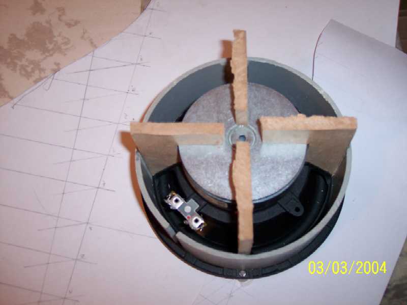

The woofer completely mount on the PVC...
the woofer is held by pressure through the inner gasket, and the clamps.
A piece of foam acts as a seal at the edge where the PVC meets the woofer frame..!!
Comments are welcome from all structural experts..(well infact everyone...) on the strong and weak points of mounting the woofer this way...!

Ajju,
Super job. How are you going to load the pillars at the bottom ?
