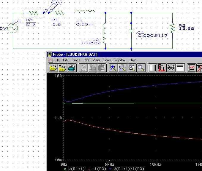

Svante:
With the parameters obtained i tried to model the Equivalent circuit...
these are the results i got...
looks rather strange...
the blue line is the estimated impedence....
is this expected or is something wrong...?
The circuit and the component values seem OK. It also looks as if the thinking behind the curves is right, you measure the current across the circuit and divide it with the current flowing into it. But the curves look strange. One reason is that you have a linear scale on the frequency axis, so the range 10-100Hz where the interesting resonance occur is *very* compressed. But that is not the whole story, the impedance should never be below 5.8 ohms, and it should peak at 5.8+18.8 ohm at 37 Hz. Towards higher frequencies it should increase indefinitely due to Le.
I don't know your simulation software, so I can't help you with that.
HTH

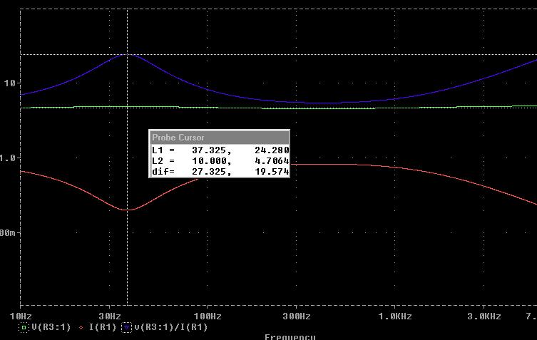

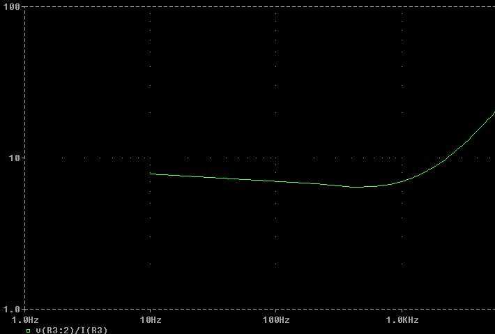

Svante,
heres is a zoomed graph...both axes in log scale...
Still i dont find that characteristic peak...Is it possible that the Q is bad and the peak has flattned out...?...some parameters miscalculated...
I get a doubt...
we have ignored the Bl^2/rml component...and that comes in parallel to the bl^2/Rms resistive component...
Could that be the culprit..Oh but that would still decrease the parallel resistance...
Ok i'll alter the resistances and see if i can get the peak...
and where is it located...!
Lower the series resistance and increase the parallel one...
just an experiment..!
ajju
