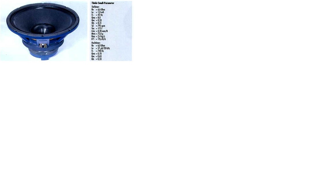

Thought I'd chime in here as I've just picked up a pair of these big blue buggers and feeling a bit unsure how to proceed. lol
Interestingly the p.audio published spec sheet parameters that I managed to track down are a bit different to that on the USSpeaker site. Namely the Fs of the woofer is higher at 42Hz and the QTS higher at 0.31 (as noted by John Busch above). Am I allowed to attach the full spec sheet here?
I'd not sure if I could possibly get away with cabinets the size of those big TLs so maybe my future involves subs too! 😆
