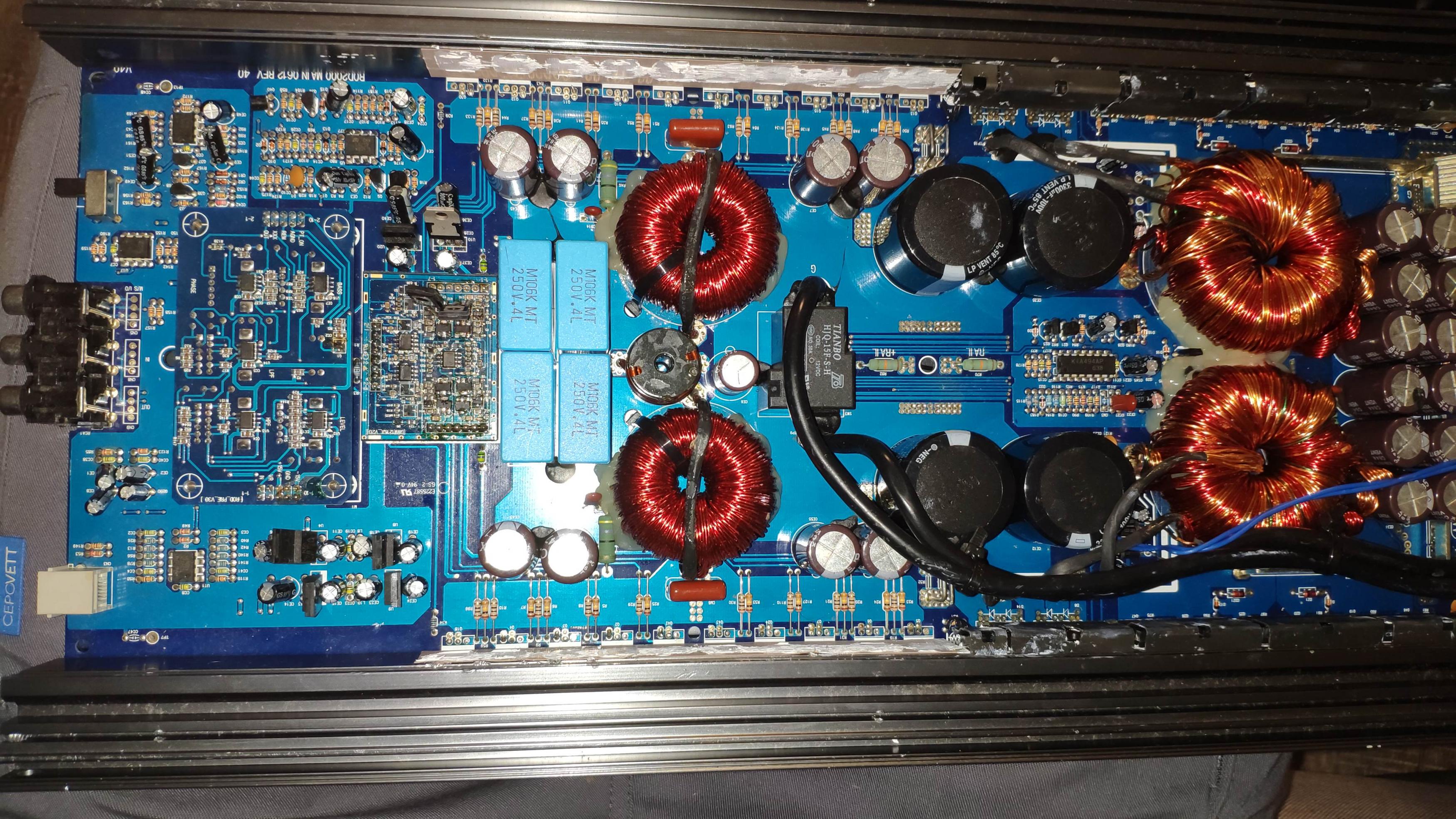

I have a problem with my Oxygen Audio AirPro M2.5K amplifier.
When I turn it on, the green indicator lights up then the protection indicator lights up and its without the power MOSFETS.
I did some tests = a 7812 HS regulator and at the driver board level I had HS transistors such as Q5 Q9 Q12 Q6
Do you have any ideas of what to try out?
Q5 is DK mark QF is it 2SC4672?
What about Q9 2SA1797?
Where can i find them or any substitutions?
Thanks a lot and sorry for the language it's google translate.
Hello
Here some pics or my amplifier.
I had test some transistor ans i found Q5 ans q6 was in shortcut. I've change them with bd139 ans bd140 juste for test but same results : i have 89v at gate or the power MOSFET. The amplifier come in protection a few minutes after power on.
On the power supply i see that the amplifier use 1amper and no more when he IS on protection.

Please read the following section on taking photos.
bcae1.com - Car Amplifier Repair Tutorial - The Basics
While powering up, monitor the DC voltage on the output filter inductors Do you ever see any DC voltage there?
Do you have a scope?
Please (and this applies to anyone who needs repair help) use your sig line to list all equipment you have, editing it as equipment changes. Include the model numbers.

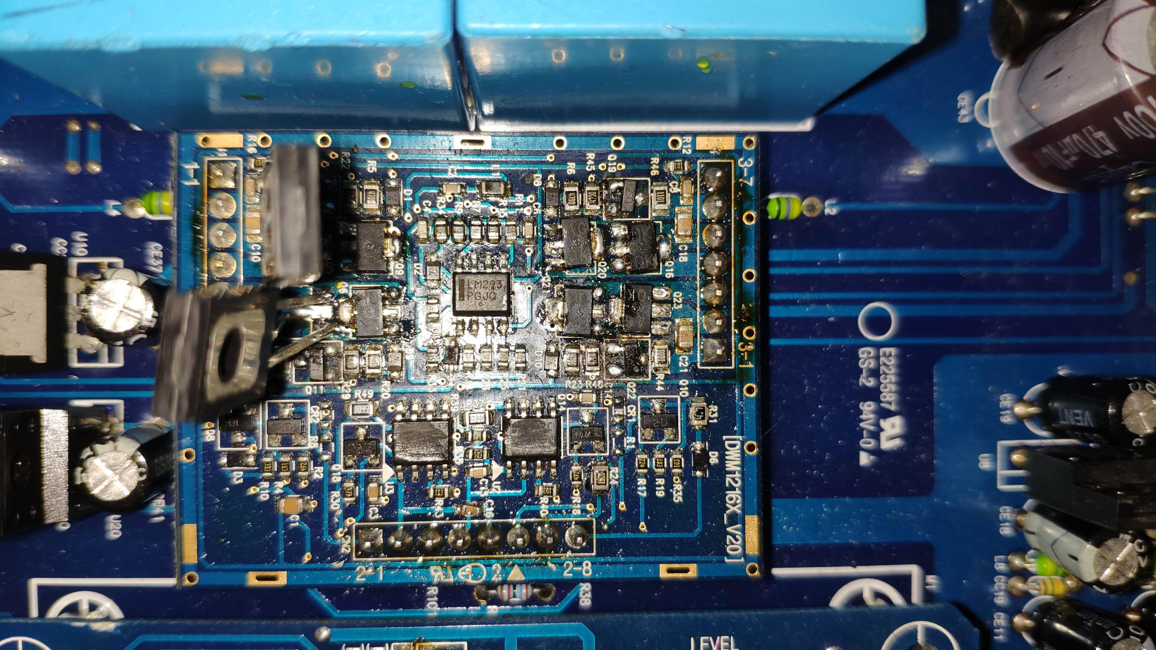

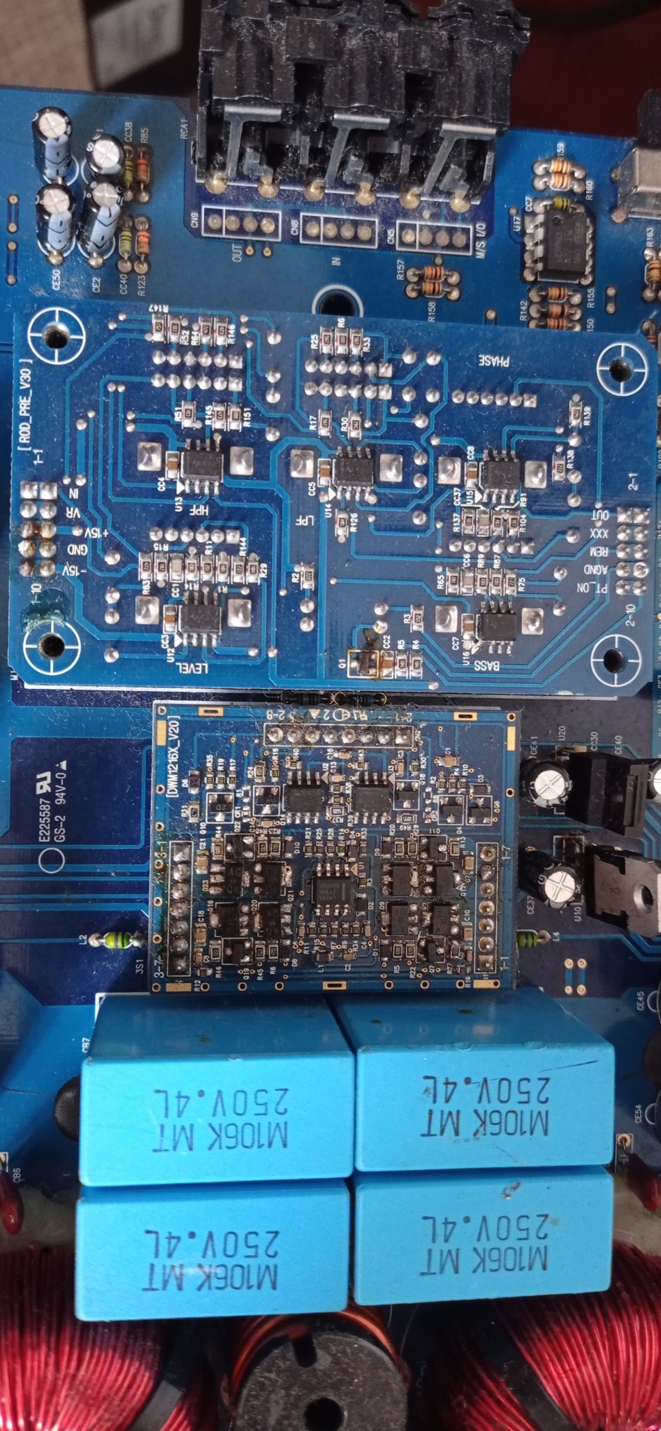

I took several measure and here is the result:

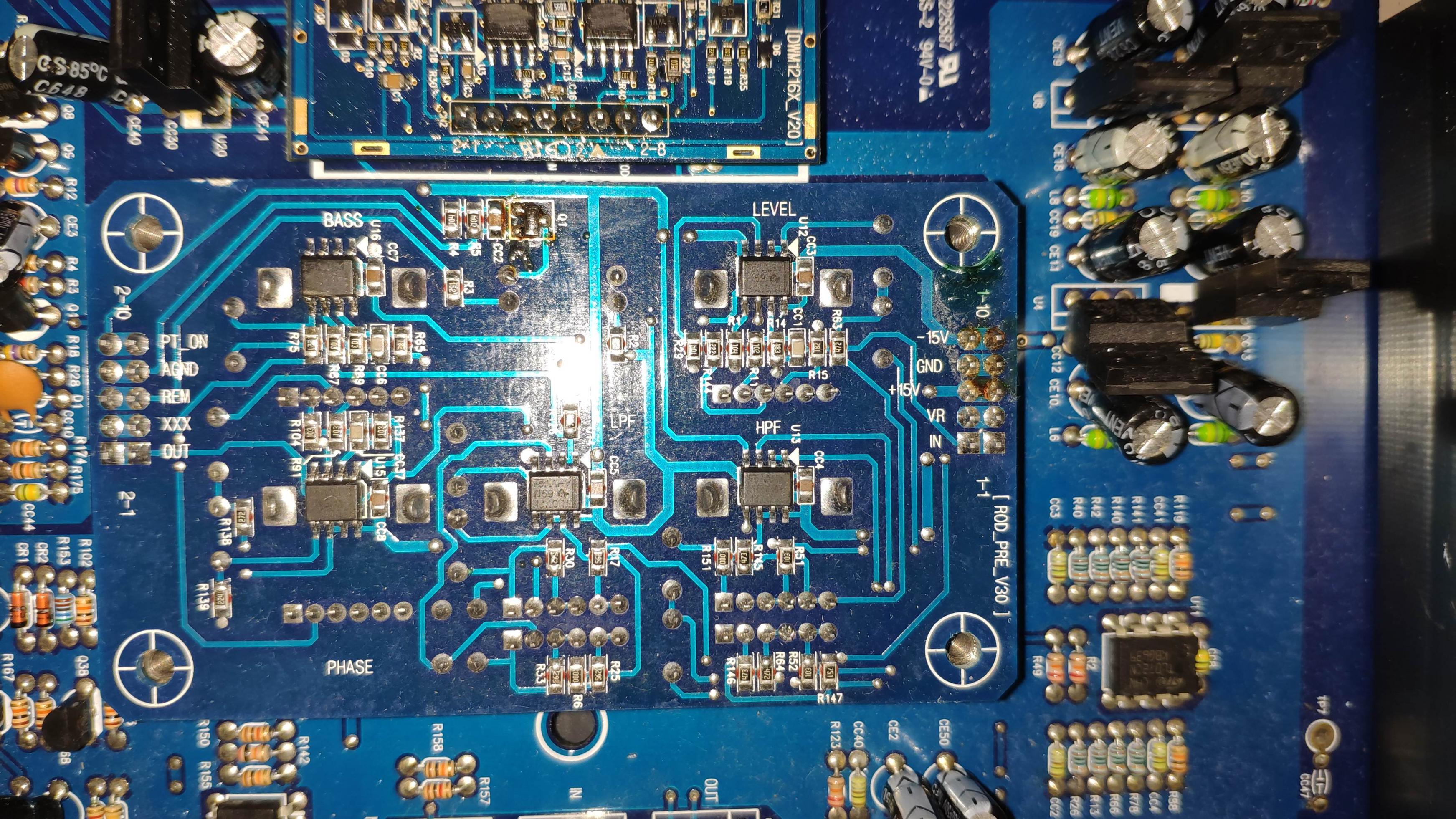

Pre-amp card:
OUT= 0v -15V= -14,8v
XXX= 0v GND= 00,1V
REM= 11,9v +15V= +15,2V
AGND= 0v VR= 00,1V
PT_ON= 00,1v IN= 00,1V
DMW1216X_V20 CARD:
1-1= -72,3V
1-2= -72,3V
1-3= -60,6V
1-4= -72,2V
1-5= 72,5V
1-6= 61,1V
1-7= 72,7V
2-1= -14,8V
2-2= -4,6V
2-3= 00,1V
2-4= 00,1V
2-5= 5,1V
2-6= 15,2V
2-7=0V
2-8= 0V
3-1= 72,7V
3-2= 61,1V
3-3= 72,5V
3-4= -72,2V
3-5= -60,3V
3-6= -72,4V
3-7= -72,3V
Without output transistor here is the voltage for Q45,33,15,14,33,43,24,7,6 and 5:
G= -73,4V
D= 0,01V
S= -73,4V
for Q44,10,11,12,30,42,2,3,4 and 18:
G=72,5V
D=0,01V
S=72,4V
All measure was doing with the black probe to the ground off the power supply
I think i have a problem with the ground of the 7812 and 7912 regulator.
Have you some ideas of the cause of the problem?
Thank you for your help
