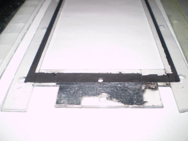

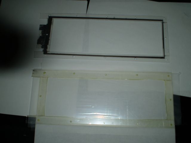

I tried the pva glue,water and grapite idea and it seems to work good. jer
