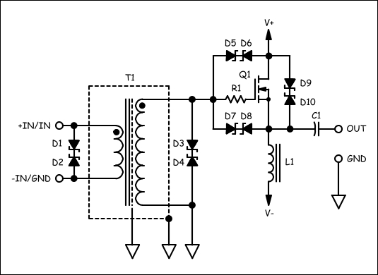

No, Fred. The only secondary inductance seen by the source is the secondary leakage inductance, which is a series inductance, not a parallel inductance.
And the source will see that leakage inductance as 1 over the square of the turns ratio. So for a 1:5 step up, the secondary leakage inductance seen by the source will be 1/25th the leakage inductance, not 25 times the leakage inductance.
Do you recall your reminding me that reducing the impedance of a capacitor is the same as increasing the capacitance? Well it works just the opposite for inductance. Reducing the impedance of an inductor is the same as reducing the inductance.
So what the source sees is the shunt primary inductance and the series secondary leakage inductance with the secondary leakage inductance having been reduced by a factor of 25. Not multiplied by a factor of 25.
Sure. But that doesn't change the fact that transformers such as the 13K7-A are very effective RF filters.
And again, your original concern was over signal transients causing overshoot due to the resonance of the high secondary inductance (which apparently you still don't quite understand) and the input capacitance of the MOSFET.
I think I've shown sufficiently that given the small Q resonance of the 13K7-A coupled with the fact that in a source follower your gate-to-source voltage isn't going to be your input voltage, this is never likely to be any sort of a problem.
Again, I'm not saying clamping diodes are a bad idea. I just don't see that the lack of clamping diodes is any reason to go
and go beating people over the head about it like some self-righteous thug. Particularly when you single out just one person to beat over the head while wholly ignoring those who have done the exact same thing.

Steve, you might want to put a diode from V+ to ground (reverse biased, of course!) as protection. Same with V-.
fdegrove said:Good idea if it weren't that the CVTs I know don't have much gain to start with.
S&B had one that you could wire up as 1:1 or 1:2. But I think they stopped making it.
Since preamps typically have about 20dB of voltage gain, and since Fuling only wanted 5-6 watts to begin with, a simple follower would do.
P.S. Steve, there are some more places where you could tack on some diodes.![]()
I know, but I ran out. So I decided to just cover the most important parts. Should have some more in early next week.
se
SY said:Steve, you might want to put a diode from V+ to ground (reverse biased, of course!) as protection. Same with V-.
I know, I know. But like I was telling Frank, I'm all out at the moment. Tune in next week. 🙂
se
